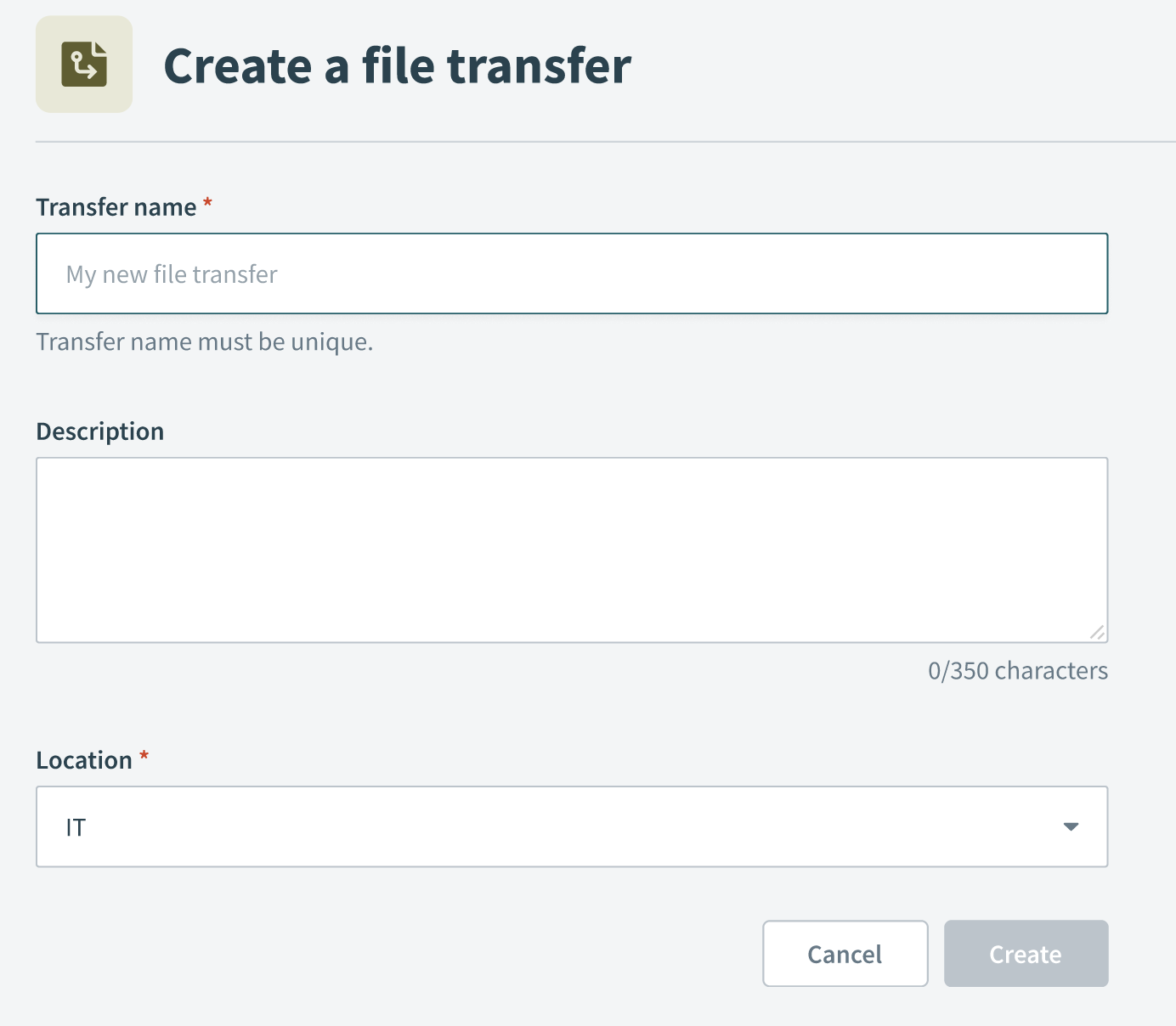

Click Create > File transfer. The Create a file transfer modal displays.
The Create a file transfer modalThe Create a file transfer modal
Enter a descriptive Transfer name. For example: Partner Orders Import or Daily Report to S3. Names must be unique within a project.
Optional. Enter a Description of what the transfer does. This field has a maximum of 350 characters.
Use the Location drop-down menu to select the project where you plan to store the file transfer.
Click Start building. The file transfer is created in an Inactive state and the Transfer page displays.
Refer to Add a source and Add a target to complete the remaining set up steps.

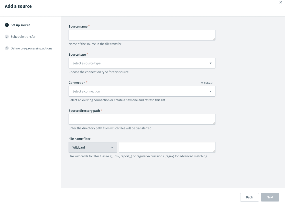

Add a source ​
Sources define where to pick up files, when to check for new files, and how to handle source files after a successful transfer.
Complete the following steps to add a source to your file transfer:
Select the File transfer asset you plan to configure.
Click + Add source. The Add source setup wizard displays.
The Add source setup wizardThe Add source setup wizard
Enter a descriptive name in the Source name field. For example: Partner SFTP or Bank Reports. This name appears in logs and monitoring.
Use the Source type drop-down menu to select a connection type. Workato supports the following connections:
Workato plans to support the following additional connections:
  • Amazon S3
  • Azure Blob Storage
  • Sharepoint
  • HTTPS
Connections are reusable across all flow assets including file transfers. Use the Connection drop-down menu to select a connection if your Source type is External SFTP. You can also click Create new connection, then click Refresh to update the list.
Enter the folder path to retrieve files from in the Source directory path field. Ensure the source connection has permission to download from this path.
Use the Only transfer files with a successful virus scan toggle to set the transfer's security scan behavior if your Source type is FileStorage. FileStorage automatically scans files up to 100 MB.
Enter a pattern to filter files by in the File name filter field. Use the drop-down menu to select a pattern type. Select Wildcard for simple patterns or Regex for advanced matching.

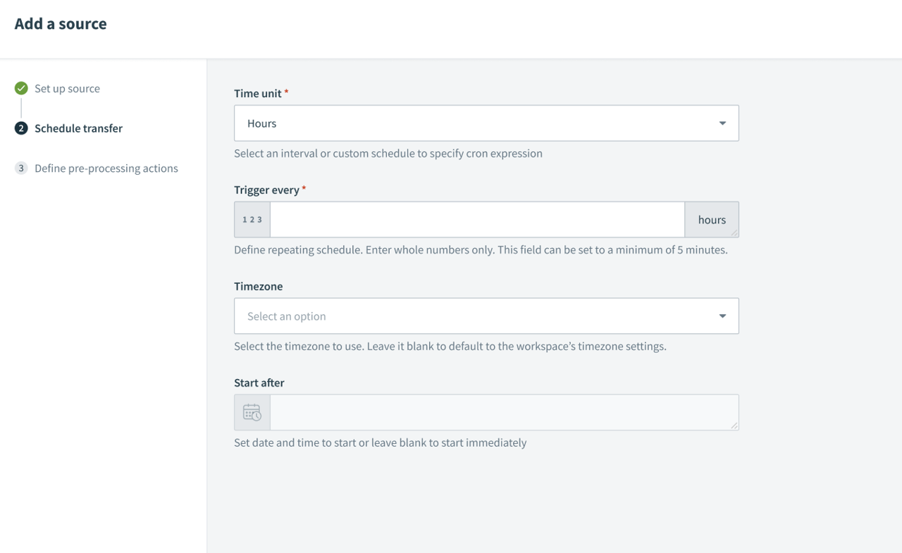

Click Next, then refer to the Schedule transfers section to configure the transfer schedule.
Schedule transfers ​
Complete the following steps to schedule file transfers after you add a source:

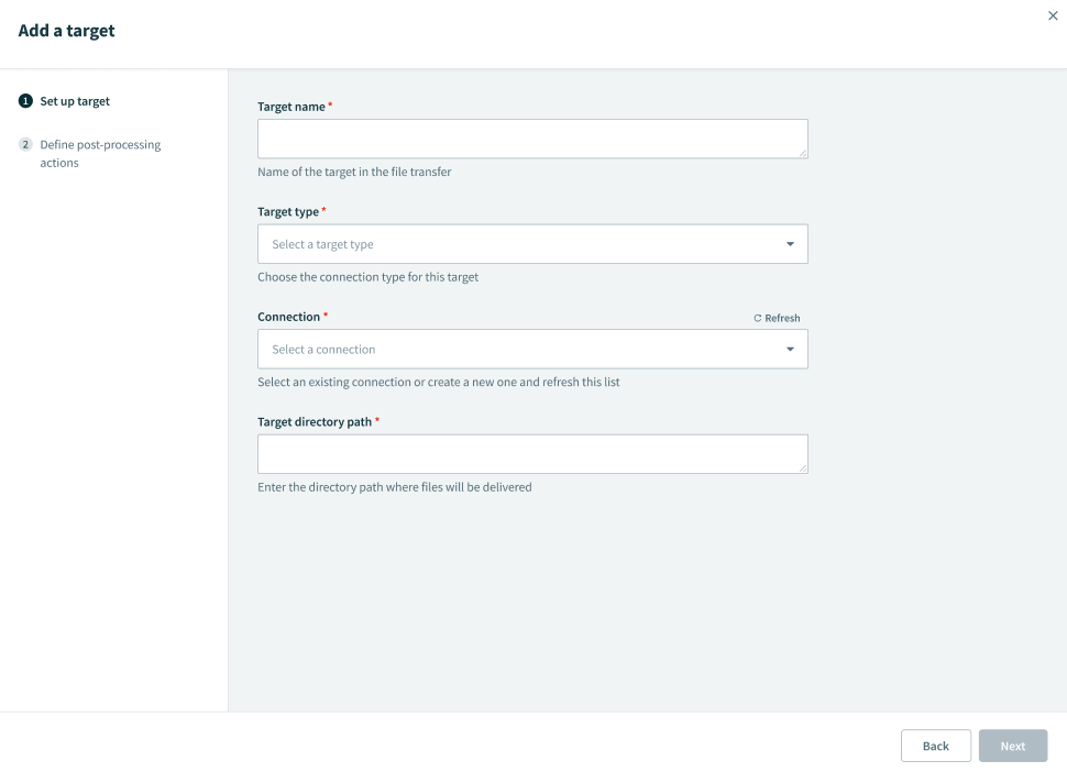

Add a target ​
Targets define where to deliver files and what processing actions to perform on files before delivery.
Complete the following steps to add a target to your file transfer:
Click + Add target. The Add target setup wizard displays.
The Add target setup wizardThe Add target setup wizard
Enter a descriptive name for the target in the Target name field. This name appears in logs and monitoring.
Use the Target type drop-down menu to select a connection type. Workato supports the following connections:
  • Amazon S3
  • Sharepoint
  • HTTPS
Use the Connection drop-down menu to select a connection if your Target type is External SFTP. Connections are reusable across all flow assets including file transfers. You can also click Create new connection, then click Refresh to update the list.
Enter the folder path to deliver files to in the Target directory path field. Ensure the target connection has the permission to upload to this path.
Use the When a file already exists at destination field to configure conflict resolution:
  • Skip (default): Doesn't transfer the file and logs the event as Skipped. Note that skipped files are considered successful runs, so the source-file handling rule configured in Set up source still applies.
  • Overwrite: Replaces the existing file at the destination. The original file is permanently replaced and can't be recovered.
Click Next, then continue to Processing actions.

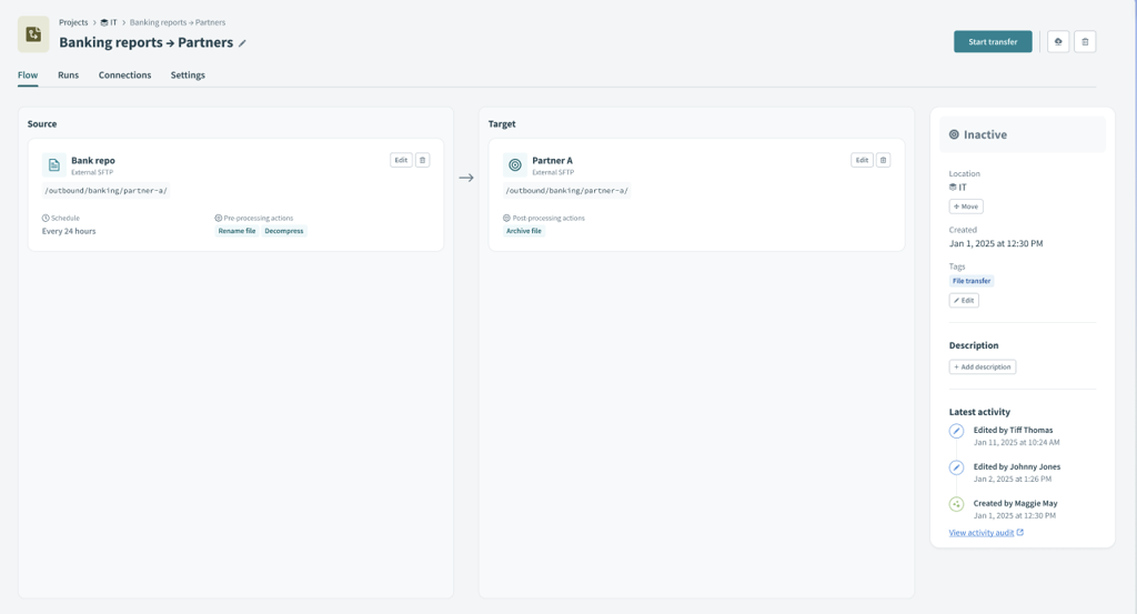

Start a transfer ​
Complete the following steps to start a file transfer after adding a source and a target:
Select the File transfer asset you plan to start.
Click Start transfer. The status changes from Inactive to Active. Transfers begin based on the schedule and Start after time configured during source setup. Restarting a stopped transfer doesn't trigger an immediate poll; it waits until the next scheduled poll time.
