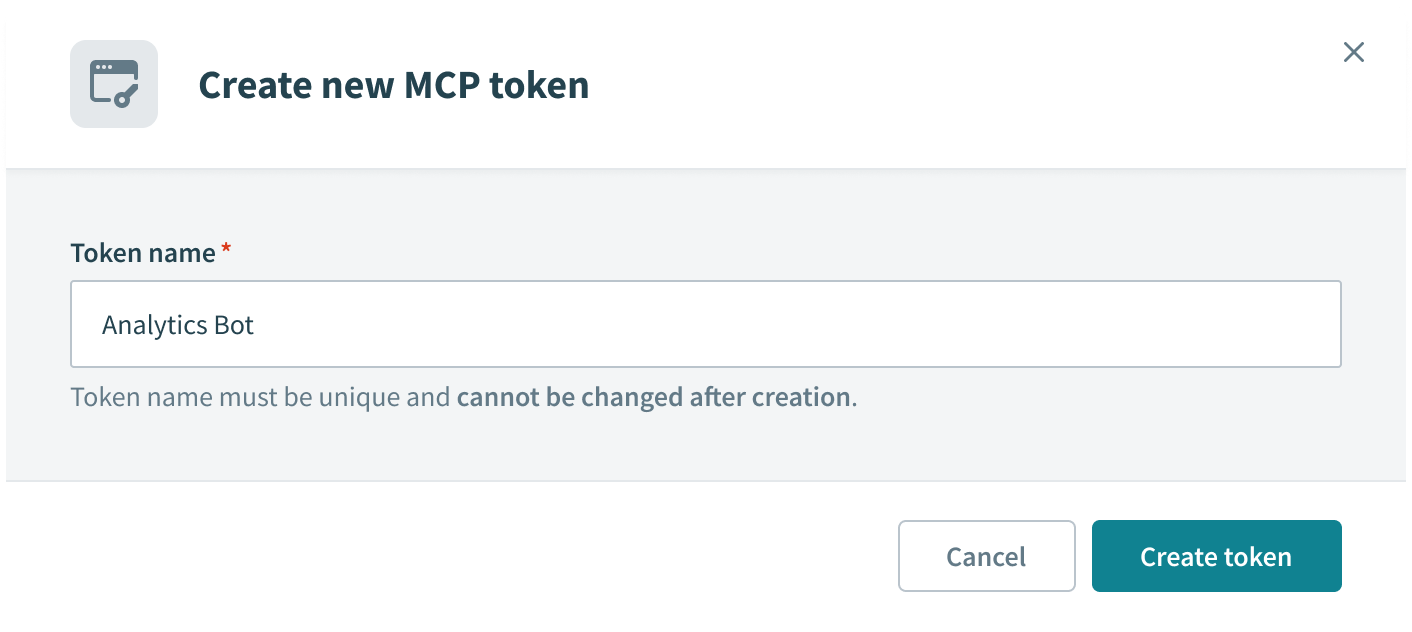

Click Create new token.
Enter a unique name for the token in the Token name field.
Enter a unique name for the token in the Token name fieldEnter a unique name for the token in the Token name field
Click Create token.
Click Copy to copy the generated token.

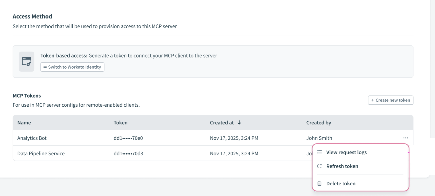

Go to MCP Tokens and click the ellipsis (...) for the MCP token you plan to refresh.
Go to MCP Tokens and click the ellipsis (...)Go to MCP Tokens and click the ellipsis (...)
Click Refresh token.
Click Refresh token again when prompted in the confirmation modal.
MCP CLIENT IMPACT
A token becomes invalid when you refresh it. MCP clients using the token lose access to the server and stop working.
Copy the refreshed token and update your connections where appropriate.

Go to MCP Tokens and click the ellipsis (...) for the MCP token you plan to delete.
Click Delete token.
Click Delete token again when prompted in the confirmation modal.
MCP CLIENT IMPACT
