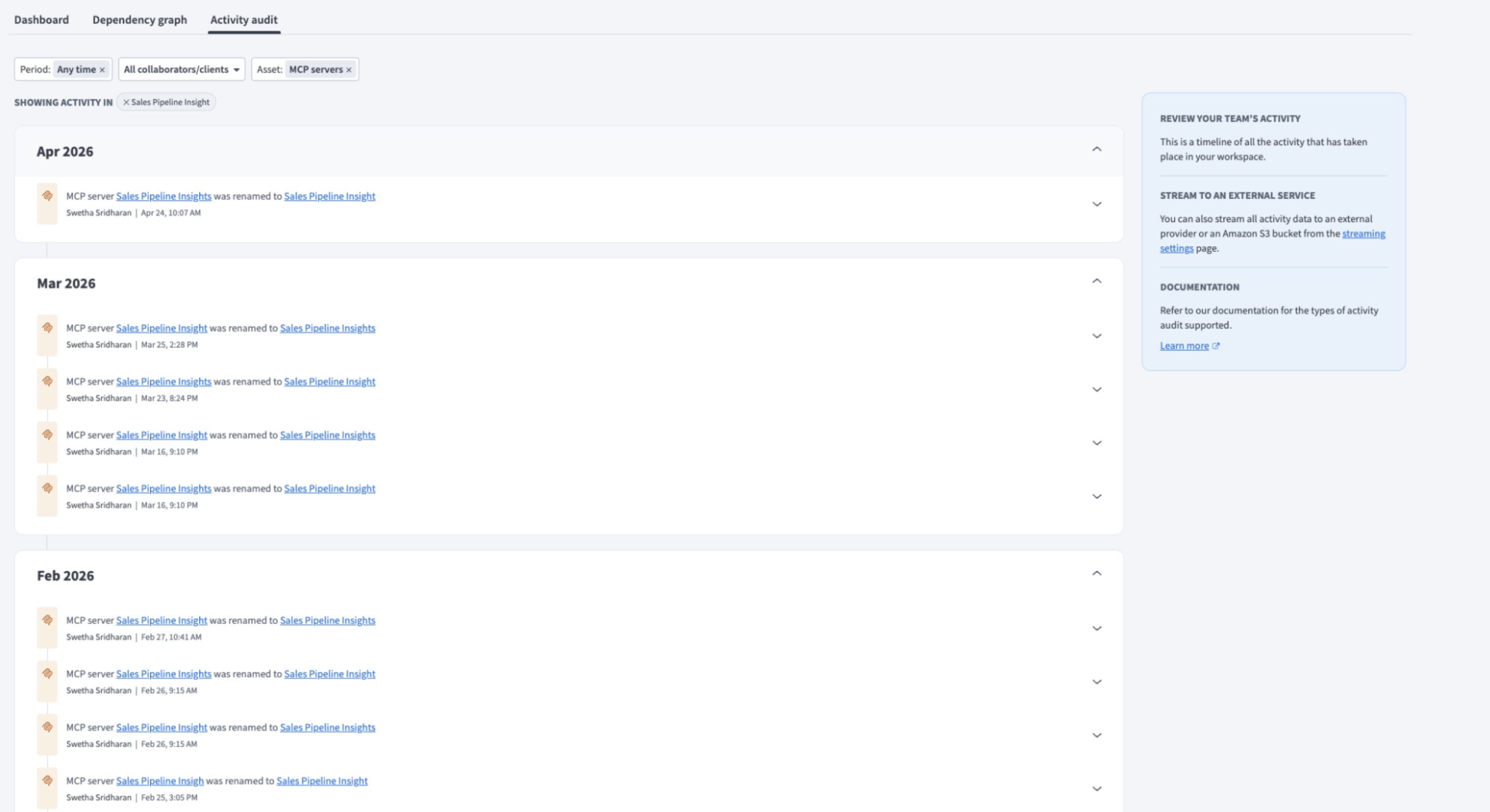

Audit trail
Every administrative action is logged with the actor, the resource, and the change set:
  • Servers: Created, renamed, or deleted
  • Tools: Added, removed, started, or stopped
  • Policy changes: IP allow and deny lists, rate limits, and quota limits
Activity auditActivity audit

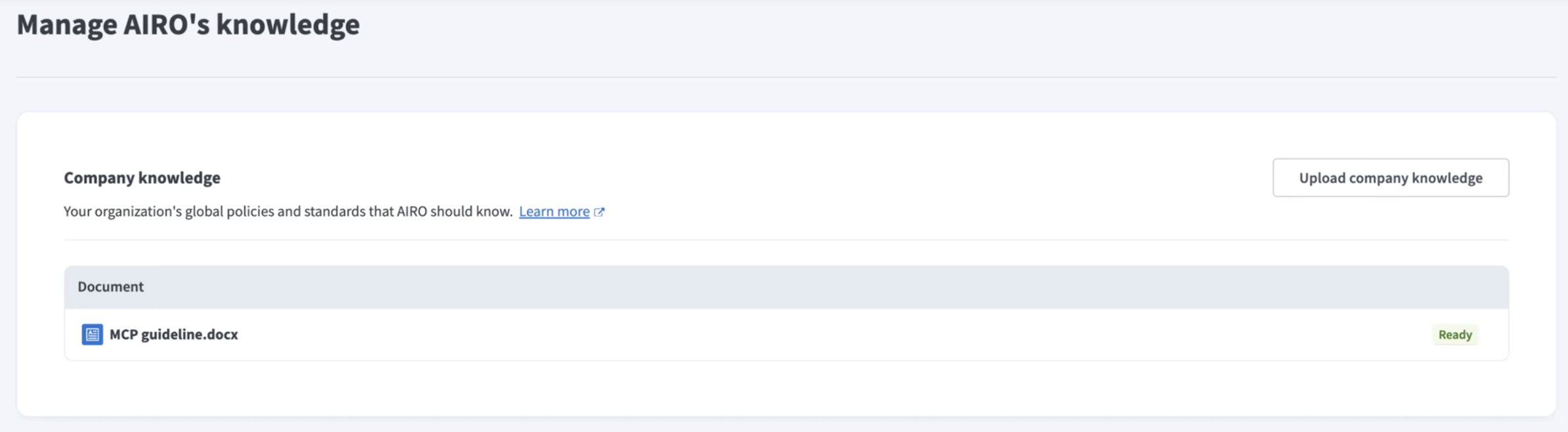

Complete the following steps to use design-time governance with AIRO:
Upload a playbook to AIRO with MCP server governance guidelines. Alternatively, you can attach the playbook to a new AIRO chat.
Upload MCP governance guidelines to AIROUpload MCP governance guidelines to AIRO

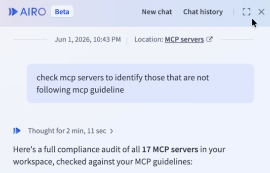

Start a chat with AIRO and ask it to identify MCP servers that aren't following your governance guidelines.
Ask AIRO to review MCP serversAsk AIRO to review MCP servers
