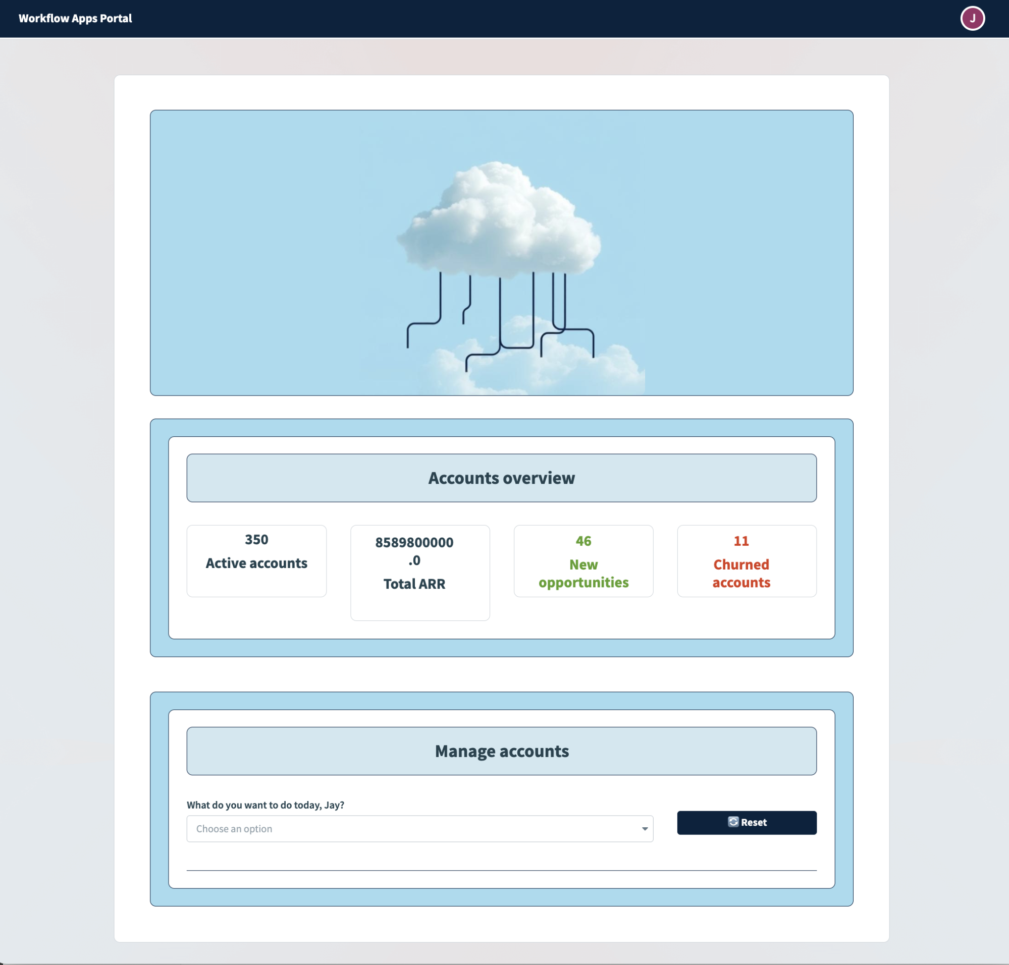

# Example use case: CRM app
This example demonstrates how to use Run recipe actions to create a front-end app for a third-party application, such as a CRM, and uses Salesforce as an example.
Front-end CRM appFront-end app for Salesforce powered by Run recipe actions
In this example, the end-users of the application are business users who need limited access to Salesforce. This app must deliver the following functionality:
  • Provide a high-level overview of accounts
  • Provide a detailed look into an account users specify
  • Enable users to create, update, and delete accounts

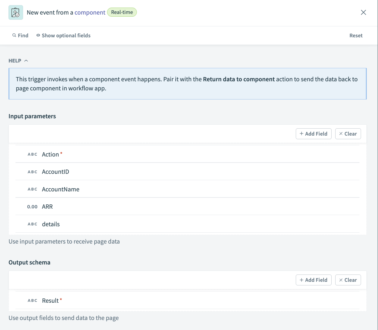

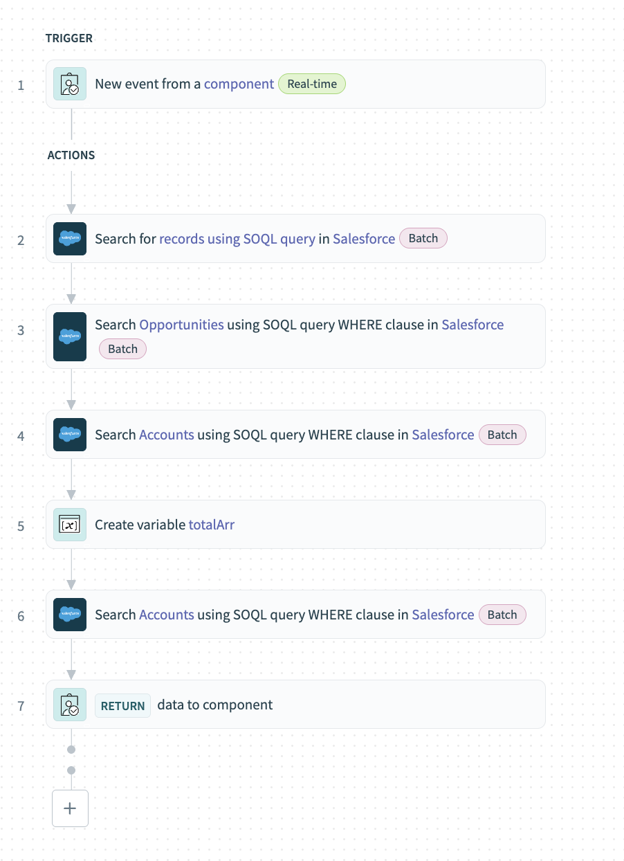

Workato generates a recipe pre-configured with the New component event (real-time) trigger and the Return data to component action:
Recipe outlineRecipe outline
Modify the New component or drop-down event trigger
Complete the following steps to modify the trigger:
Select the New component or drop-down event trigger.
Go to the Setup tab.
Go to Output parameters and click + Add field.
Go to the Name field and provide a unique name for this parameter, such as totalAccounts.
Go to the Label field and provide a unique name for this field, such as Total accounts.
Go to the Data type field and select Integer.
Go to the Optional field and select No. When No, this field is required.
Optional. Go to the Hint field and provide a hint to help users fill out this field.
Your configuration should look as follows:
Configure output schemaConfigure the output schema
Create the following additional output fields:
Name Label Data type Optional
TotalArr Total arr Number No
NewOpps Total opps Integer No
ChurnedAccs Churned accounts Integer No
Click Save.

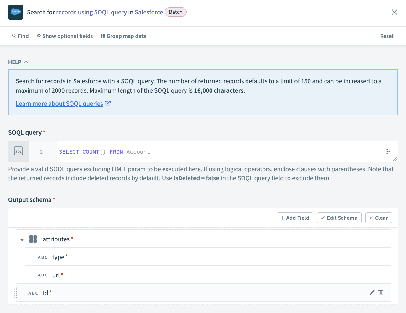

Go to the SOQL query field and type SELECT COUNT() FROM Account.
Go to the Output schema field and click Use SOQL.
Type the same SOQL query as above, SELECT COUNT() FROM Account.
Click Next and Generate schema. Workato generates the output schema by default.

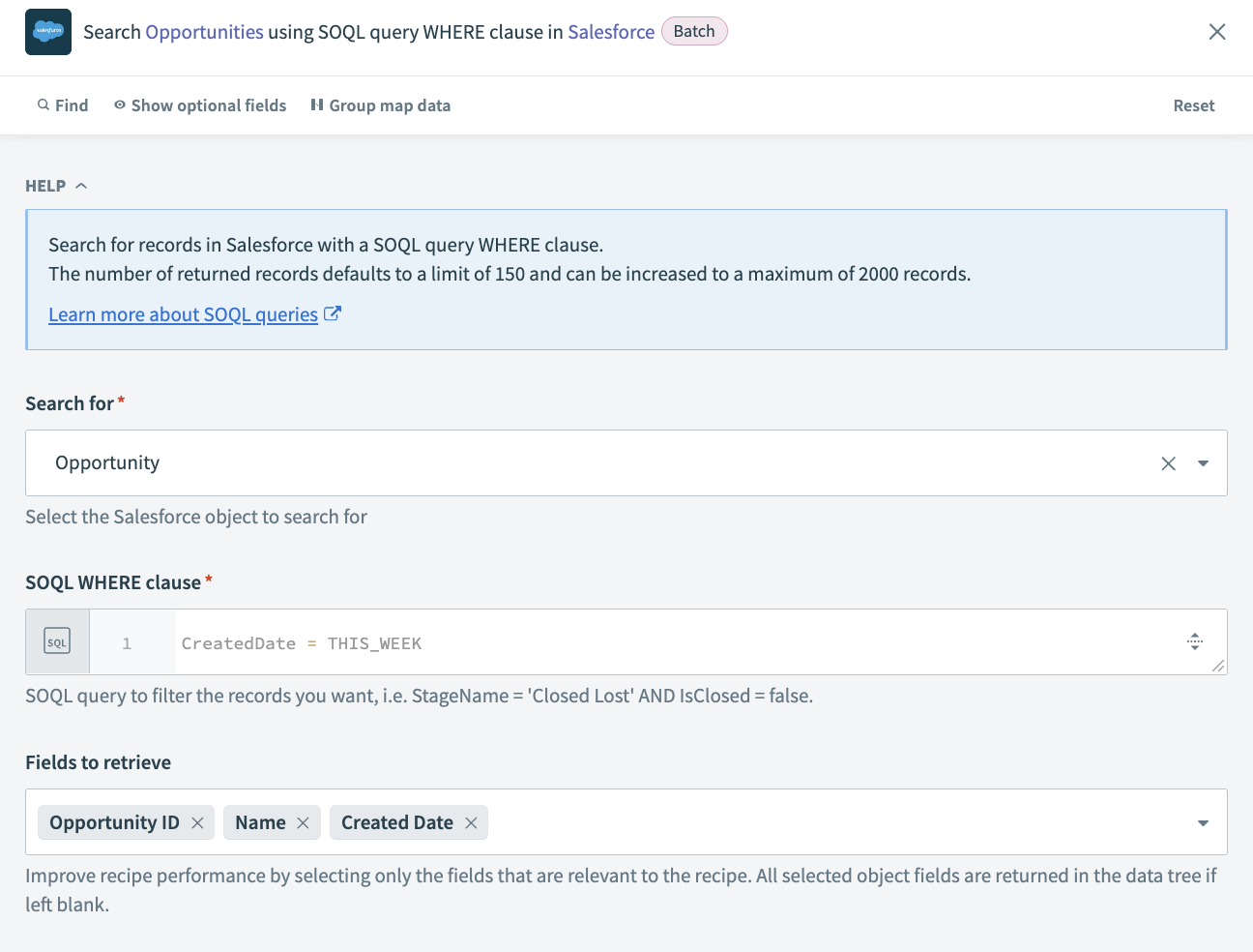

Configure a Search Opportunities using SOQL query WHERE clause in Salesforce (Batch) action.
This action fetches new opportunities and populates the newOppsoutput field.
Click + and select Action in an app.
Search for and select Salesforce as your app.
Select the connection type you plan to use for this action.
Connection typeChoose a connection type
  • End user's connection: Workflow apps recipes perform actions based on the identity and permissions of the user who connects to the application. End users authenticate with their own credentials to retrieve or modify data in an external app.
  • This recipe's connection: This option uses the connection established by the recipe builder and follows the same principles as normal app connections.
Only app connections that use OAuth 2.0 are available for end user's connection. Refer to Verified user access for more information.
Select an existing connection or click + New connection to create a new connection.
Select the Search records using SOQL query WHERE clause (Batch) action.
Use the Search for drop-down menu to select Opportunity.
Go to the SOQL WHERE clause field and type CreatedDate = THIS_WEEK.
Use the Fields to retrieve drop-down menu to select Opportunity ID, Name, and Created date.
Search records using SOQL querySearch Opportunities SOQL query WHERE clause action configuration

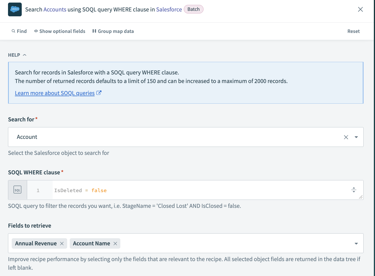

Use the Search for drop-down menu to select Account.
Go to the SOQL WHERE clause field and type IsDeleted = false .
Use the Fields to retrieve drop-down menu to select Annual revenue, and Account name.

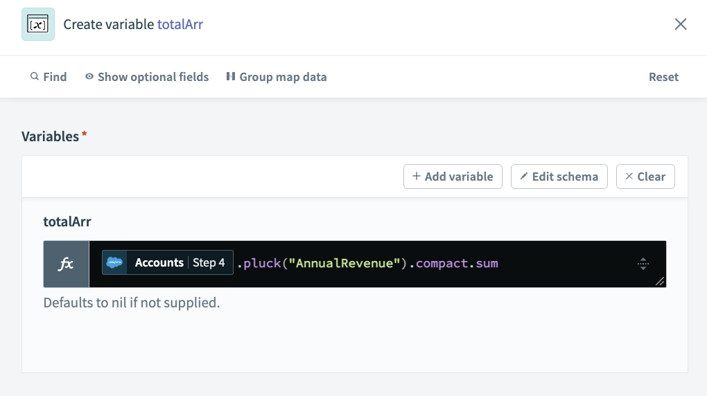

Create a variable
This action aggregates the total ARR from all accounts in Salesforce.
Search for and select Variables by Workato as your app.
Select the Create variable action.
Click + Add variable and click Formula to use formula mode to create your variable.
Map in the Accounts Step 4 datapill and type .pluck("AnnualRevenue").compact.sum.
Create variable actionCreate a variable to find the total ARR

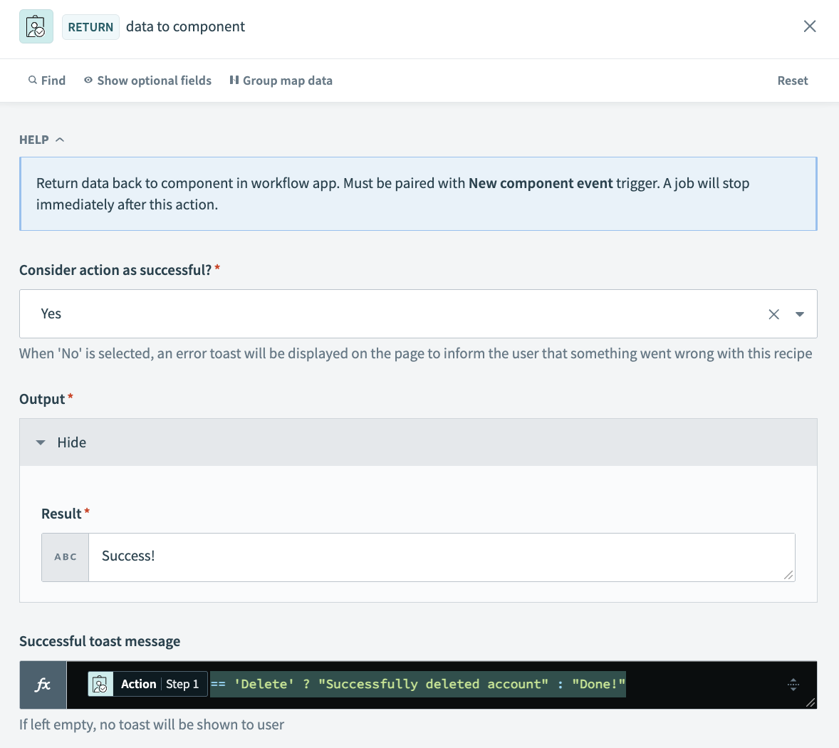

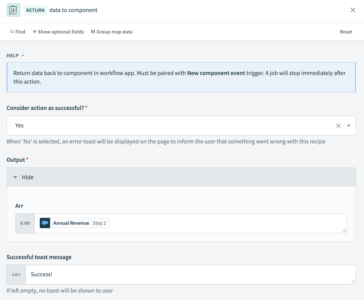

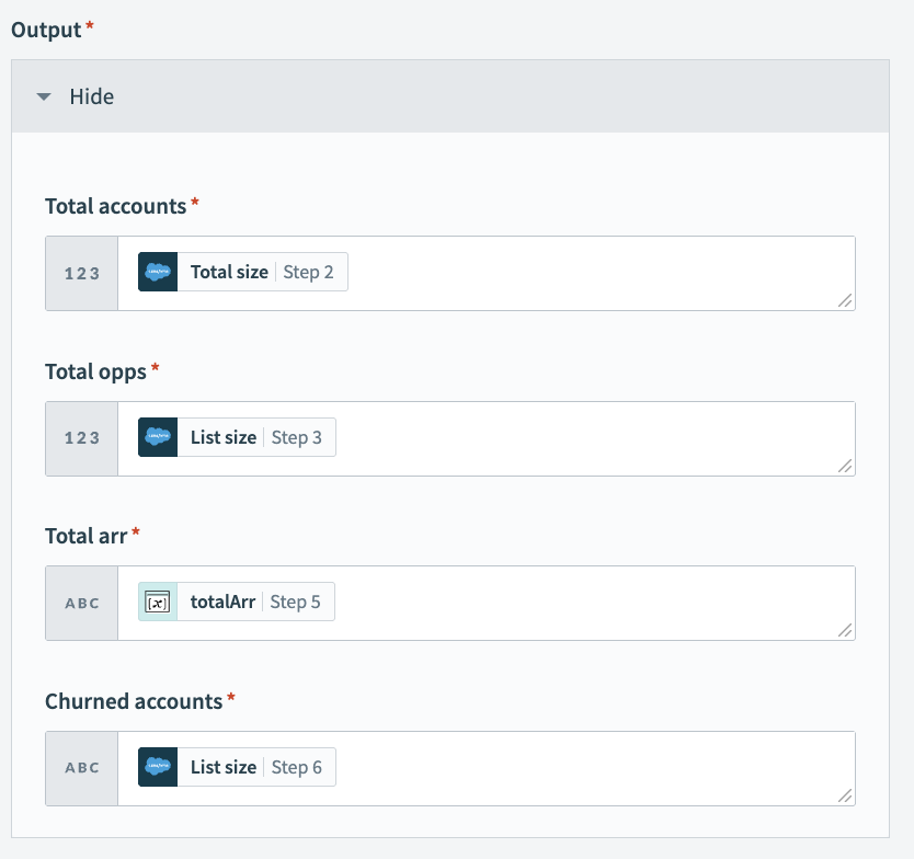

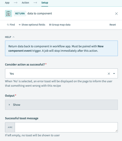

Modify the Return data to component action
Select the Return data to component action.
Go to the Consider action as successful field and select Yes.
Go to the Output section and map datapills to the following fields:
Output field name Datapill
Total accounts Total size Step 2
Total opps List size Step 3
Total arr totalArr Step 5
Churned accounts List size Step 6
Configure return to component actionReturn values fetched from Salesforce to your page
Optional. Go to the Successful toast message field and provide a custom success message.
Click Save and Exit.

Your completed recipe should look as follows:
Completed recipeCompleted recipe

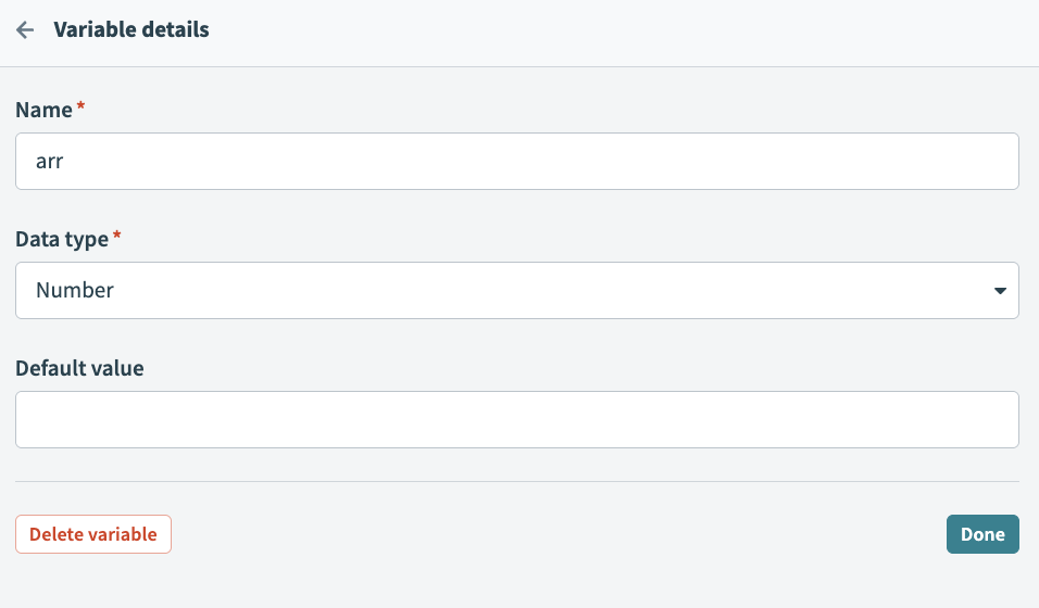

Create variables
Complete the following steps to create and configure the variables required to surface high-level account data in your app. These variables correspond to the output schema defined in the Page load recipe created in the previous step.
Click the page canvas.
Go to the Design panel.
Click + Add variable.
Go to the Name field and type a unique name for your variable, such as ActiveAccounts. This variable represents the total number of active accounts in Salesforce.
Go to the Data type menu and select integer as the data type.
Optional. Go to the Default value field and provide a default value for your variable, such as <null>.
Click Done.
Variable detailsVariable details

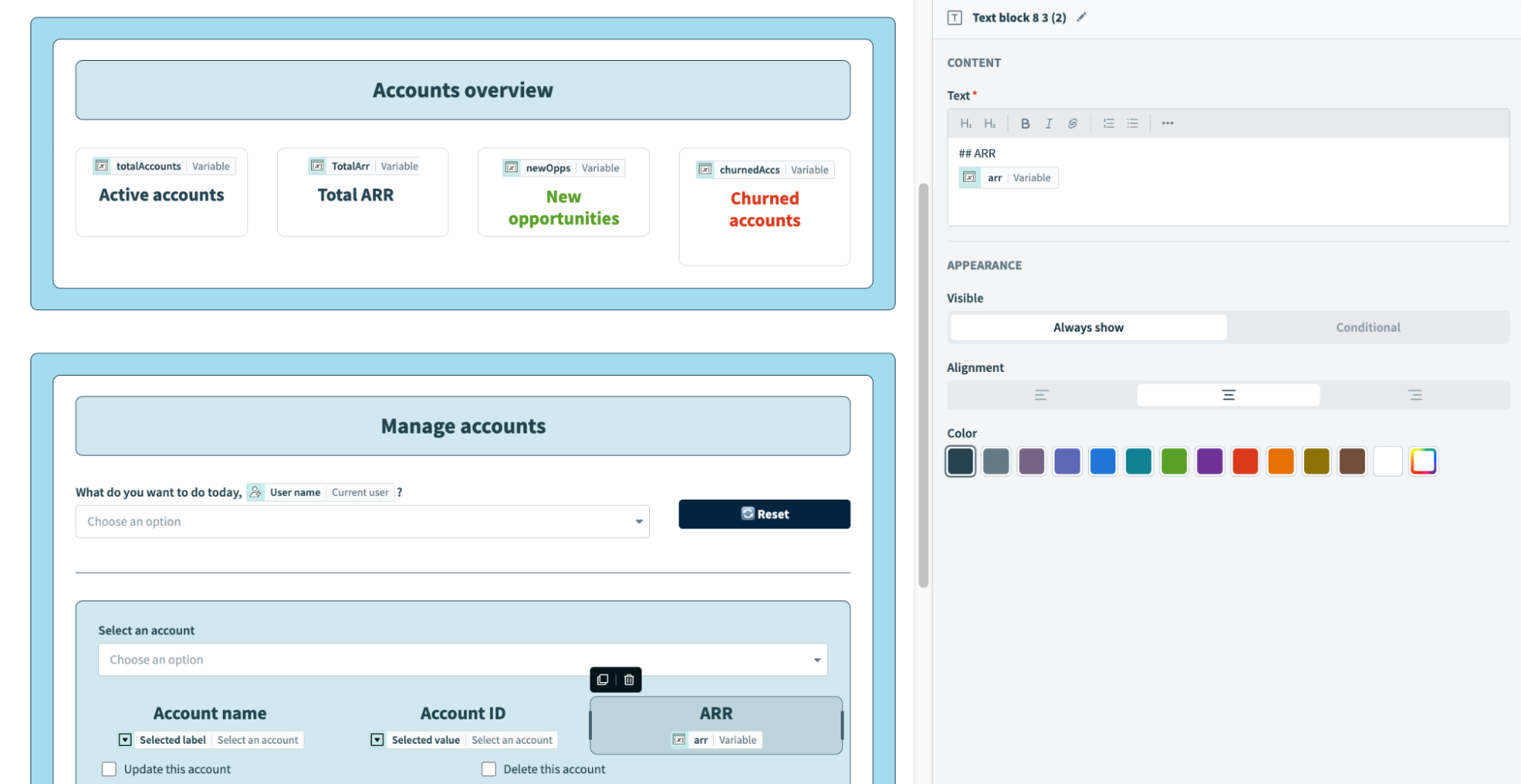

Map variables into page components
This example has separate Text block components to hold each variable, which are located in the account overview section of our app.
Complete the following steps to map variables into page components:

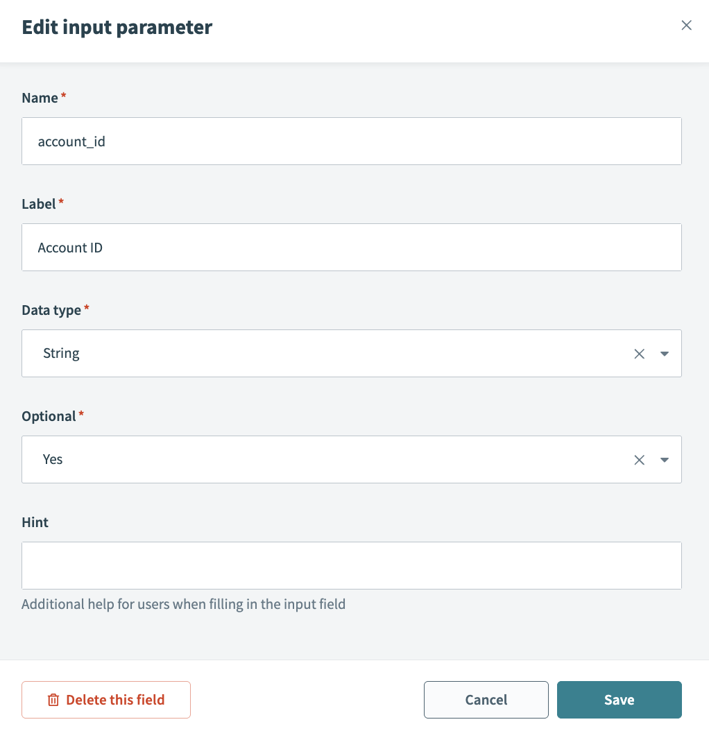

Go to Input parameters and click + Add field.
Go to the Name field and provide a unique name for this parameter, such as account_id.
Go to the Label field and provide a unique name for this parameter, such as Account ID.
Go to the Data type field and select String.
Go to the Optional field and select Yes.
Configure an input parameterConfigure an input parameter

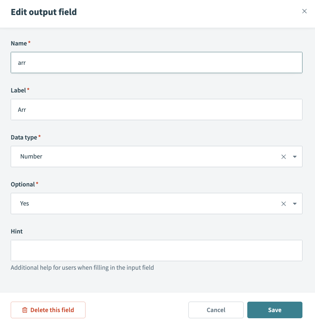

Go to the Name field and provide a unique name for this parameter, such as arr.
Go to the Label field and provide a unique name for this field, such as Arr.
12
Go to the Data type field and select Number.
13
Configure an output parameterConfigure an output parameter

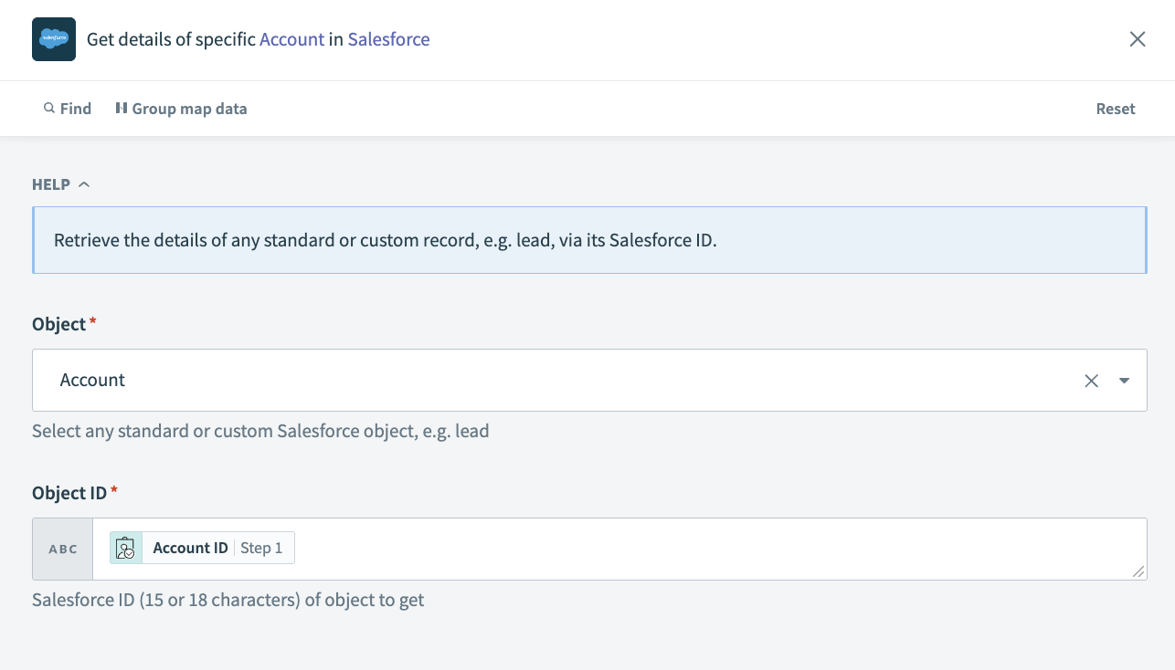

Use the Object drop-down menu to select Account.
Map the Account ID Step 1 datapill into the Object ID field.
Get details of a specific Account in Salesforce actionGet details of a specific Account in Salesforce action
Go to the Output section and map the Annual Revenue Step 2 datapill to the Arr field.
Optional. Type a custom toast message into the Successful toast message field.
Configure a return data to component actionConfigure the Return data to component action
This example is configured with a Text block component to hold the variable, which is located in the Manage accounts section of the app.
Complete the following steps to map a variable into a page component:
Click a text block component to select it.
Go to the Text field and click it. The Page data modal appears.
Go to Variables and select arr.
Add a label to help identify your variable, such as ARR.
Apply styling, such as Markdown and color, as appropriate.
Map the ARR variableMap the ARR variable
Click Save.

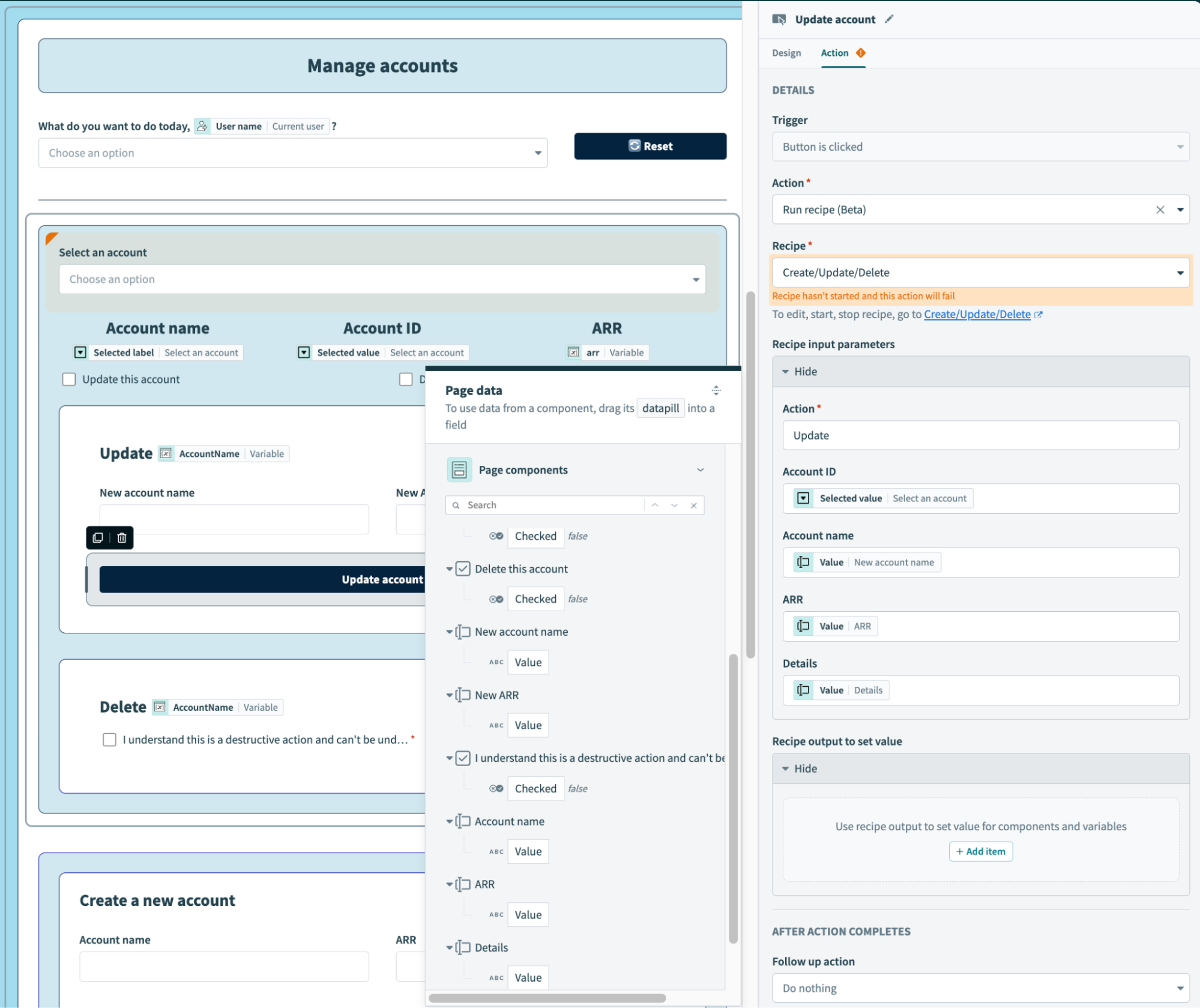

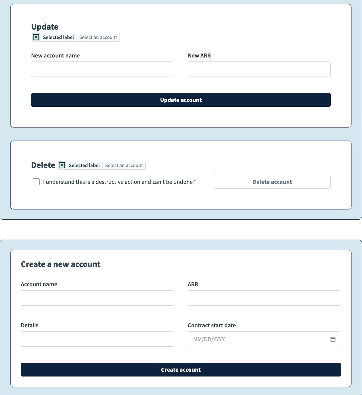

The Manage CRM application page is configured with the following buttons, which enable users to perform actions in Salesforce:
  • Update account
  • Delete account
  • Create account
Buttons for updating, deleting, and creating an accountButtons for updating, deleting, and creating an account

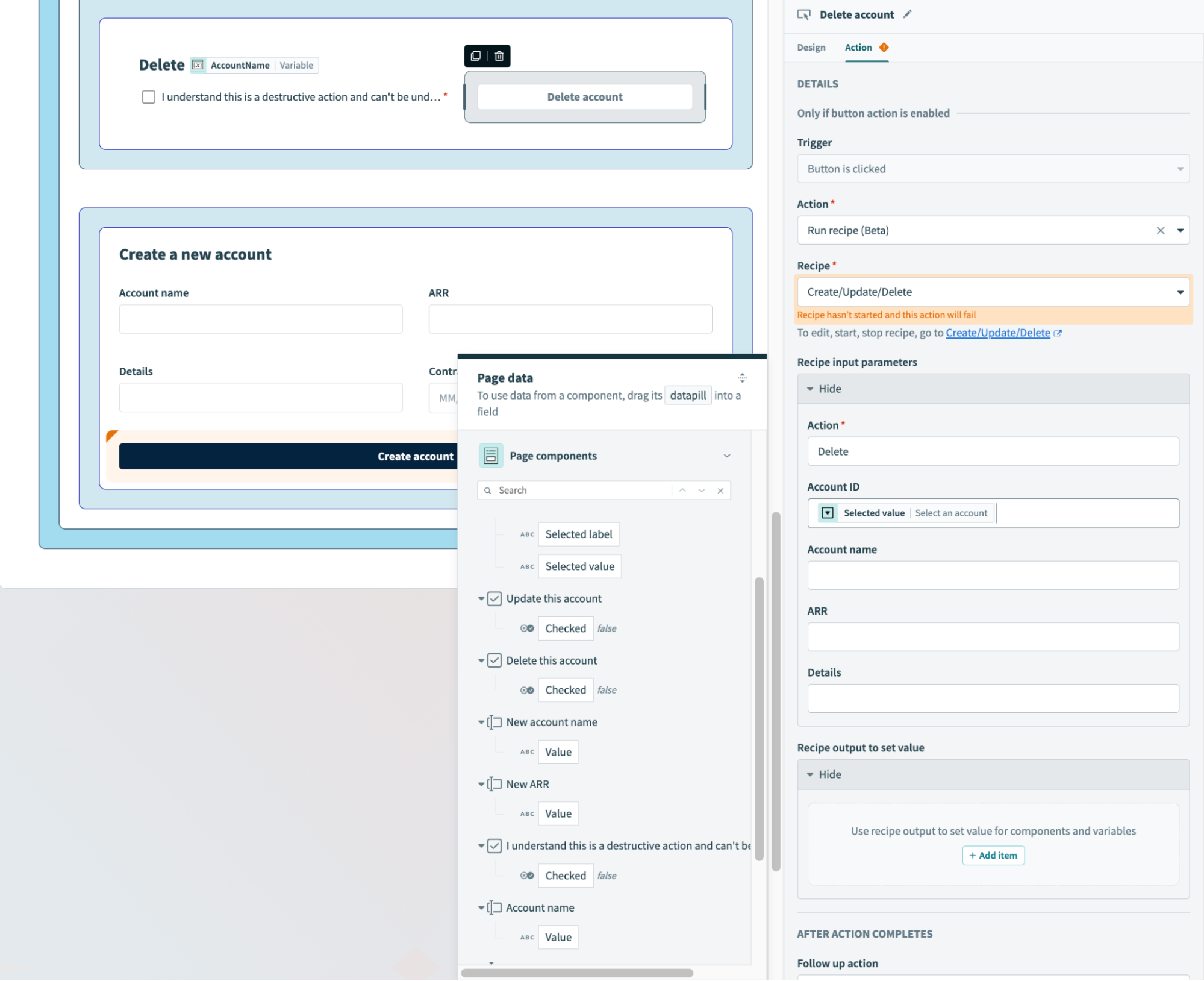

Complete the following steps to enable action when users click a button:
Go to the page editor.
Click the Update account button.
Go to the Action panel.
Use the Action drop-down menu to select Run recipe.
Use the Recipe drop-down menu to select Create recipe. This opens the Set up your recipe page in a new tab.
Go to the Name field and provide a unique name for this parameter, such as action.
Go to the Label field and provide a unique name for this field, such as Action.
Create the following additional input parameters:
accountID Account ID String Yes
accountName Account name String Yes
arr ARR Number Yes
details Details string Yes
Go to the Name field and provide a unique name for this parameter, result.
Go to the Label field and provide a unique name for this field, such as Result.
12
13
Input and output parameter configurationInput and output parameter configuration

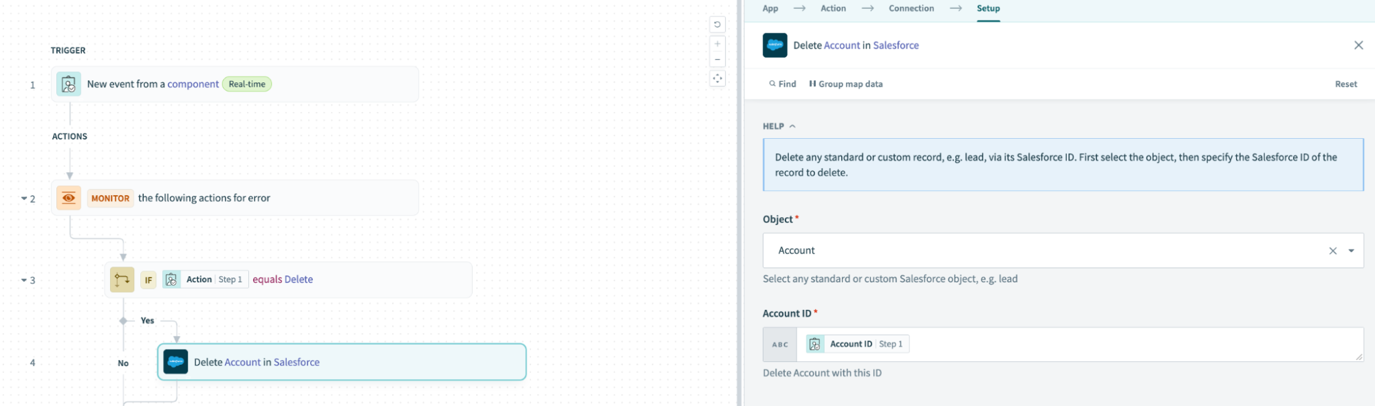

Click Handle errors to add a Monitor block to your recipe.
Click + and select IF condition.
Map the Action Step 1 datapill into the Data field field.
Use the Condition drop-down menu to select equals.
Type Delete in the Value field.
Configure a Delete Account in Salesforce action
Select the Delete Account in Salesforce action.
Delete account in Salesforce actionDelete an account in Salesforce action

Modify the Return data to component action and configure conditional logic
This portion of the workflow sends either a successful toast message back to the application or an error message based on whether the action is executed successfully.
Click + and select ELSE.
Search for and select Workflow apps as your app.
Use the Consider action as successful? drop-down menu to select No.
Type Unsupported action in the Error message field.
Go to the Error found? section and click the Do not retry action. Use the Retry actions in Monitor block drop-down menu to select Do not retry.
Click the Select an app and action step and search for and select Workflow apps as your app.
Type a custom error message in the Error message field, such as Error occurred.
12
Click the Return data to component action to select it.
Use the Consider action as successful? drop-down menu to select Yes.
Go to the Output section and type Success! in the Result field.
Go to the Successful toast message field and map in the Action Step 1 datapill.
Type in === 'Delete' ? "Successfully deleted account" : "Done!"

Configure the Update account button
Select the Update account button.
Go to the Recipe input parameters section and set up input parameters for use in the Create, update, or delete account recipe created in the previous step.
Type Update into the Action field.
Map the Selected value Select an account page component datapill into the Account ID field.
Map the Value New account name page component datapill into the Account name field.
Map the Value ARR page component datapill into the ARR field.
Map the Value Details page component datapill into the Details field.
Leave the Recipe output to set value and Follow up action fields blank.
Update account button configurationUpdate account button configuration
Configure the Delete account button
Select the Delete account button.
Go to the Recipe input parameters section to set up input parameters for use in the Create, update, or delete account recipe created in the previous step.
Type Delete into the Action field.
Delete account button configurationDelete account button configuration
Configure the Create account button
Select the Create account button.
Type Create into the Action field.
Map the Value Account name page component datapill into the Account name field.
Map the arr Variable page component datapill into the ARR field.
Create account button configurationCreate account button configuration
Click Save.

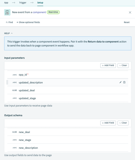

Modify the trigger
Select the New component event trigger.
Go to the Name field and provide a unique name for this parameter, such as opp_id.
Go to the Label field and provide a unique name for this field, such as Opportunity ID.
updated_description Updated description String Yes
updated_deal Updated deal amount Number Yes
updated_stage Updated stage String Yes
Go to the Name field and provide a unique name for this parameter, such as new_deal.
Go to the Label field and provide a unique name for this field, such as New deal amount.
12
13
14
Create the following additional output parameters:
new_description New description String Yes
new_stage New stage String Yes

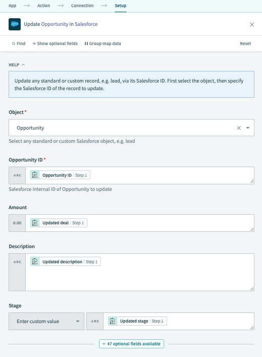

Click Select an app and action.
Select the Update record in Salesforce action.
Use the Object drop-down menu to select Opportunity.
Map the Opportunity ID Step 1 datapill into the Opportunity ID field.
Map the Updated deal Step 1 datapill into the Amount field.
Map the Updated description Step 1 datapill into the Description field.
12
Map the Updated stage Step 1 datapill into the Stage field.
Delete account in Salesforce actionUpdate an opportunity in Salesforce action

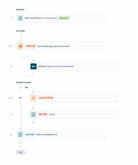

Modify the Return data to component action and configure error handling
This portion of the workflow sends an error message to the application if the Update opportunity in Salesforce action fails.
Type Unable to update opportunity. Contact your portal admin to learn more. in the Error message field.
Select the Return data to component action in step 6.
Configure the return data to component actionConfigure the Return data to component action
Click Start recipe.
Completed recipeComplete recipe

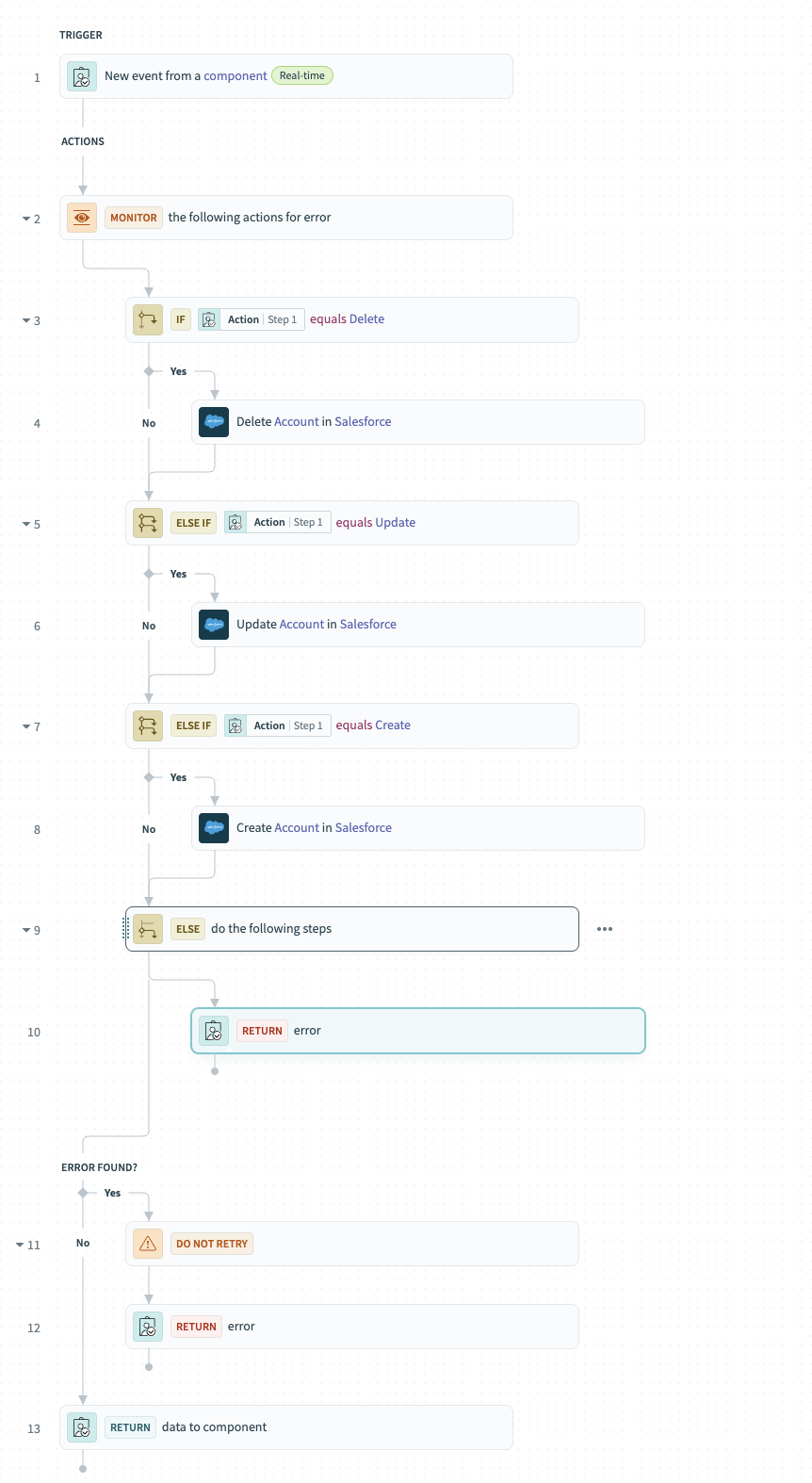

# Define input parameters and reload page components
This part of the setup focuses on defining input parameters and setting up a follow-up action to reload page components. Since the table data is directly sourced from Salesforce, there is no need to map recipe outputs into page components or variables
Complete the following steps to reload page components using the page editor:

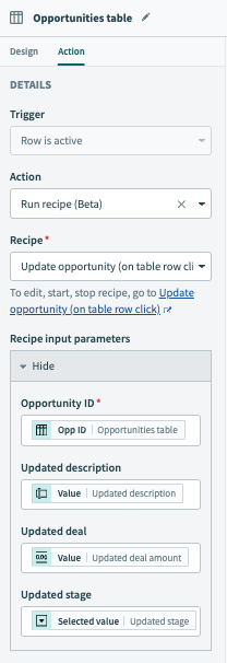

Configure recipe input parameters
Select the Opportunities table.
Go to the Recipe input parameters section and map page data into the provided fields.
Map the Opp ID Opportunities table into the Opportunity ID field.
Map the Value Updated description into the Updated description field.
Map the Value Updated deal amount into the Updated deal amount field.
Map the Value Updated stage into the Updated stage field.
You configuration should look as follows:
Table row select configurationTable row selection configuration
Reload the table component
This step reloads the Opportunities table with updated user-provided data.
Select the Update opportunity button.
Use the Action drop-down to select Reset/reload components.
Use the Components field to select the component values to reload on button click, the update opps container and Opportunities table.
Click Save.
Component resetReset table component
