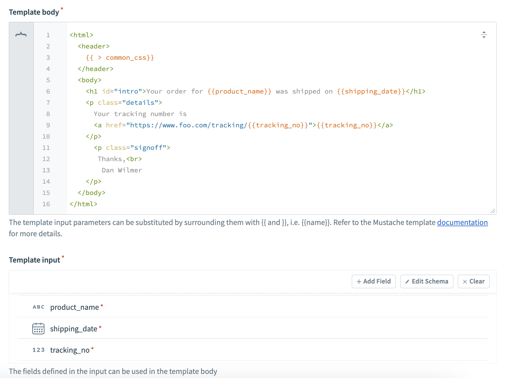

The UI developer builds an HTML template for outgoing emails about shipped products in an order. The Message template contains CSS and it uses template variables for dynamic content.
HTML template with variable substitution HTML template with variable substitution
The recipe developer then generates the email message by selecting the template to use and providing values for the message variables.

Navigate to Tools > Message templates and click + New template.
Provide the body text of the message in the Template body field. This field uses Mustache as its templating language. Refer to the Mustache documentation for more information.
Add your variables in the Template input field. You can use JSON or manually create your variables. Template variables support both scalar data types (string, integer, date, number, time, and boolean) and complex data types (object and list). You can define values for template variables in recipes using the Create message action.
Completed Template inputTemplate with defined variables

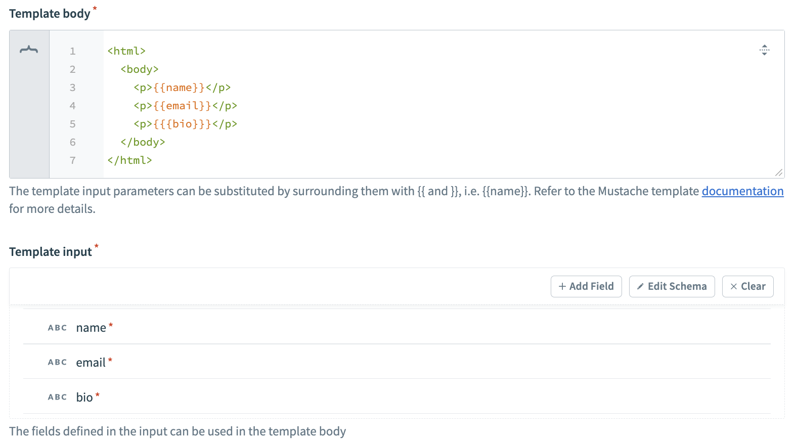

Variables
The variable tag enables you to specify placeholders in a template. Tags are variables by default, but can be made into sections, inverted sections, comments, and partials with additional syntax characters.
Variable tags are HTML escaped by default. To unescape a variable tag, use triple curly brackets or start with a &, for example: {{{email}}} or {{& email}}.
Template definition with variables example
The following template defines the variables name, email, and HTML escaped bio.
Template with variablesTemplate with variables
If we pass the following values into the template:
javascript
  "name": "Fiona Summers",
  "bio": "<b>President of debate club</b>"
We receive the following template output:
html
<html>
  <body>
    <p>Fiona Summers</p>
    <p></p>
    <p>&lt;b&gt;President of debate club&lt;/b&gt;</p>
    <p><strong>President of debate club</strong></p>
  </body>
</html>

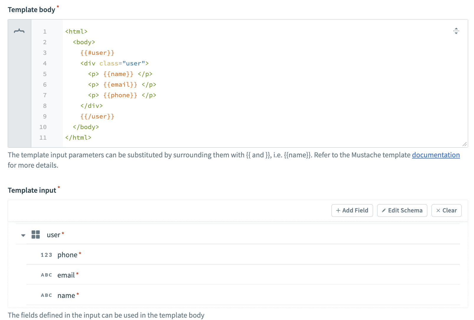

Object section
When the value of the section variable is an object, the section is rendered only once. The block has access to all the keys declared within the object.
Template definition with object section example
The following template defines an object section user with the fields name, email, and phone.
Template with object sectionTemplate with an object section
javascript
  "user": {
    "email": "[email protected]",
    "phone": "650 8xx 7567"
html
<html>
  <body>
    <div class="user">
      <p> Fiona Summers </p>
      <p> [email protected] </p>
      <p> 650 8xx 7567 </p>
    </div>
  </body>
</html>

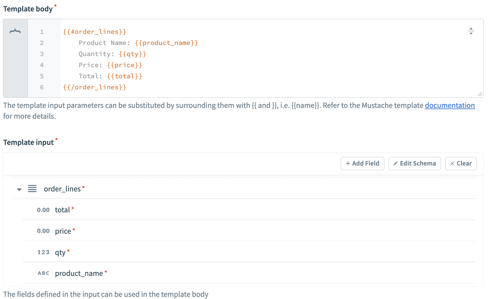

List section
When the value of section variable is a list, it is rendered multiple times. The block has access to all the keys declared in a row of the list. To retrieve multiple values in the template response, use an array.
Template definition with list section example
The following template defines a list section order_lines with the fields product_name, qty, price, and total.
Template with list sectionTemplate with a list section
javascript
  "id": "KA100",
  "order_lines": [
    { "product_name": "Anker USB charger", "qty": 1, "price": "15.99", "total": "15.99" },
    { "product_name": "Guard screen protector", "qty": 1, "price": "7.50", "total": "7.50" }

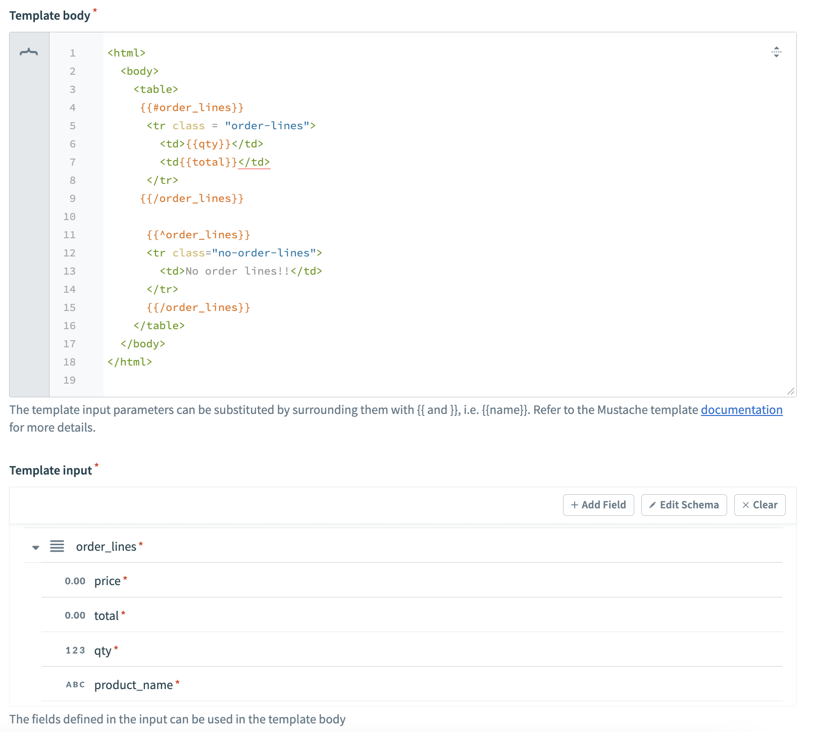

Inverted section
Inverted sections are rendered when a template variable is missing, false, or an empty list. Opening inverted section tags start with a ^, for example: {{^order_lines}}. Closing tags start with a /, for example: {{/order_lines}}.
Template definition with inverted section example
The following template defines an inverted section order_lines that displays an error message No error lines!! if the order_lines list is missing, false, or empty.
Template with list sectionTemplate with inverted section
javascript
  "id": "KA100",
  "order_lines": []
html
<html>
  <body>
    <table>
      <tr  class="no-order-lines">
        <td>No order lines!</td>
      </tr>
    </table>
  </body>
</html>

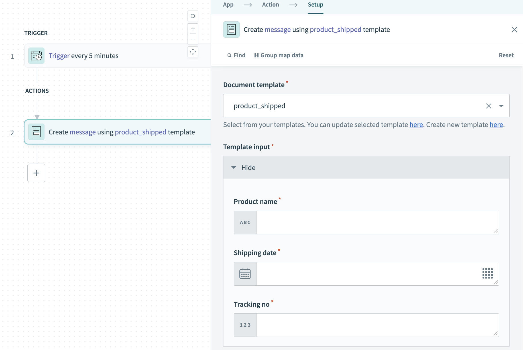

Within a recipe, use the Create message action in the Message template by Workato adapter to generate a message from a Message template.
REQUIRES AT LEAST ONE TEMPLATE
To use the Create message action, your workspace must have at least one template saved.
Create message actionUse of the Create message action within a recipe
Input
InputDescription
Document templateSelect the template you plan to use.
Template inputProvide datapills or fixed values for your template's tags to use within this recipe.
Output
OutputDescription
DocumentA static string generated from the Document template, with values from the Template input field passed to their associated tags.
