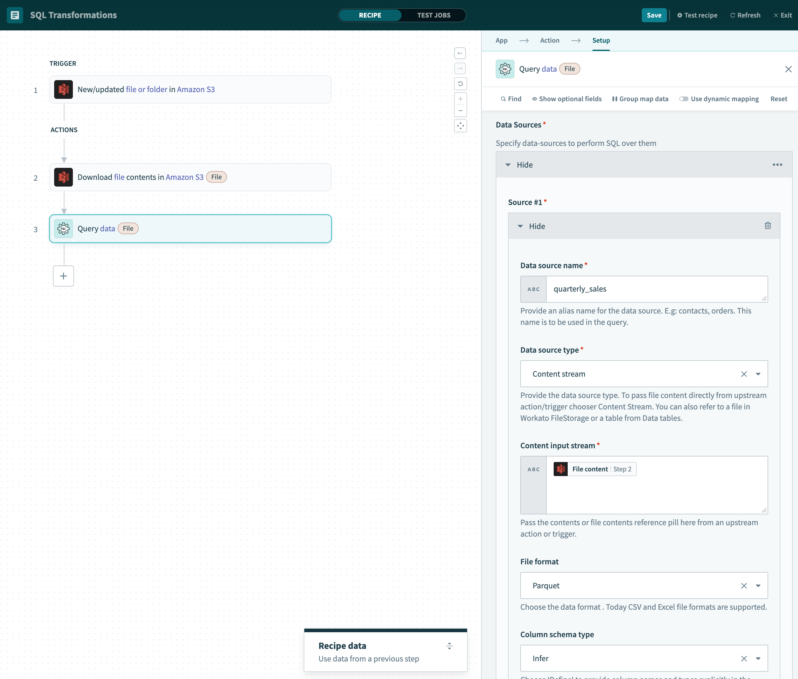

This example processes quarterly sales data stored as a Parquet file in AWS S3. It transforms transaction records into regional sales performance insights and outputs results in Parquet format for optimal downstream processing.
Parquet S3 configuration exampleParquet data source configuration from AWS S3
Configuration:
  • Data source name: quarterly_sales
  • Data source type: Content stream (from S3 Download file action)
  • Content input stream: File content Step 2 datapill
  • File format: Parquet
  • Column schema type: Infer

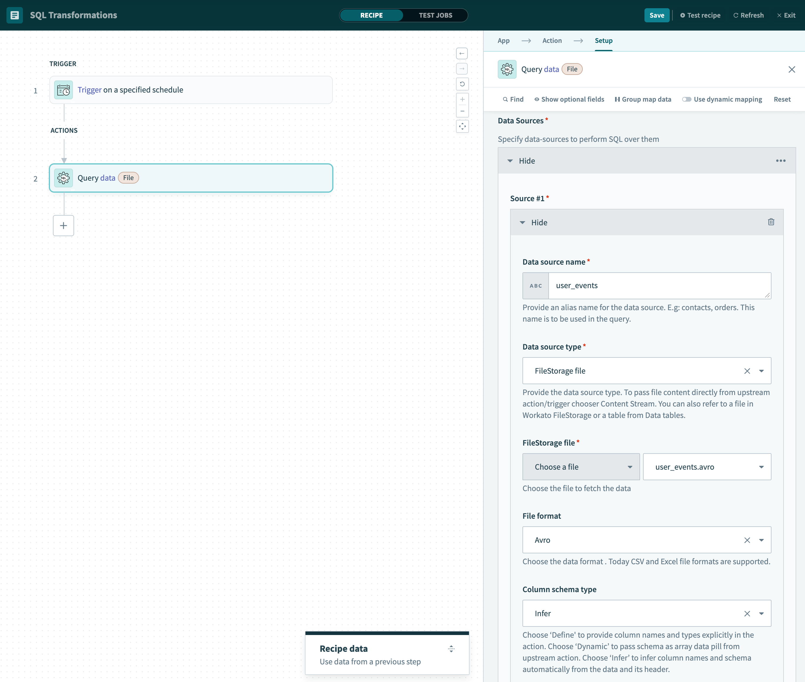

# Example: Process event data from an Avro file
This example transforms user interaction events from an Avro file in Workato FileStorage into page performance metrics.
Avro FileStorage configuration exampleAvro data source configuration from Workato FileStorage
Configuration:
  • Data source name: user_events
  • Data source type: FileStorage file
  • File path: /user_interactions.avro
  • File format: Avro
