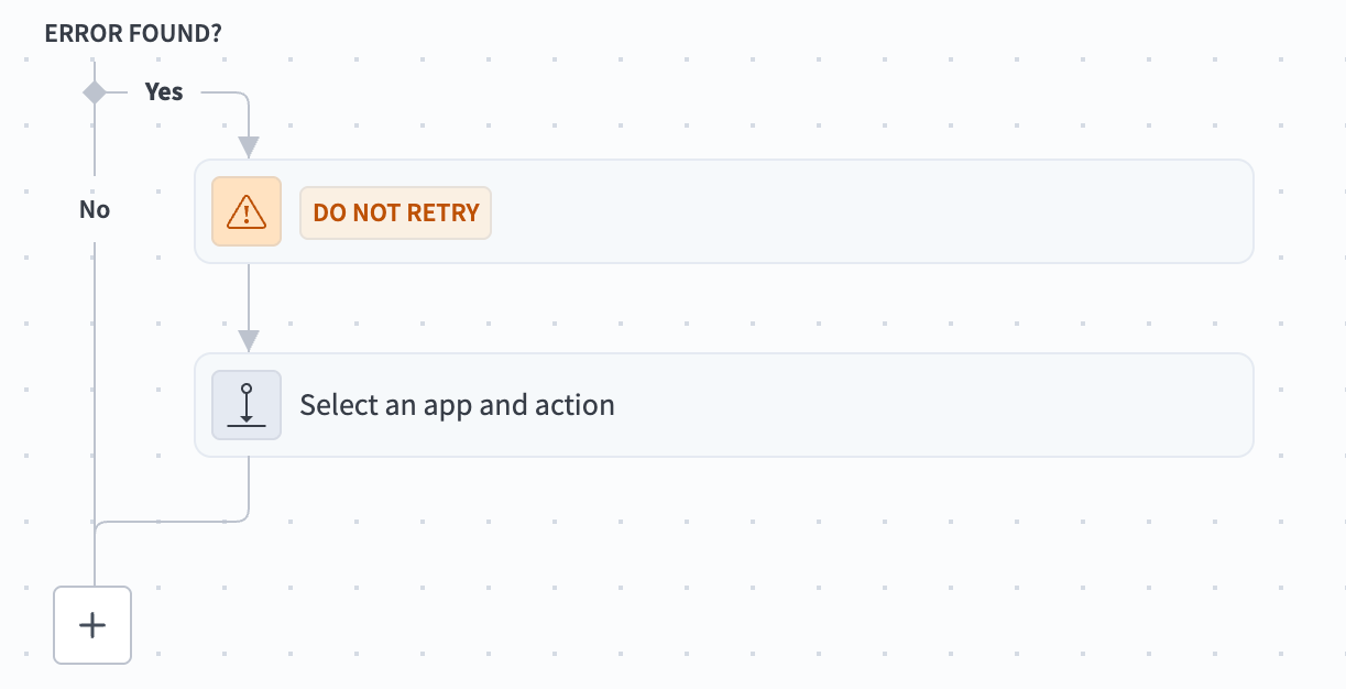

Configure your ERROR FOUND? block.
This step defines how the recipe responds if the Expense line action returns an error.
Complete the following steps to configure your ERROR FOUND? block:
Go to the ERROR FOUND? block and confirm that the Yes branch shows DO NOT RETRY. This option is typically set by default.
ERROR FOUND? block
Go to the Yes branch and click Select and app and action.
Search for and select Workato Genie as your app.
Select Return response to genie as your action.
Map the Error typeStep 4 datapill to the Type field.
Map the Error messageStep 4 datapill to the Description field.
Map the error information
Click Save.
