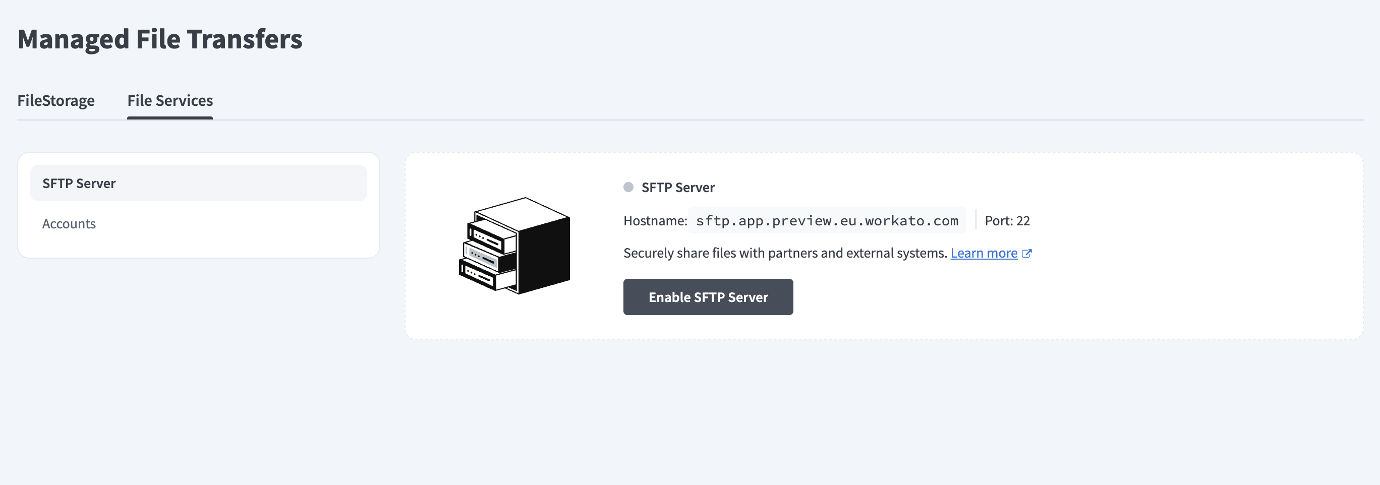

Go to Platform > Managed File Transfer > File Services > SFTP server.
Click Enable SFTP server.
Enable SFTP server

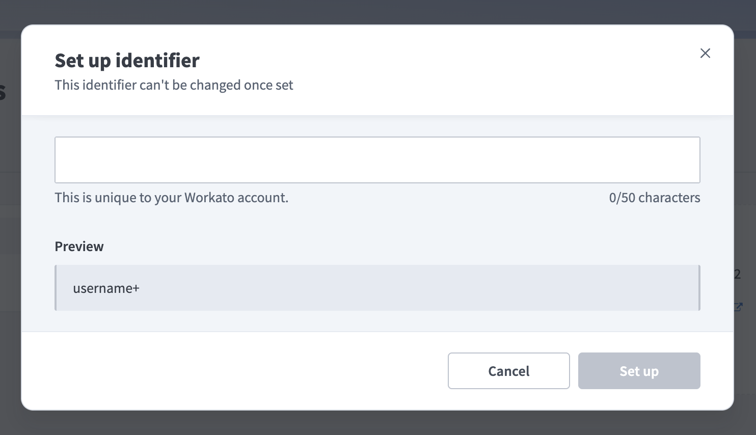

Enter a unique workspace identifier in the Set up identifier dialog. This identifier is permanent and must be unique within your Workato workspace.
Set up workspace identifier
The preview shows the final identifier format.
Click Set up to confirm and save your identifier.

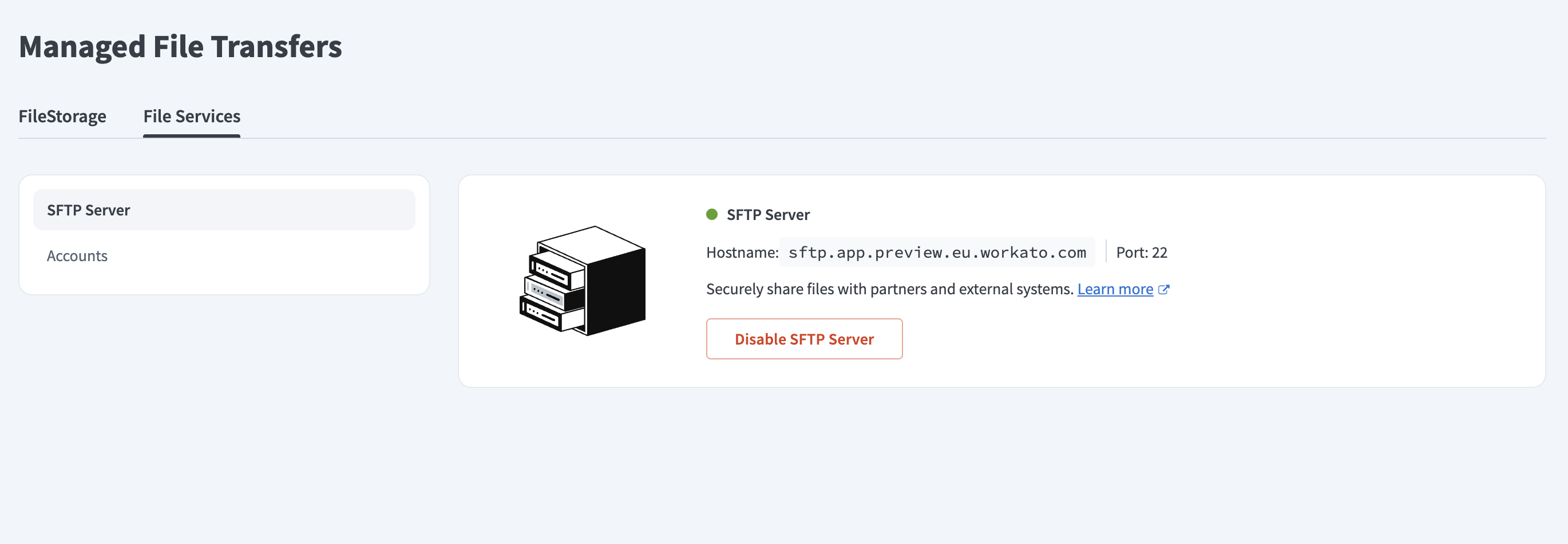

Enabled SFTP server
The server is enabled immediately, and the connection details, including hostname and port, display on the page.

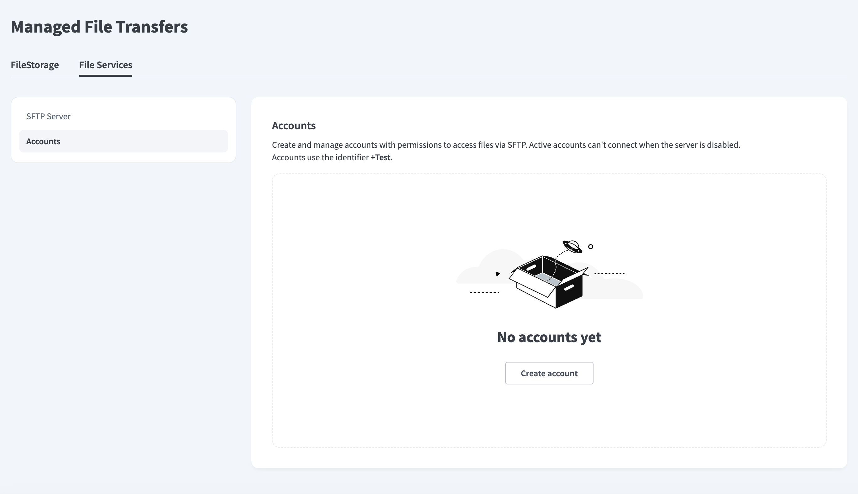

Go to Platform > Managed File Transfer > File Services > Accounts.
The Accounts page

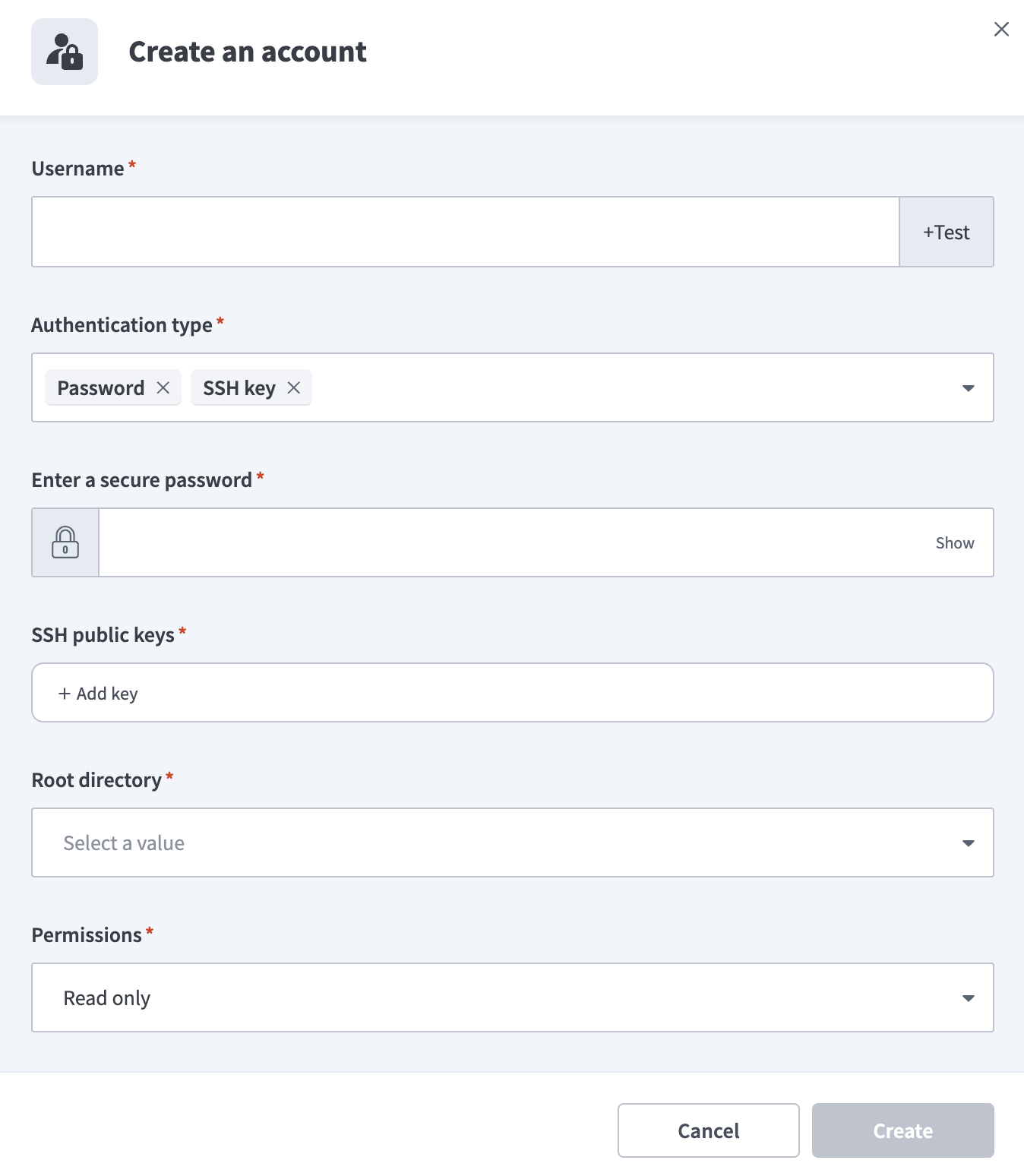

Click Create account. The Create an account modal opens.
Enter a Username for the SFTP account. The username must be between 3 and 32 characters and only use alphanumeric characters. Workato automatically appends your workspace identifier to create the full username. For example: name@workspace-identifier.
Create an account
Use the Authentication type drop-down menu to select one or both authentication methods. Refer to the following tabs for configuration steps for each option:
Use the Root directory drop-down to select a directory. Your selection becomes the user's home directory. Users can't navigate above this directory.
Use the Permissions drop-down menu to select a permission level for the account.
Permission levels
Configure the operations the account can perform using the following permissions levels:
- Read - Download and list files: Users can view folders and download files.
- Create - Upload new files and folders: Users can upload files and create new directories.
- Modify - Edit existing files: Users can overwrite existing files or rename them.
- Delete - Delete files: Users can remove files and folders.
Optional. Use the IP access list to restrict access by IP or country. Click + Add rule to define access rules:
- Set the Action field to Allow or Block
- Use the Filter by field to choose IP address or Country.
- Enter a Value ,such as an IP address (192.168.1.1) or subnet (192.168.1.0/24) in CIDR (Classless Inter-Domain Routing) notation.
Click Create to save the account.
