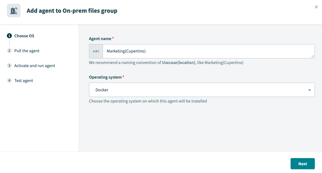

Provide a descriptive agent name in the Agent name field, and select Docker as the operating system (OS) in the Operating system field.
Choose OS Choose OS

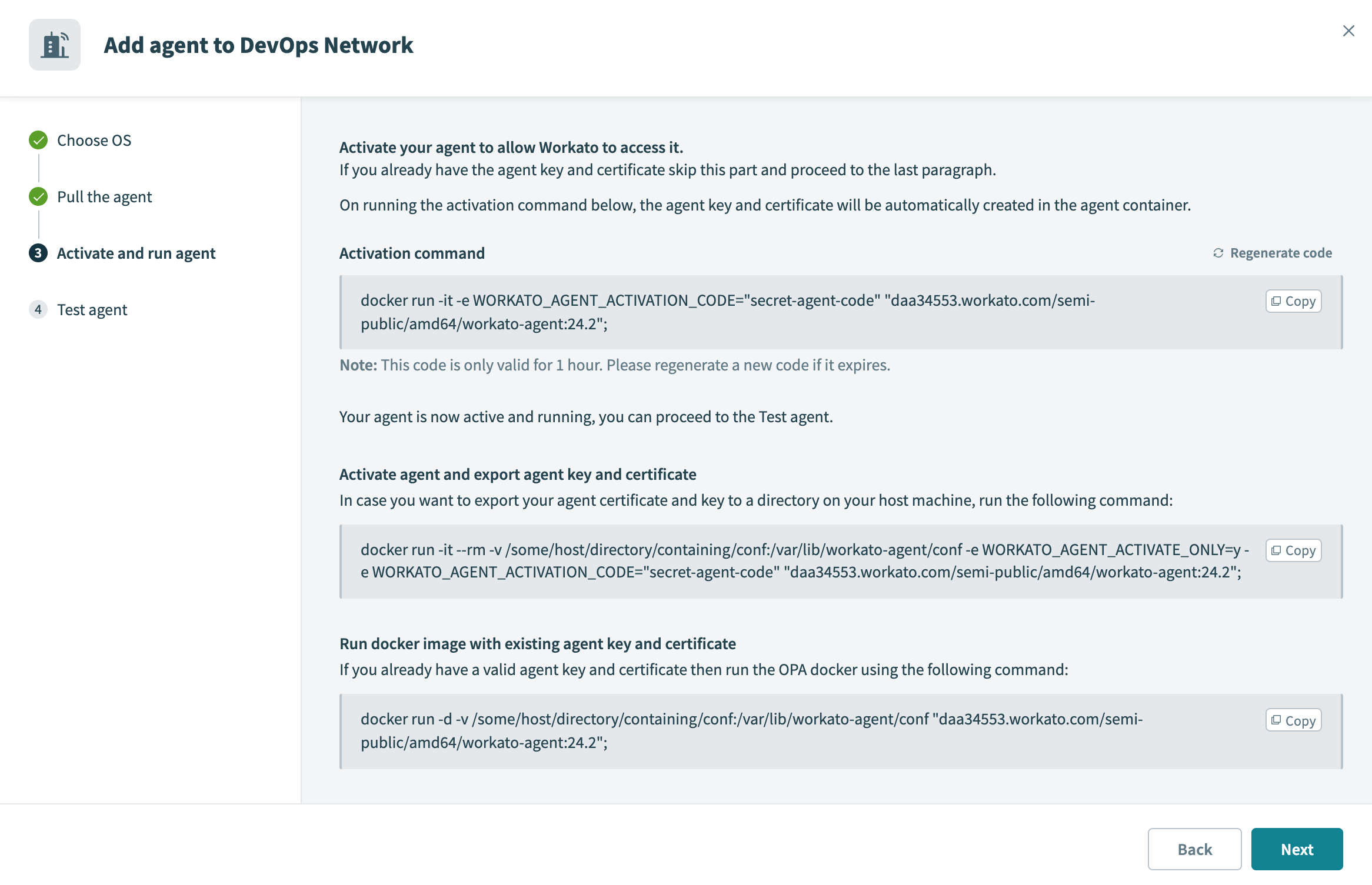

Copy and paste the activation command provided by Workato. The command should look similar to the example below, with "secret-agent-code" replaced by your unique activation code.
Running this command automatically generates the agent key and certificate within the agent container. Note that the activation code is valid for one hour.
docker run -it -e WORKATO_AGENT_ACTIVATION_CODE="secret-agent-code" "daa34553.workato.com/semi-public/amd64/workato-agent:<version>

Activate Activate agent and run docker image

Optional. Run the following command if you plan to export your agent certificate and key to a directory on your host machine:
docker run -it --rm -v /some/host/directory/containing/conf:/var/lib/workato-agent/conf -e WORKATO_AGENT_ACTIVATE_ONLY=y -e WORKATO_AGENT_ACTIVATION_CODE="secret-agent-code" "daa34553.workato.com/semi-public/amd64/workato-agent:<version>";
Optional. If you already have a valid agent key and certificate, run the OPA docker using the following command:
docker run -d -v /some/host/directory/containing/conf:/var/lib/workato-agent/conf "daa34553.workato.com/semi-public/amd64/workato-agent:<version>";
