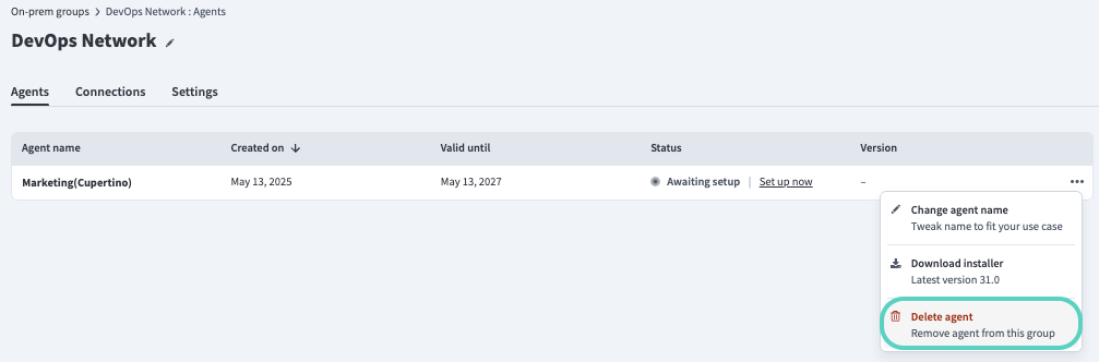

Optional. Go to the old agent's Version column, click ... (ellipsis), and then select Delete agent. Delete agentDelete the old agent.
