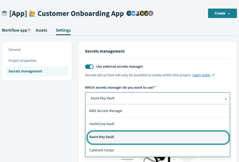

In the project, go to Workspace admin > Settings > External secrets manager.
In the Which secrets manager do you want to use? field, select Azure Key Vault.
Secrets management interface of a project

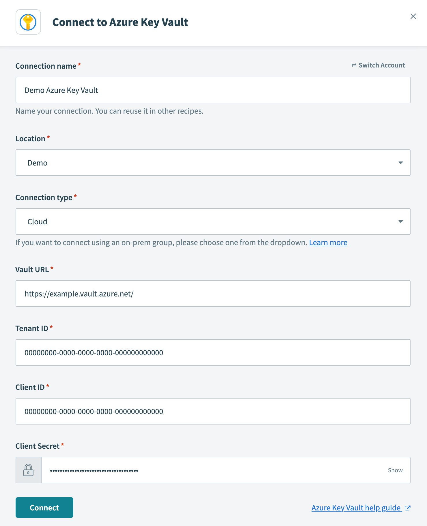

In the Connect to Azure Key Vault modal, select + Create a new connection.
Create a new Azure Key Vault connection
# Connect to Azure Key Vault
Configure Azure Key Vault connection
- Connection name
- Name your Azure Key Vault connection.
- Location
- Select the project or folder to store your Azure Key Vault connection.
- Connection type
- Specify whether this is a cloud or on-prem connection. If you're connecting to an on-prem Azure Key Vault instance, select the appropriate on-prem group from the drop-down menu.
- Vault URL
- Provide the URL of your key vault. Obtain this value by navigating to Azure portal > Key vaults (opens new window). Select the desired key vault and copy the Vault URI shown in the Overview. In our example, we connect to the vault URL
https://example.vault.azure.net/.
- Tenant ID
- Provide the ID of the tenant where your key vault and app registration are located. Azure refers to this as the Directory (tenant) ID. Obtain this value by navigating to Azure portal > App registrations (opens new window). Select your registered application and copy the Directory (tenant) ID shown in the Overview.
- Client ID
- Provide your client ID, which Azure refers to as the Application (client) ID. Obtain this value by navigating to Azure portal > App registrations (opens new window). Select your registered application and copy the Application (client) ID shown in the Overview.
- Client Secret
- Provide your client secret, which Azure refers to as the secret Value. Azure only displays this value when the secret is generated. If you need to generate a new secret, see Registering an application with Microsoft Entra ID, Step 2.

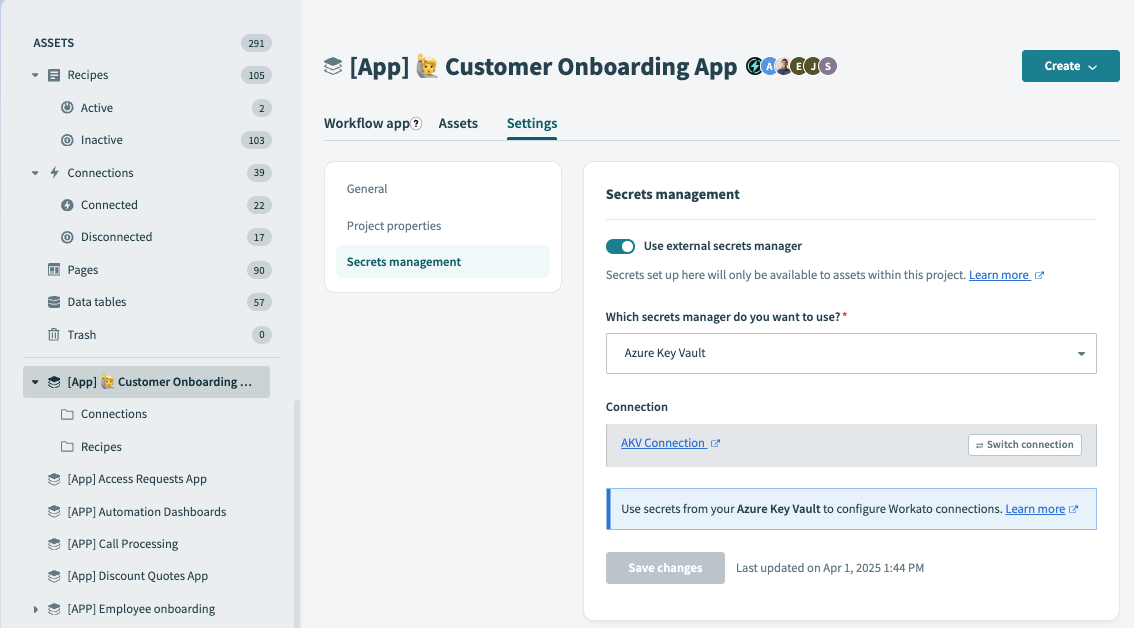

Click Connect. Workato displays the name of the Azure Key Vault connection:
Connection successful
Click Save changes.
