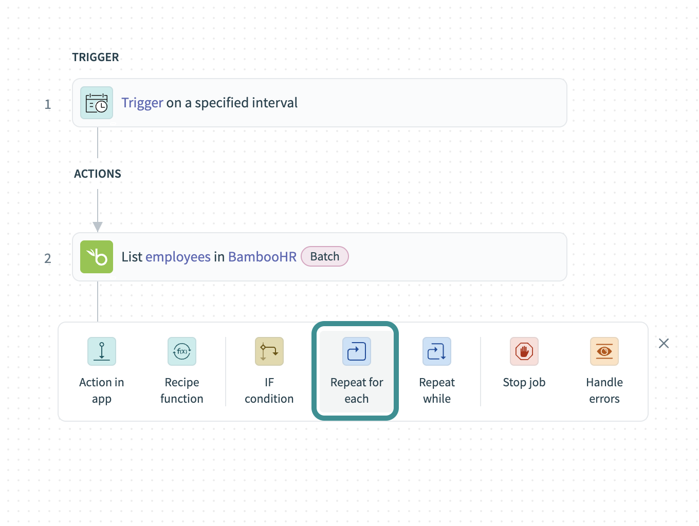

Add a Repeat action to loop through each record that was retrieved by the previous action.
Add a Repeat action Add a Repeat action

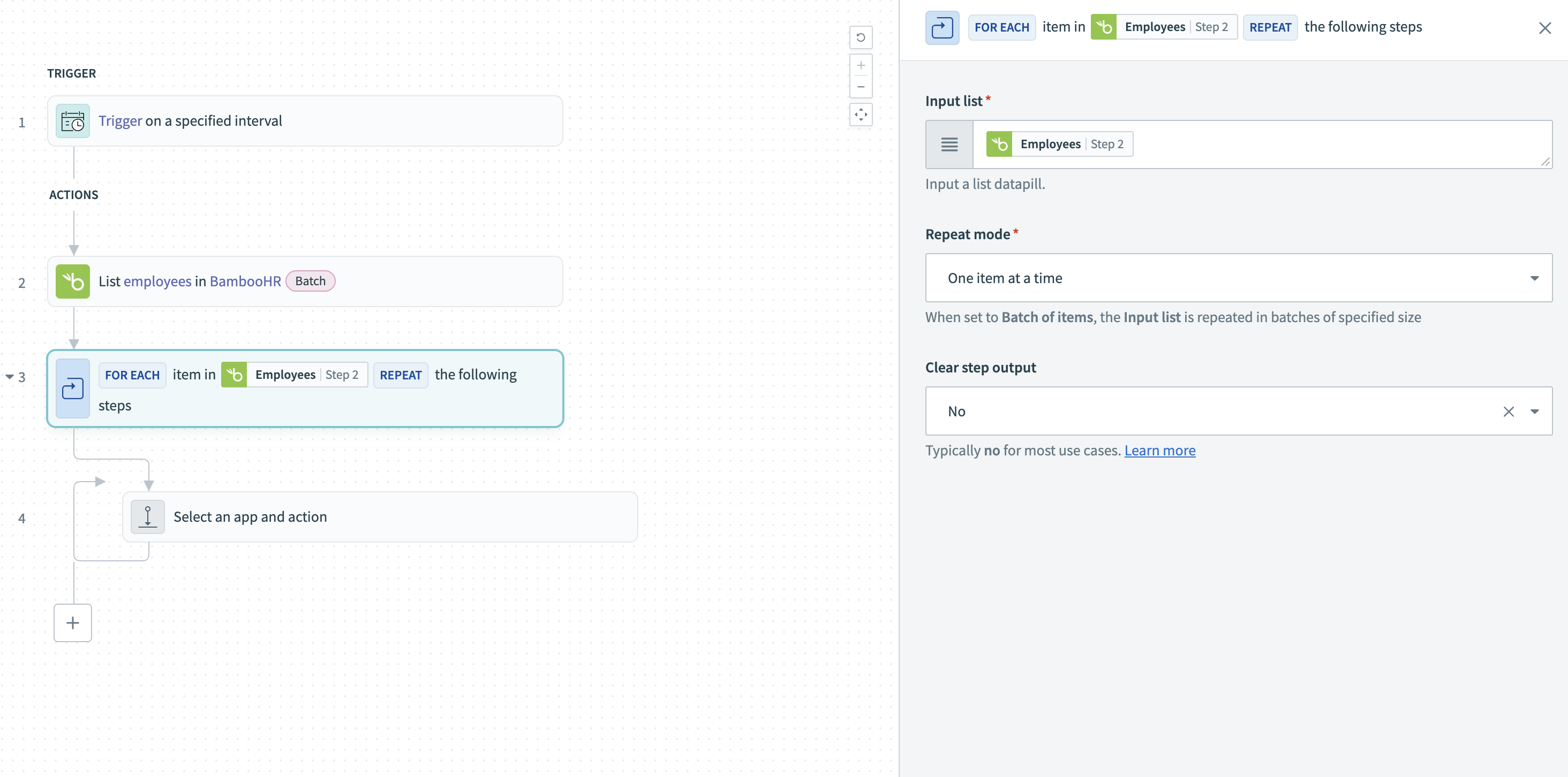

Map a list datapill to the Input list field in the Repeat action. This ensures that the records retrieved in the previous step are processed individually during the loop.
Input a list datapill Input a list datapill
Set the Repeat mode to One item at a time to isolate and check each record individually.

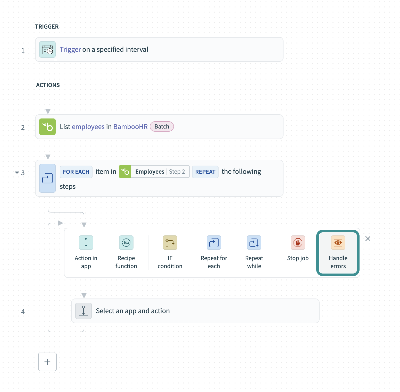

Add a Handle errors step inside the Repeat step to capture any errors triggered by processing a specific record.
Add a Handle errors step Add a Handle errors step

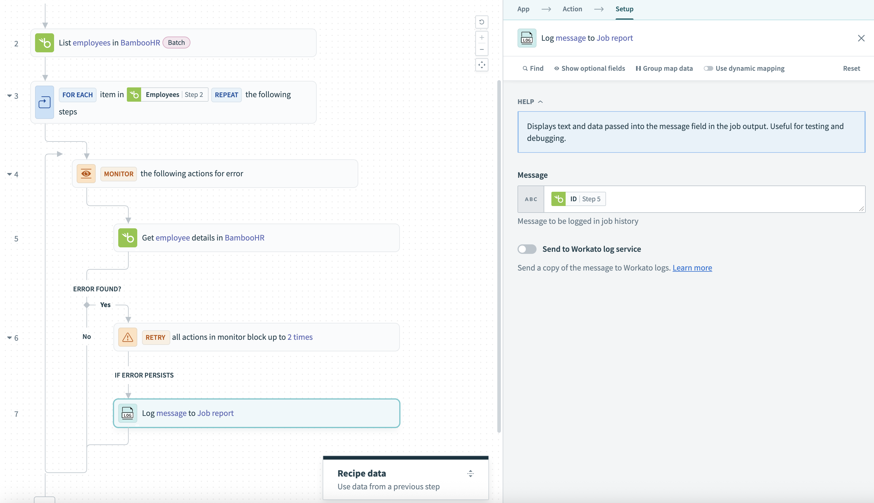

Add an action inside the monitor path to retrieve more details about the record that caused the error. For example, use a Get details action to retrieve more information about the record using its ID.
Add a Logger by Workato action inside the on error path to capture the record ID of the item that triggered the error.
Log the record ID Log the record ID
Run the recipe and review the logs to identify which records returned a 403 Forbidden error and investigate what caused the access issue.
