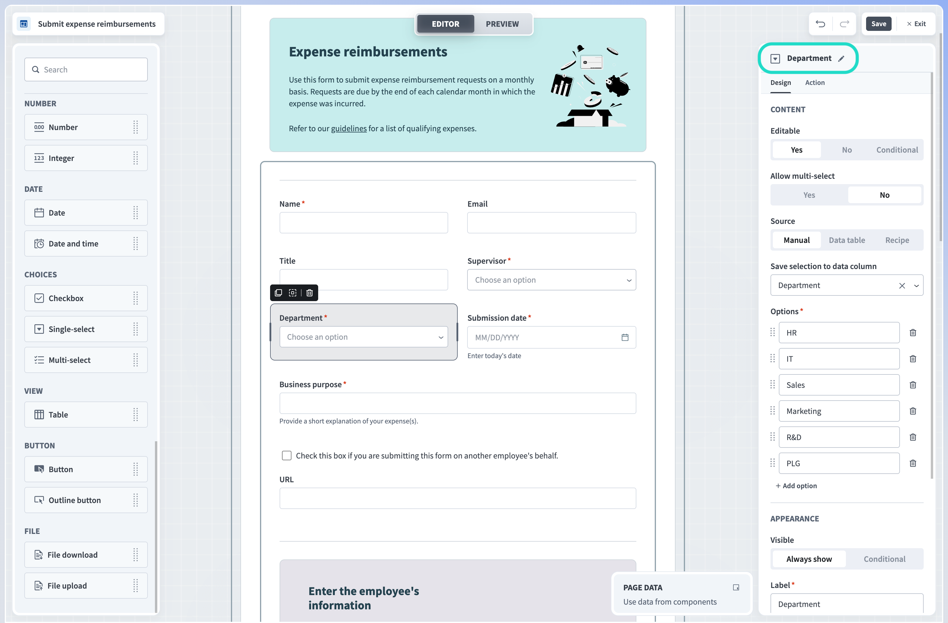

Identify one or more components you plan to prefill.
Identify the Title of the component. This value is distinct from the component Label, which is visible to end-users in the Workflow apps portal. Conversely, the component Title is only visible to builders within Workato and is located in the right column of the page editor.
 Identify the component title
