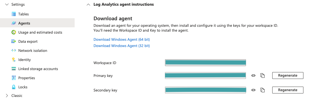

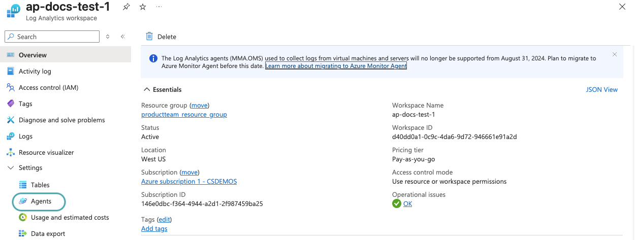

Retrieve your workspace ID and shared key ​
Complete the following steps to retrieve your workspace ID and shared key:
