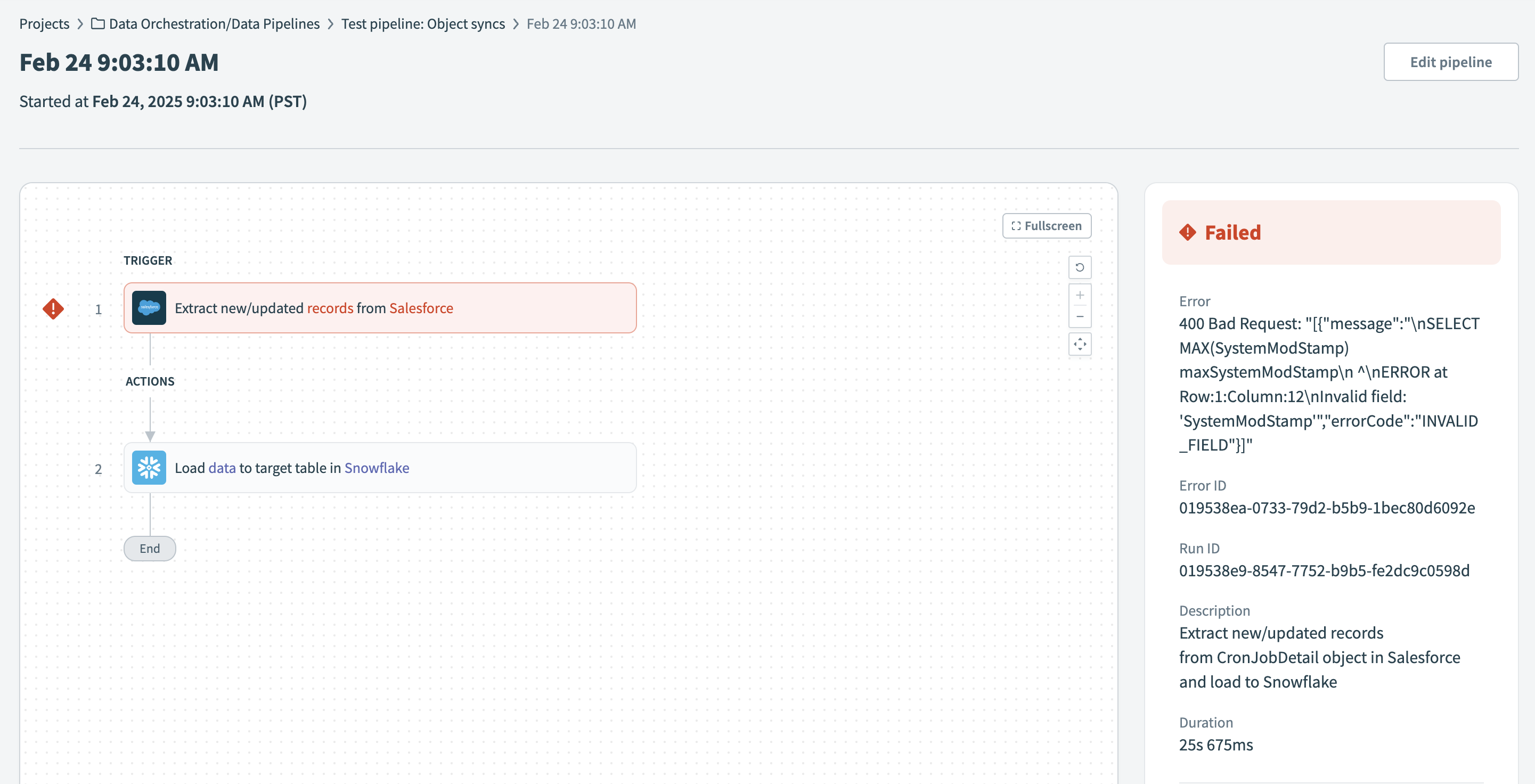

Click a failed run to open its details in the right-hand panel. The panel displays information such as the Error type, Source, Error ID, and Run ID.
View sync error details
