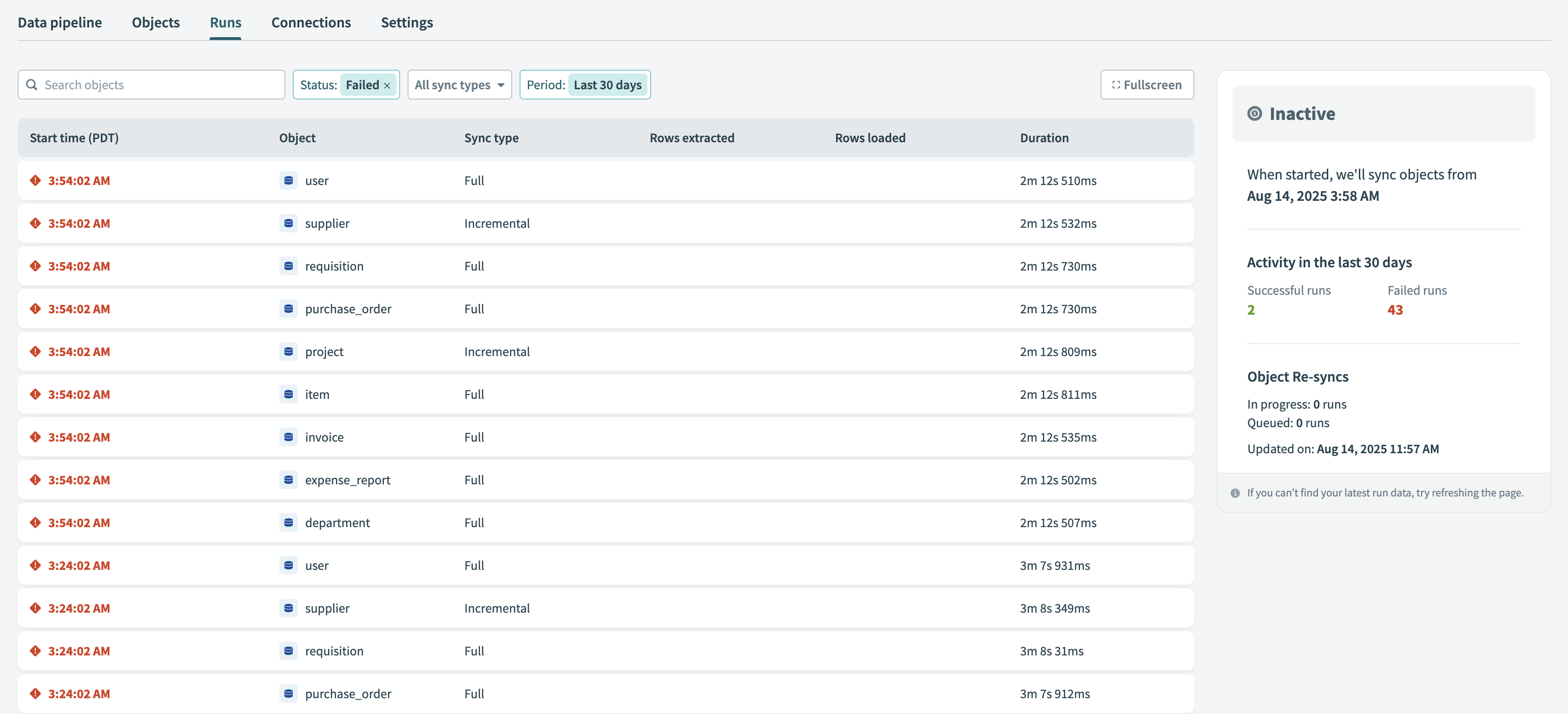

Use the Runs tab to review failed object runs and access detailed error information.
Complete the following steps to locate and investigate a failed run:
Click the Runs tab to view a list of object runs and their statuses.
Runs tabRuns tab
Filter the table by Failed status to find unsuccessful runs.
Runs tabFilter runs
Click a failed run to open its details in the right-hand panel. The panel displays information such as the Error type, Source, Error ID, and Run ID.
View sync errorView sync error details
