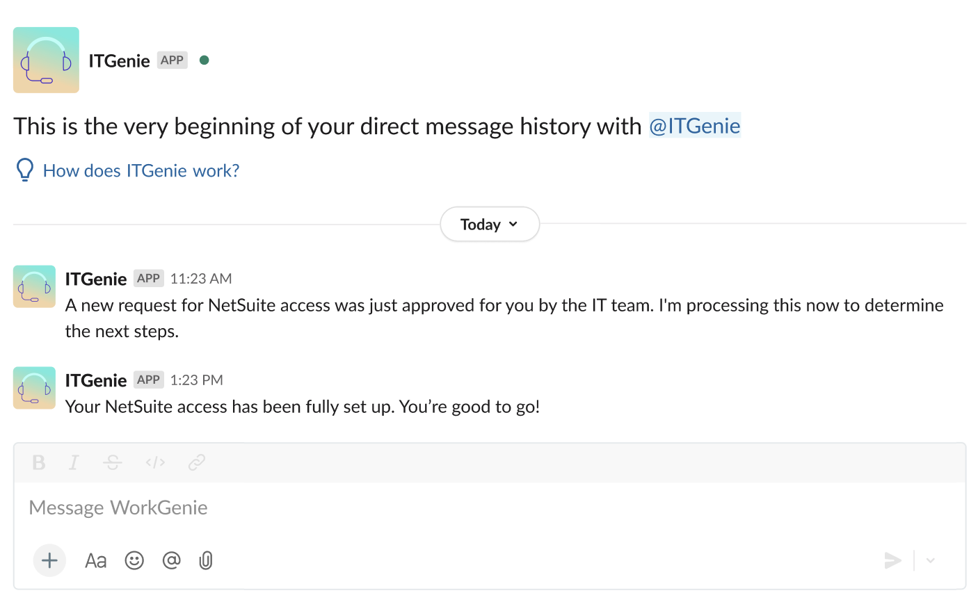

For example, ITGenie receives a notification that a new request for NetSuite access was just approved for you by the IT team. ITGenie automatically processes this app event to determine if next steps are required.
App event exampleApp event example

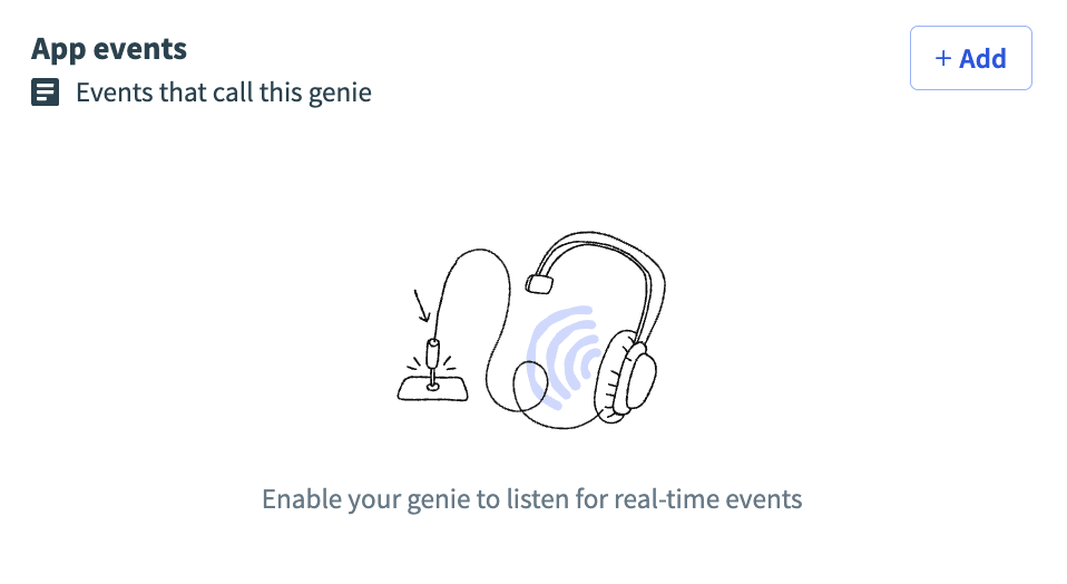

Select the genie where you plan to add an app event.

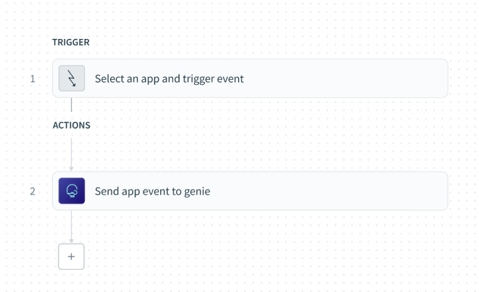

You can create a dedicated recipe from the genie editor, or add the action to an existing recipe.

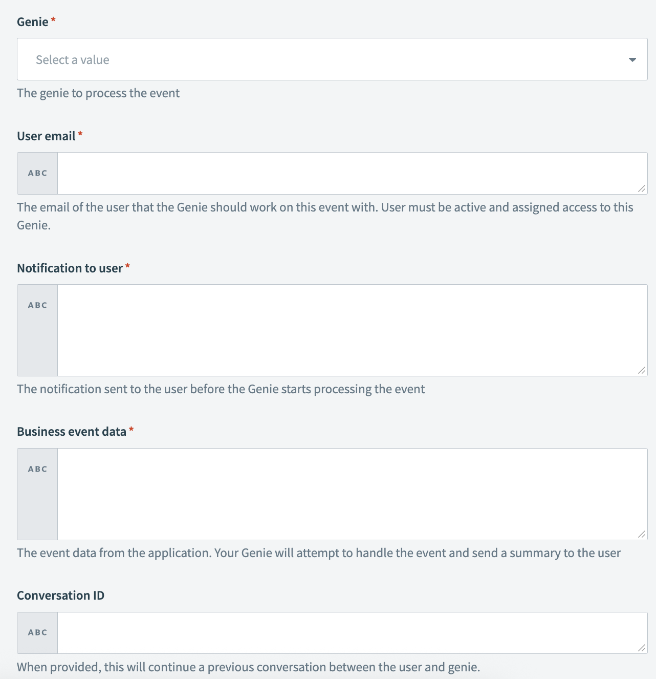

Complete the following steps to configure the Send business event action:
Click the Send business event action.
Ensure that the correct genie is selected in the Genie field.
Send business event action setupSend business event action setup
Enter the email of the user who should receive notification in the User email field.
USER ACCESS
The user you select must be active and have assigned access to this genie.
Go to the Notification to user field and enter the notification you plan to send before the genie starts processing the event.
Go to the Business event data field and enter a prompt to tell the genie what it should do. For example:
plaintext
Complete the following steps to process this lead:
- Search Salesforce for leads and then create or update the lead.
- Search Salesforce for matching accounts. Create or update the account and attach the lead.
- Research the company and lead on the internet.
- Provide a summary for the SDR by adding it to the lead in Salesforce.
- Prepare an agenda for the prospective call for the SDR.
Optional. Enter the conversation ID in the Conversation ID field if you plan to enable the genie to continue a previous conversation with the user.
