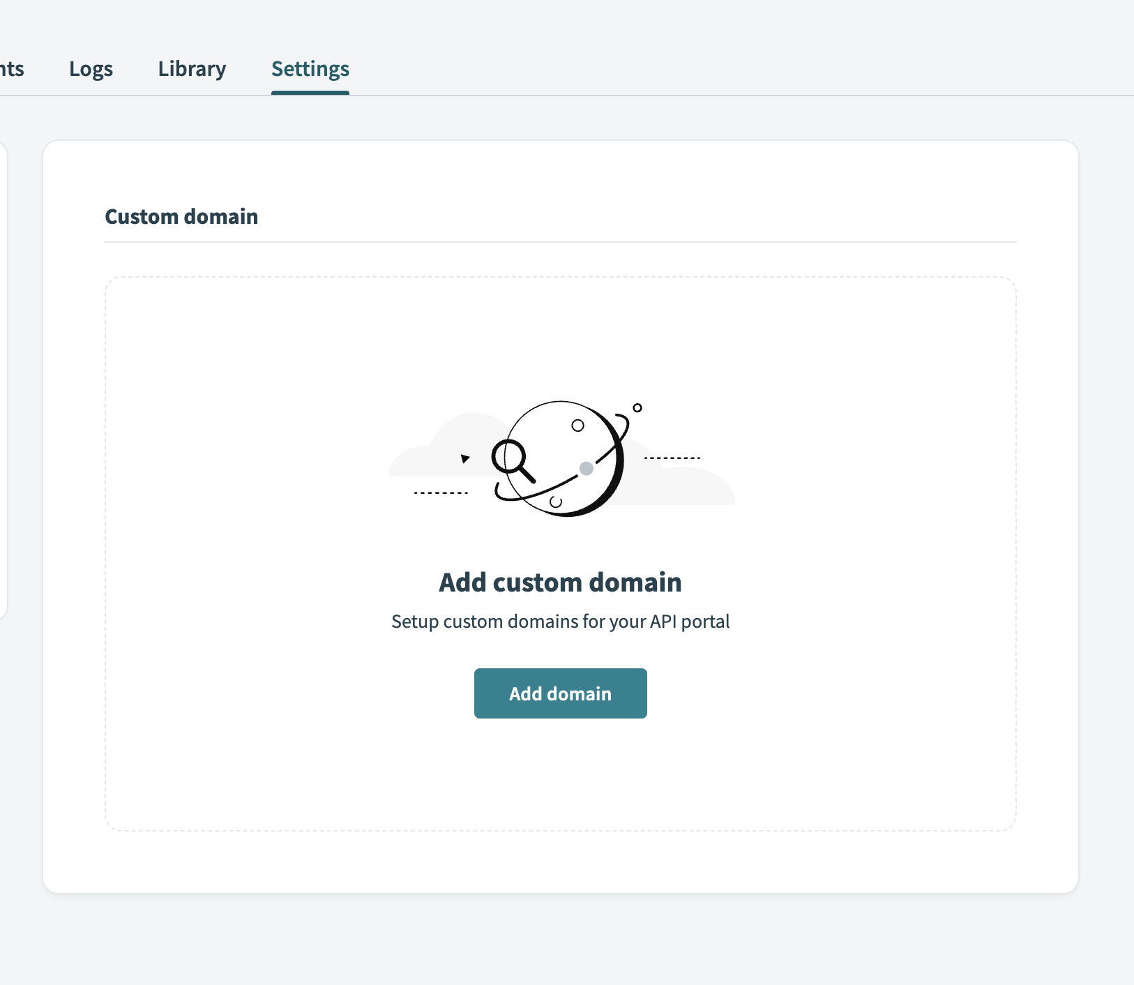

Go to Platform > API platform > Settings > Developer Portal > Custom domain.
Click Add domain.
Add custom domainAdd custom domain

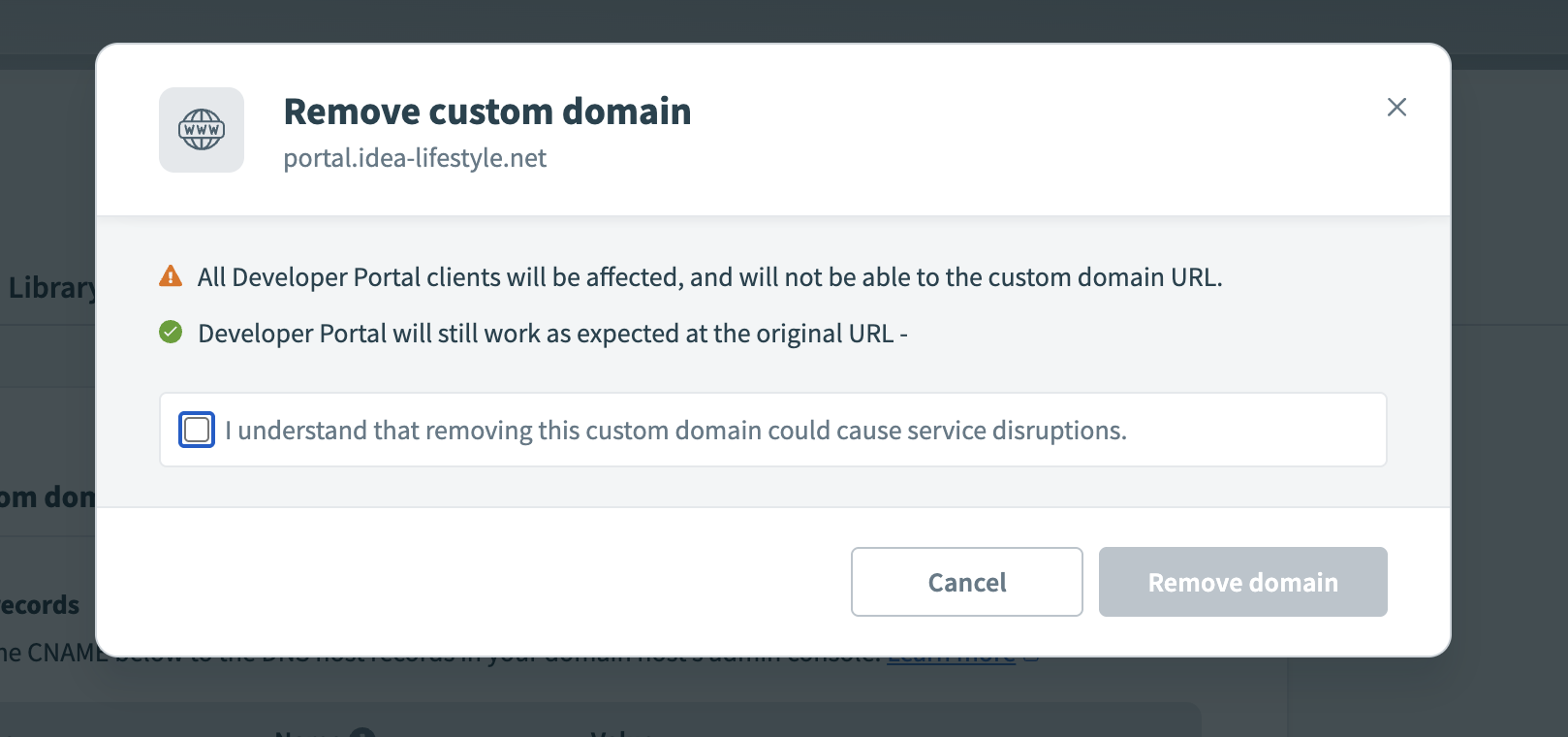

Remove a custom domain
Complete the following steps to remove a custom domain:
Click Remove next to the custom domain entry.
Confirm the action in the modal dialog to revert to the default Workato domain.
Remove custom domainRemove custom domain
