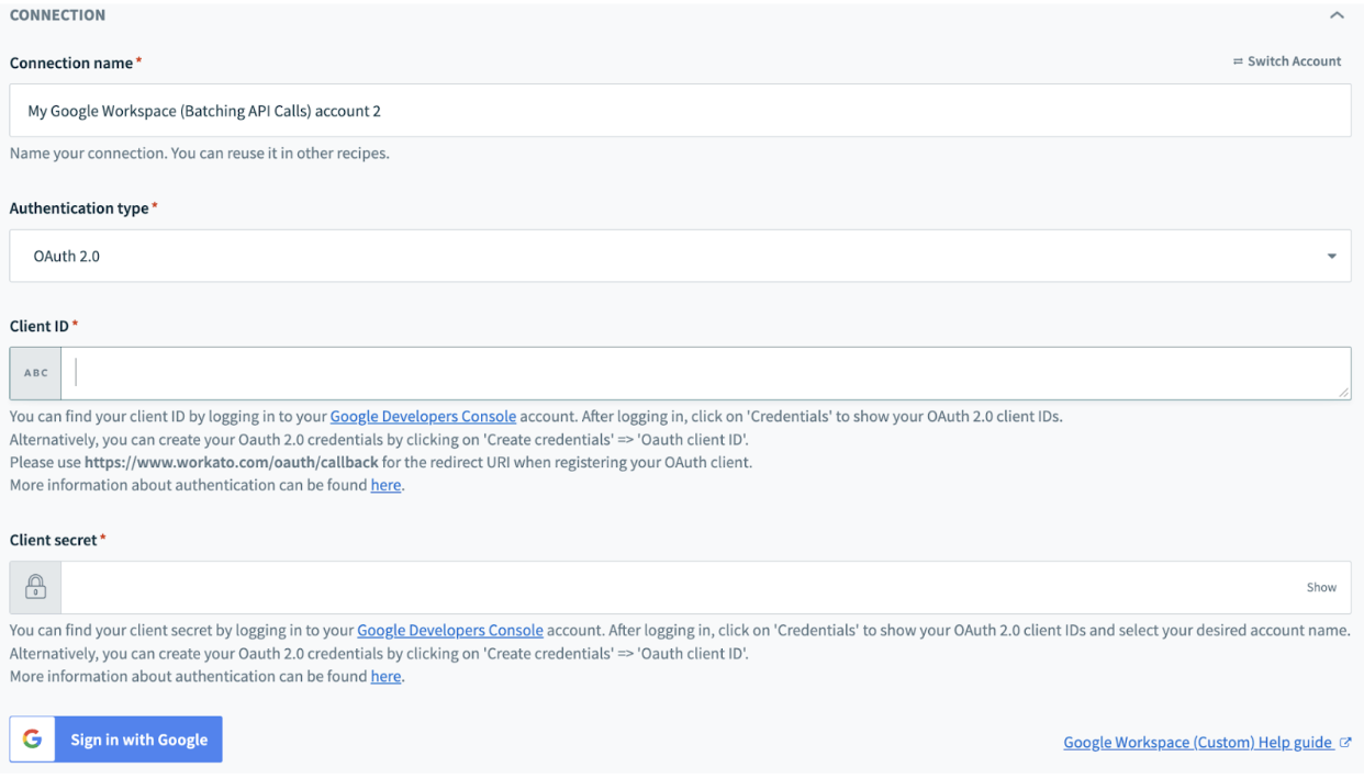

# OAuth 2.0
Complete the following steps to establish a connection to the Google Workspace custom connector using OAuth 2.0 authentication:
Search for and select Google Workspace (Custom) as your connection on the New connection page.
OAuth Connection Setup
Select OAuth 2.0 as the Authentication type.
Enter the Client ID and Client secret from your Google Cloud project.
Click Sign in with Google.
Select your Google account and grant the required permissions.

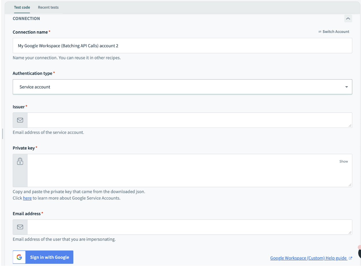

# Service account
Complete the following steps to establish a connection to the Google Workspace custom connector using service account authentication:
Service Account Connection Setup
Select Service account as the Authentication type.
Enter the email address of the service account in the Issuer field.
Enter the private key from your downloaded JSON key in the Private key field.
Enter email address of the user to impersonate in the Email address field.
