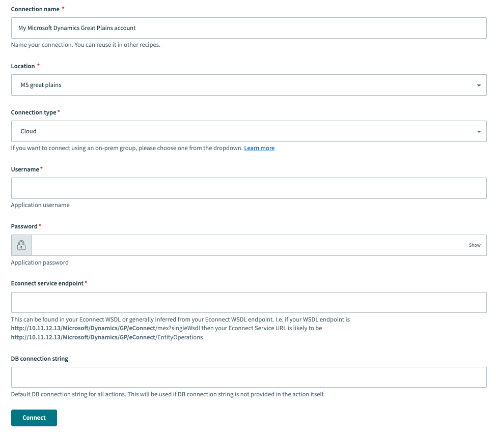

Search for and select Microsoft Dynamics Great Plains as your connection in the New Connection page.
Provide a Connection name that identifies which Microsoft Dynamics Great Plains instance Workato is connected to.
Microsoft Dynamics Great Plains Connection
Select your Connection type from the drop-down menu.
Provide the Windows domain user's Username and Password. Ensure the domain user has access to the Microsoft Dynamics GP SQL Server database machine. The user name must be configured in the SQL Server database and granted the DYNGRP security role.
Provide the Econnect service endpoint, which you can find in your Econnect WSDL or infer from your Econnect WSDL endpoint. For example, if your WSDL endpoint is http://10.11.12.1/Microsoft/Dynamics/GP/eConnect/mex?singleWsdl, then your Econnect Service URL is likely http://10.11.12.1/Microsoft/Dynamics/GP/eConnect/EntityOperations.
ON-PREM CONNECTIVITY
Set the Econnect service endpoint URL to the internal domain name (localhost) or internal IP address for on-prem connections.
Provide the DB connection string for all actions. This will be used if the DB connection string is not provided in the action itself, for example: Integrated Security=true;Persist Security Info=false;Database=WORKATO;Data Source=EC2AMAZ-DEMO\SQLEXPRESS
Click Connect to establish the connection.
