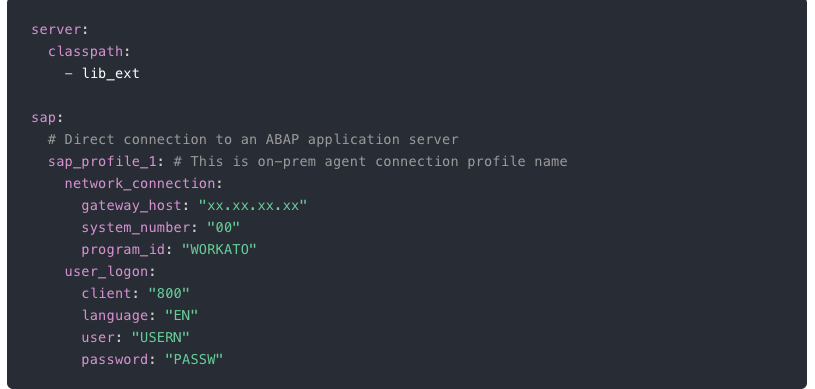

Verify that the config.yml file includes lib_ext in the classpath. For example:
server:
  classpath:
    - lib_ext
Ensure proper indentation and formatting in your config.yml. Check the YAML indentation in your config.yml. If the formatting is incorrect, the agent may fail to load the SAP profile. For example:
Proper file indentationProper file indentation
