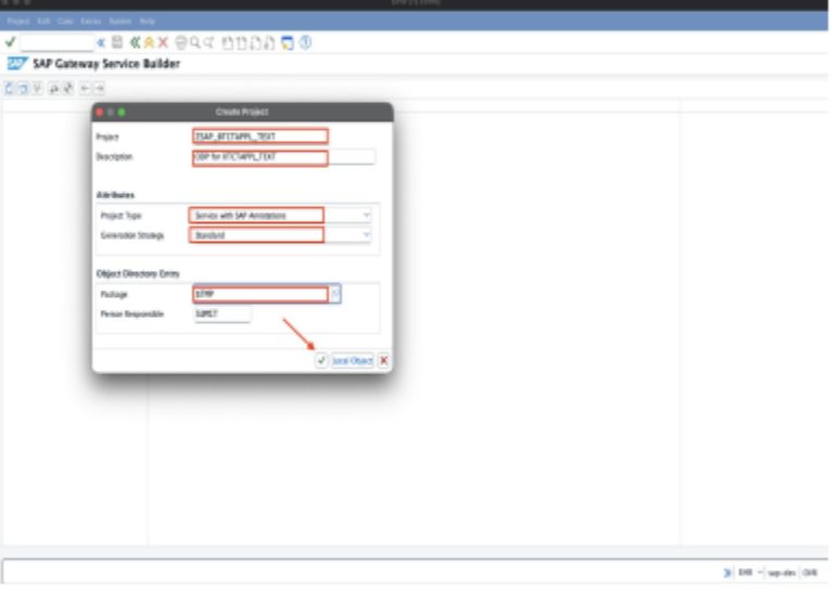

Complete the following steps to create a project in the SAP Gateway Service Builder:
Go to transaction code SEGW.
Click Create Project.
Enter a name for the project in the Project field and a description in the Description field. For example, ZSAP_0TCTAPPL_TEXT and ODP for 0TCTAPPL_TEXT.
Use the Project Type drop-down menu to select Service with SAP Annotations.
Use the Generation Strategy drop-down menu to select Standard.
Enter the package in the Package field, then save the project.

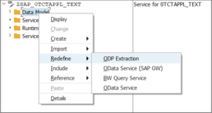

Complete the following steps to assign the ODP data source to the project:

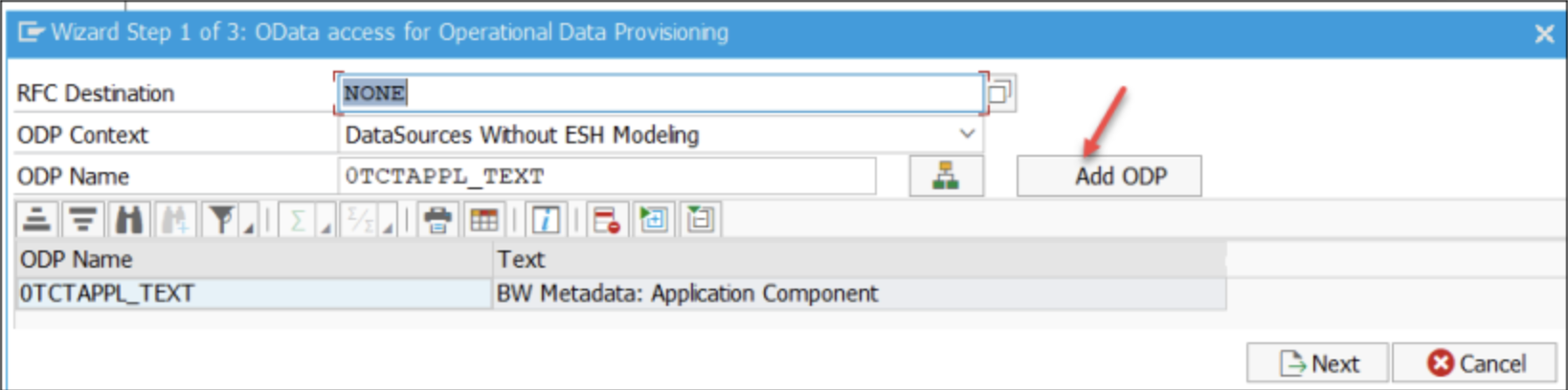

Right-click Data Model in the project tree and select Redefine > ODP Extraction.
Redefine the serviceRedefine the service
Enter NONE in the RFC Destination field.
Use the ODP Context drop-down menu to select the context of the data source. For example, DataSources Without ESH Modeling.
Enter the data source name in the ODP Name field and click Add ODP. Record this value as the ODP name. For example, 0TCTAPPL_TEXT.
Add ODPAdd ODP
Click Next.

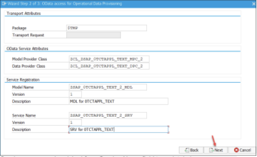

Review the transport, OData service, and service registration attributes. Record the value in the Service Name field. For example, ZSAP_0TCTAPPL_TEXT_2_SRV.
Review attributesReview attributes
Click Next.

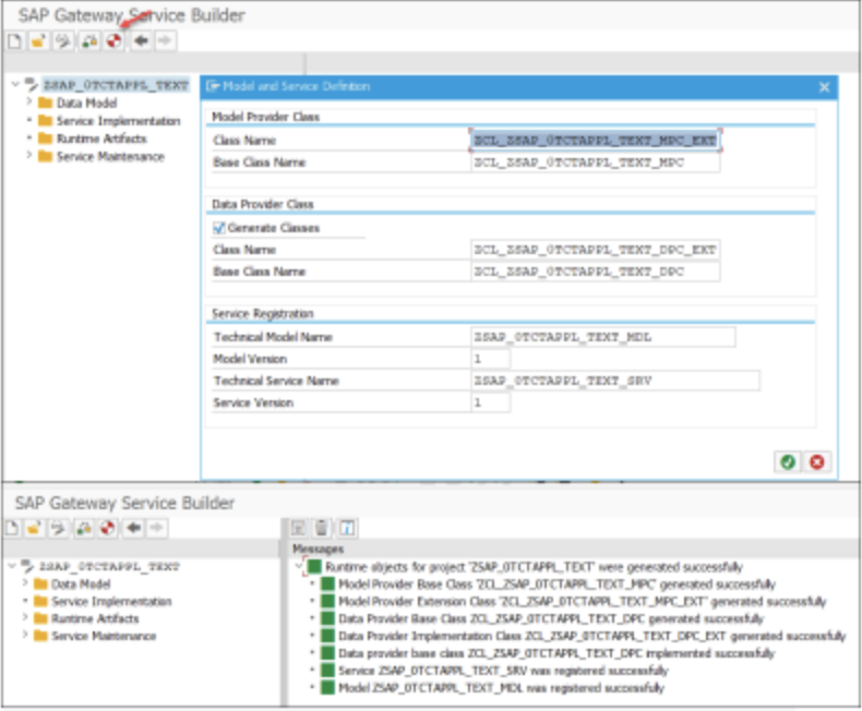

Complete the following steps to generate the required classes for the project:
Select the project and click Generate Runtime Objects.
Review the model provider class, data provider class, and service registration names in the Model and Service Definition dialog.
Generate required classesGenerate required classes
Confirm the dialog. SAP generates the runtime objects and registers the service and model.

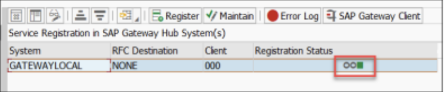

Complete the following steps to register the service in the SAP Gateway hub:
Expand Service Maintenance in the project tree and select GATEWAYLOCAL.
Click Register > Register Service.
Confirm that the Registration Status shows green.
Service registration with green registration statusService registration with green registration status
