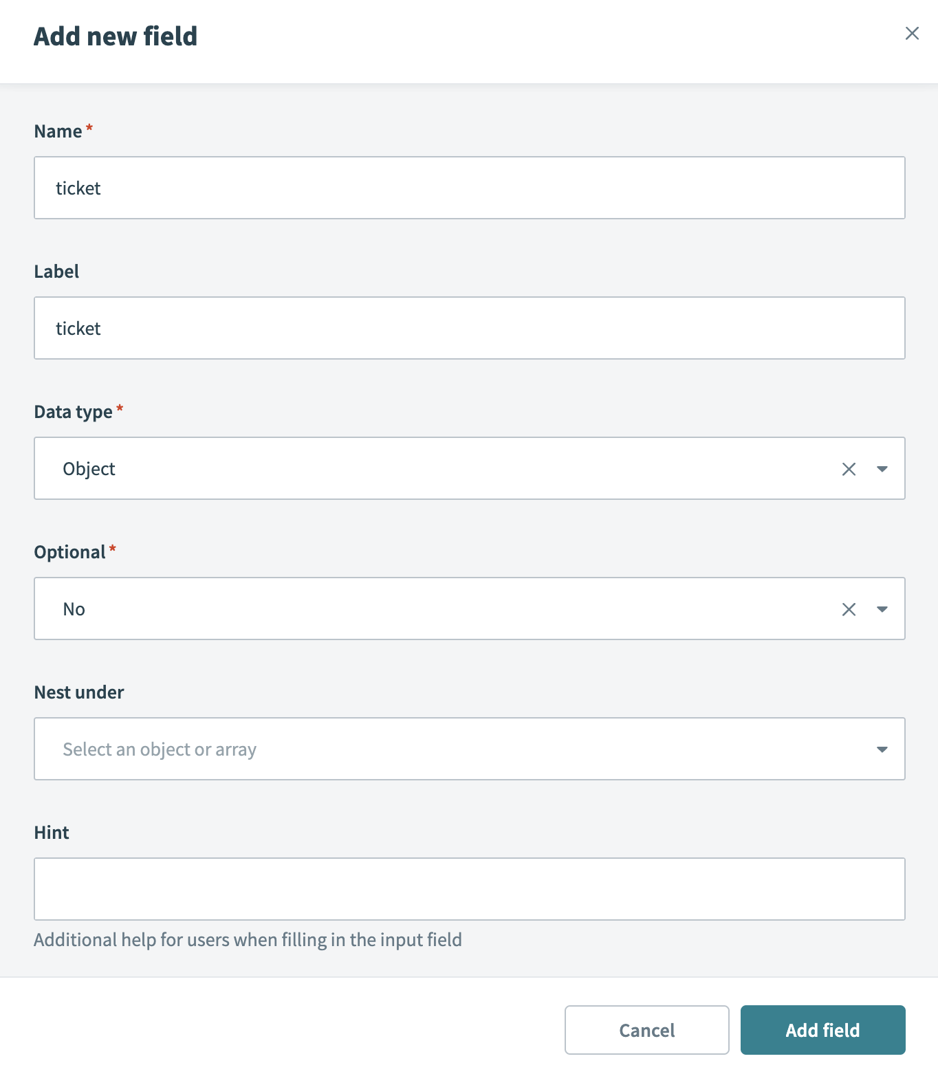

Go to the Request schema section and click add fields manually.
Enter ticket in the Name and Label fields.
Use the Data type drop-down menu to select Object.
Use the Optional drop-down menu to select No.
Click Add field.
Ticket objectTicket object

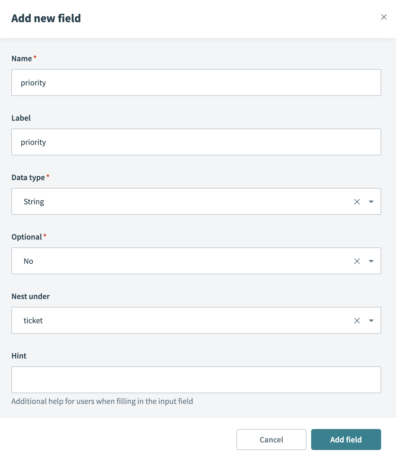

Return to the Request schema section and click + Add field.
19
Enter priority in the Name and Label fields.
20
Use the Data type drop-down menu to select String.
21
22
Use the Nest under drop-down to select ticket.
23
Click Add field.
24

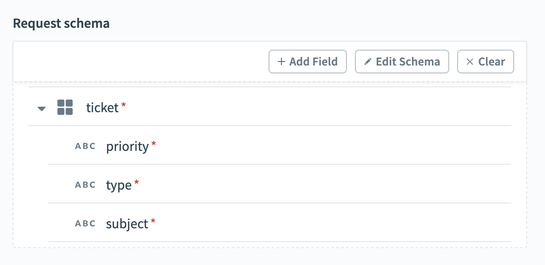

Click Save.
Configured request schemaConfigured request schema

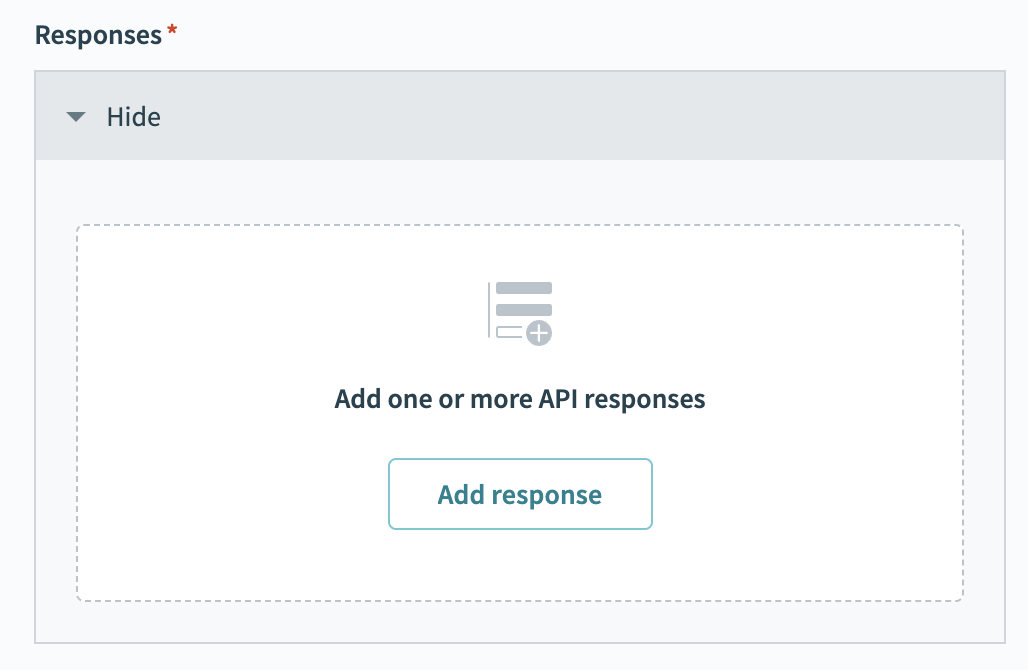

Go to the Responses section and click Add response.
Add responseClick Add response

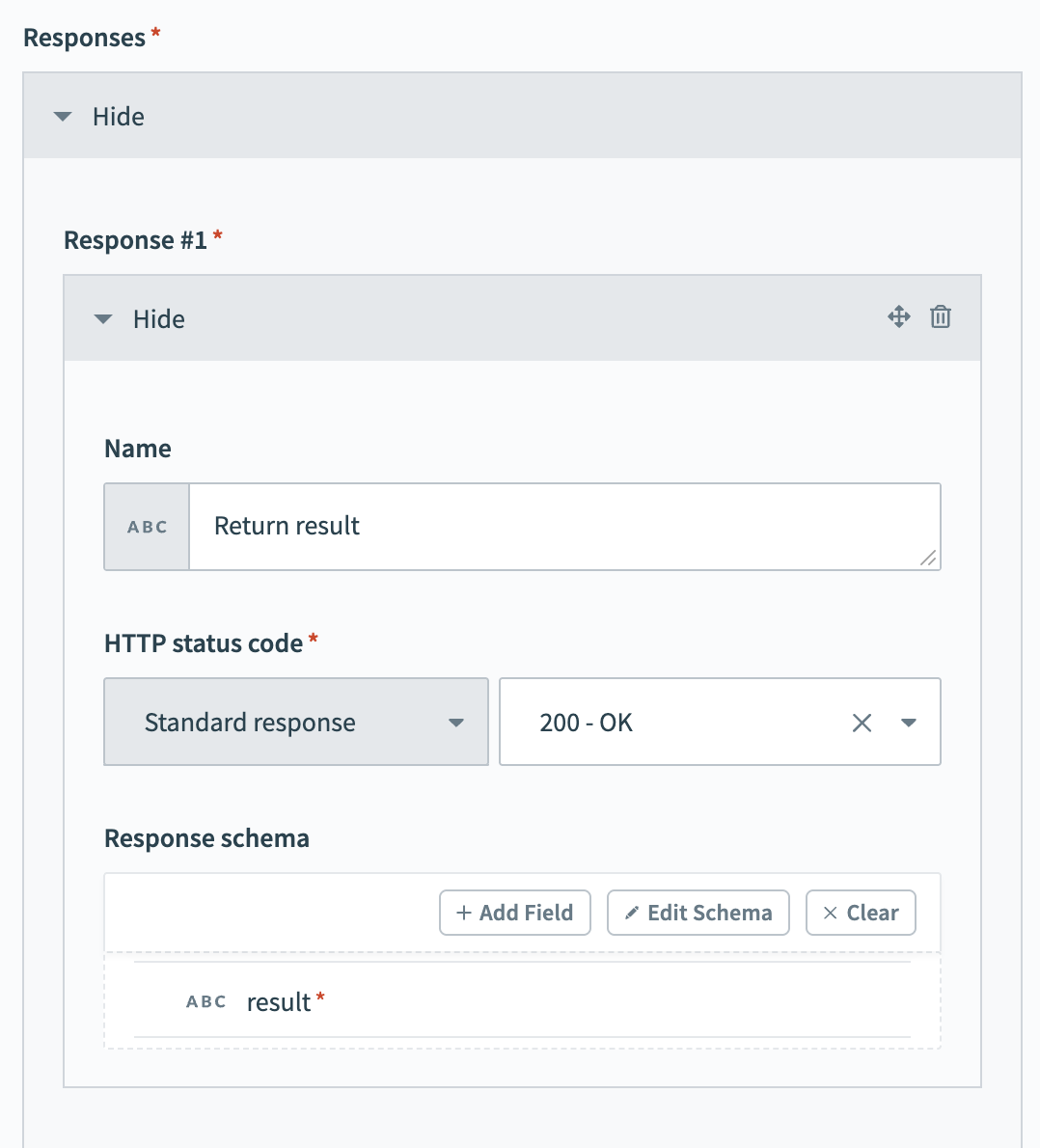

Enter Return result in the Name field.
Use the HTTPS status code standard response drop-down menu to select 200 - OK.
Go to the Response schema section and click add fields manually.
Enter result in the Name and Label fields.
Set Data type to String and Optional to No.
Click Add field.
Configured responseConfigured 200 - OK response

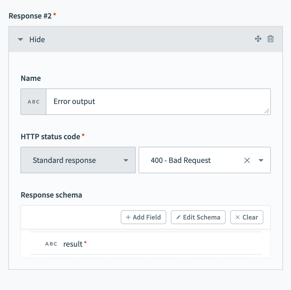

Click + Add response again.
Enter Error output in the Name field.
Use the HTTPS status code drop-down menu to select 400 - Bad Request.
12
13
14
Click Add field.
Configured responseConfigured 400 - Bad Request response

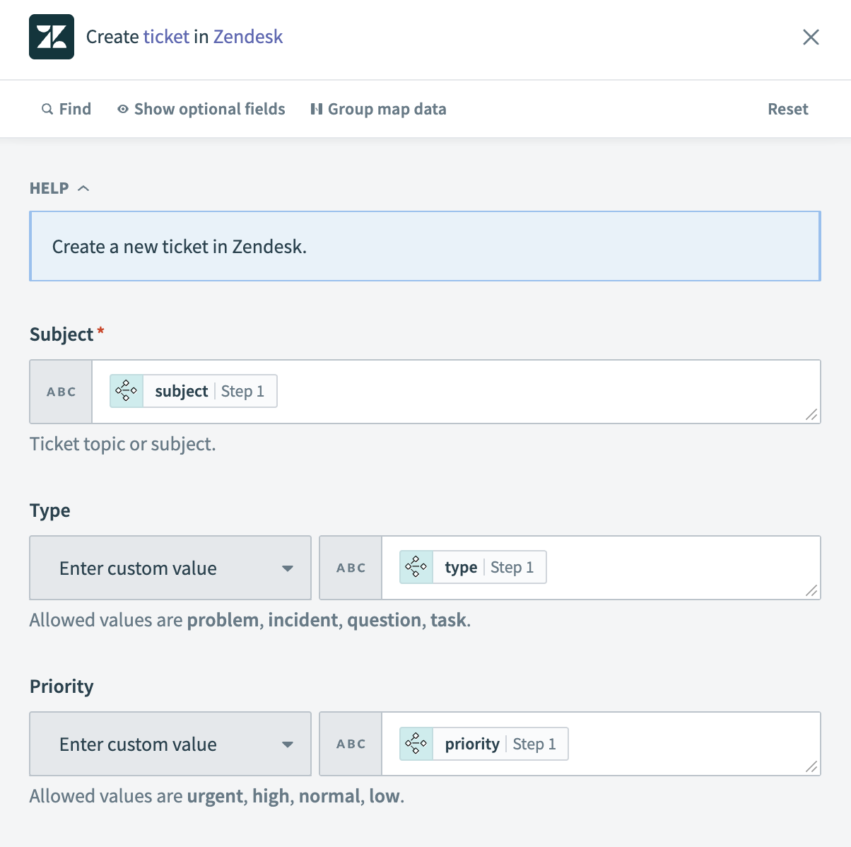

Set up your Zendesk create ticket action
# Set up your Zendesk create ticket action
This step adds a new ticket to Zendesk using the data from your API request.
Click + Add step.
Search for and select Zendesk.
Select Create ticket as the action.
Map the subject Step 1 datapill to the Subject field.
Map the type Step 1 datapill to the Type field.
Map the Priority Step 1 datapill to the Priority field.
Click Save.
Configured responseCreate ticket action

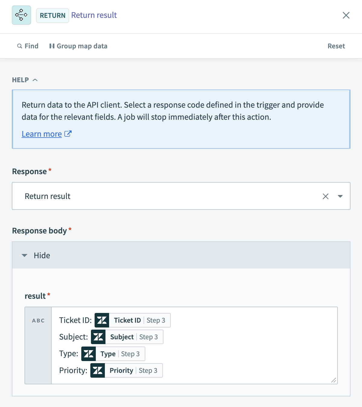

Go to the No branch and click the + Add step button.
Search for and select API platform by Workato as your app.
Select Respond to API request as your action.
Use the Response drop-down menu to select Return result.
12
Expand the Response body section.
13
Map the Ticket ID Step 3 , Subject Step 3 , Type Step 3 , and Priority Step 3 datapills to the result field.
Map datapill to result fieldMap the result datapills to the result field.

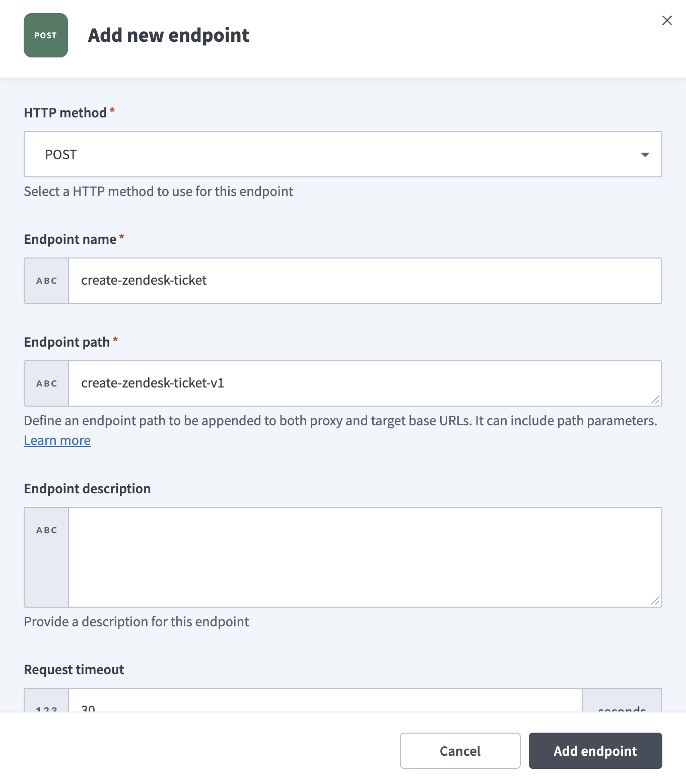

Create an endpoint
# Create an endpoint
This step connects your API recipe to a new endpoint inside the API collection.
Go to Platform > API platform and open the collection you created in the preceding steps.
Click + New endpoint.
Use the Recipe drop-down to select your Zendesk ticket API recipe.
Use the HTTP method drop-down to select POST.
Enter an endpoint name in the Endpoint name field. For example: create-zendesk-ticket.
Enter a path in the Endpoint path field. For example: create-zendesk-ticket-v1. Don’t include a slash (/) in your endpoint path. This is automatically appended after you create the endpoint.
Optional. Add a description in the Endpoint description field.
Optional. Set a request timeout if needed. Default is 30 seconds.
Click Add endpoint.
Create an endpointCreate an endpoint
