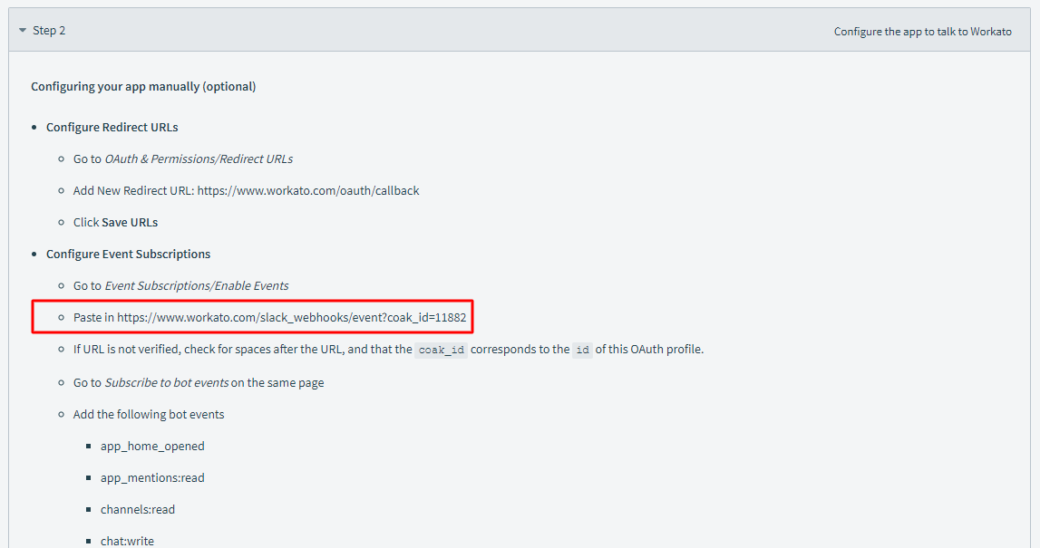

# Custom bot recipe not triggered
You may encounter an error where invoking the command of the custom bot doesn't trigger a recipe.
Follow these troubleshooting methods to resolve the issue:
Go to Tools > Custom OAuth profile and select the profile for your custom bot.
Copy the request URL that contains /actions. For example, ​https://app.workato.com/slack_webhooks/actions?coak_id=9670.
Request URLRequest URL
Ensure that the request URL in the Interactive Components section of your Slack API app matches the one in your Workato custom OAuth profile. Update the configurations to the same request URL if they don't match.
