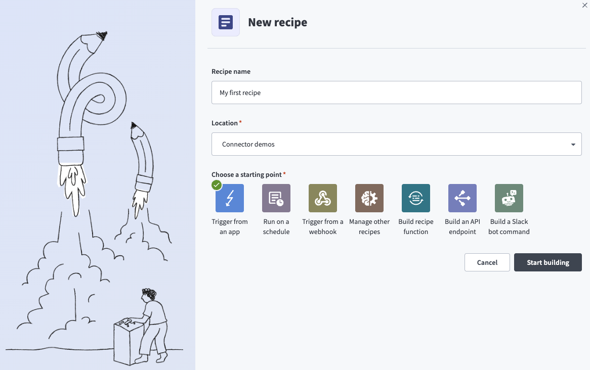

Enter My first recipe in the Recipe name field.
Ensure Trigger from an app is selected as the recipe starting point, then click Start building. Set up your recipe view The Set up your recipe menu
