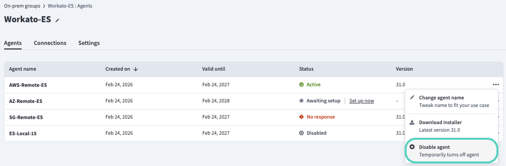

Go to Tools > On-prem groups and select the on-prem group that contains the agent you plan to disable.
Confirm there is an active backup agent in the group to prevent recipe disruption. Refer to Add an agent if you need to create a backup agent.
Go to the agent's Version column and click ... (ellipsis).
Click Disable.
Disable agentDisable an agent in Workato.

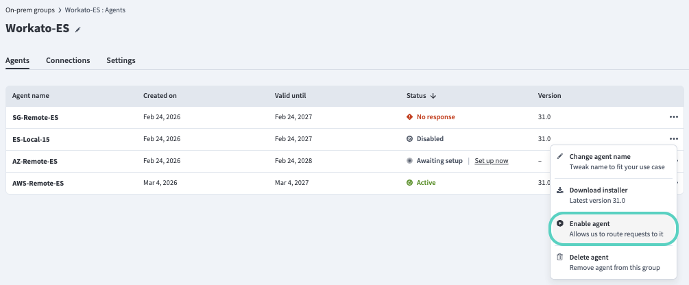

Go to Tools > On-prem groups and select the on-prem group that contains the agent you plan to reconnect.
Go to the agent's Version column, click ... (ellipsis), and then select Enable agent.
Enable on-prem agent

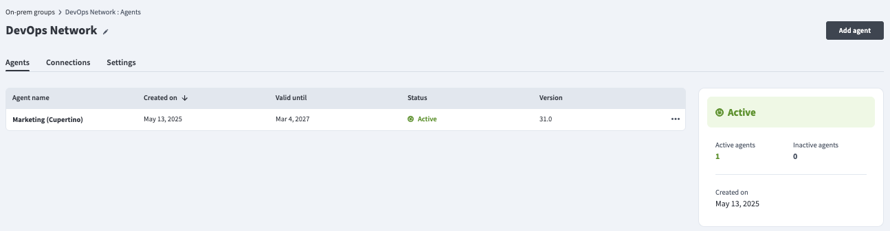

Workato sends a request to your on-prem agent to establish a connection. A successful connection request returns an Active status.
On-prem agent connected
