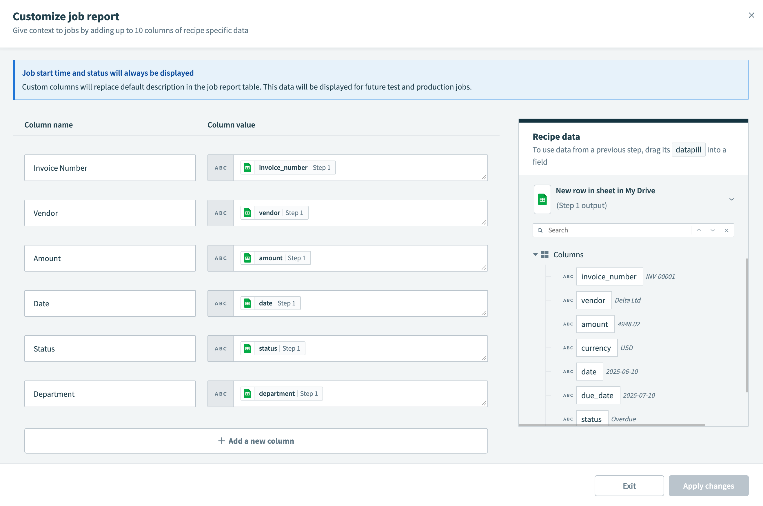

Use datapills from the recipe's steps to add columns to the report on the Customize job report page.
The Customize job report page with datapills mapped to report columns.Customize the job report

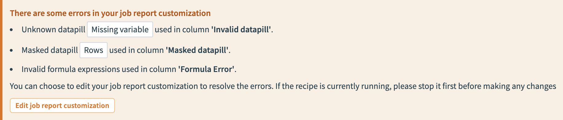

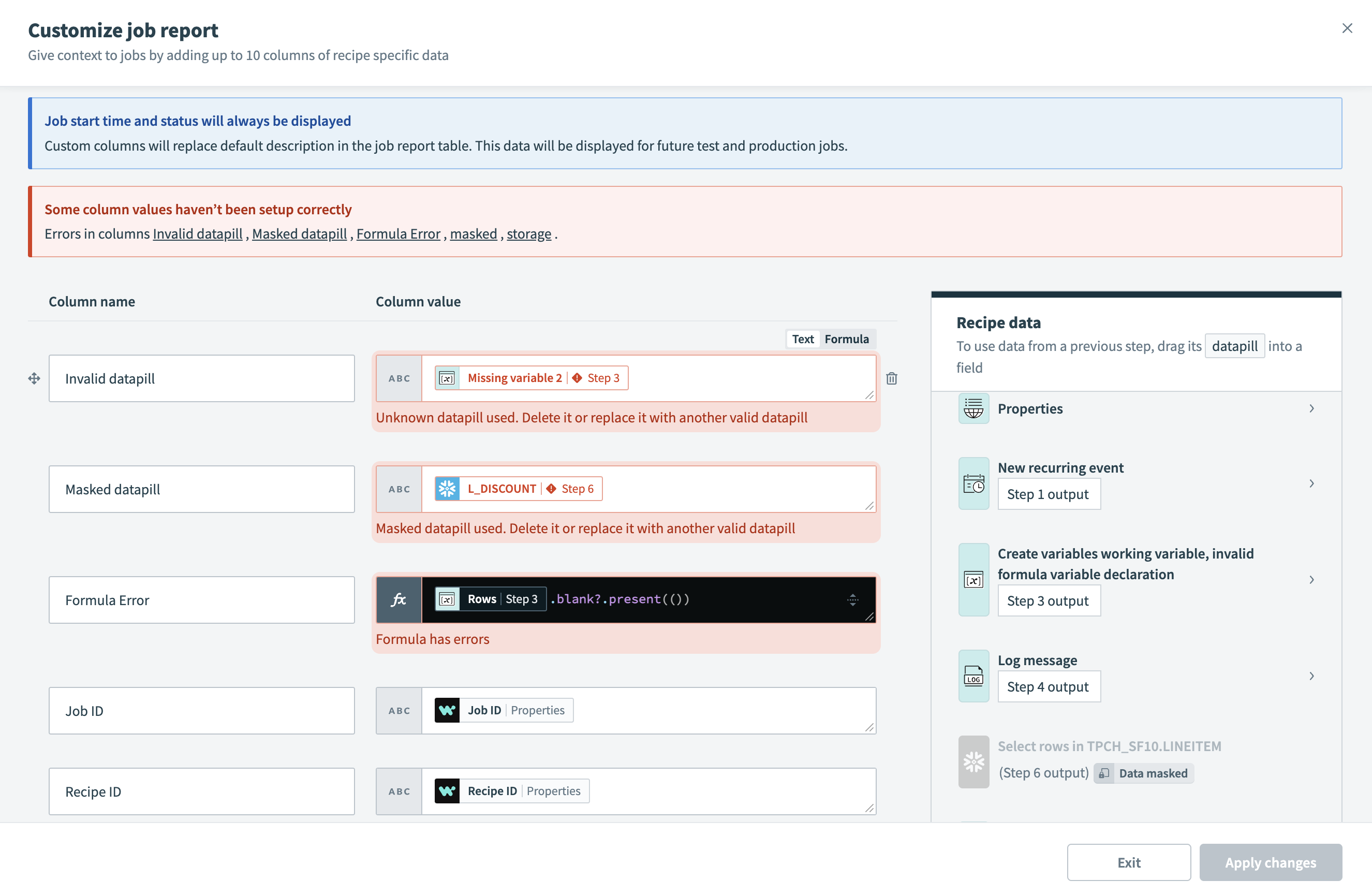

Custom job report validation ​
Workato validates custom job reports before you save them. Validation flags formula errors and references to masked or non-existent datapills.
You can't use datapills from steps with data masking enabled in a custom job report. Formulas are also validated directly in the job report editor. If you save a job report with formula errors, you can still start the recipe, but the erroneous data is omitted from the report.

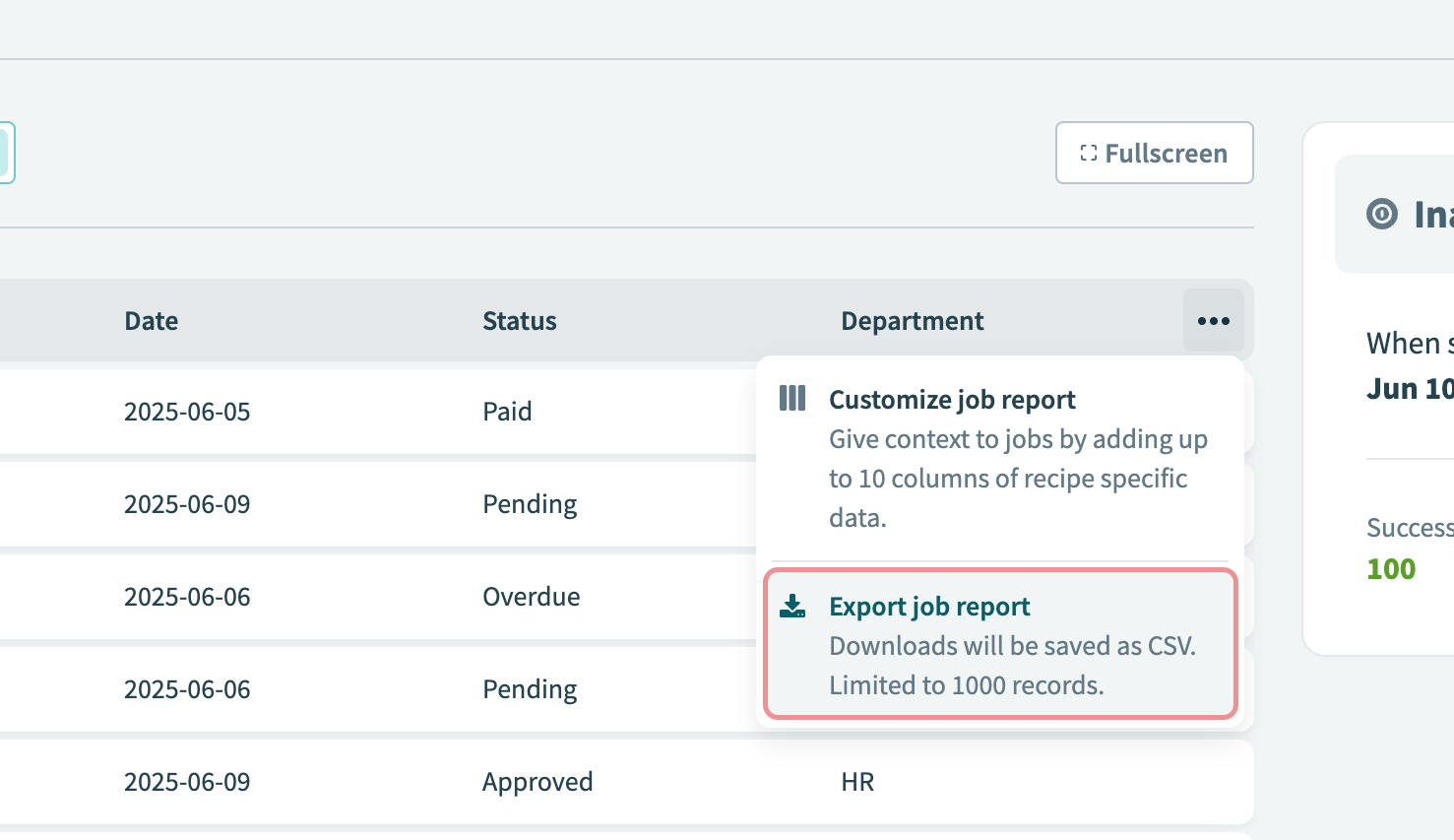

You can export job reports to CSV files, which include the latest 1,000 rows based on the current filter settings.
Complete the following steps to export job reports:
Select a recipe and go to the Jobs tab.
Optional. Set filters on the job report table.
Click the ... (ellipsis) and select Export job report.

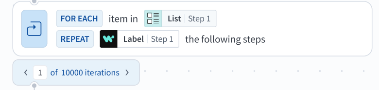

Repeat steps ​

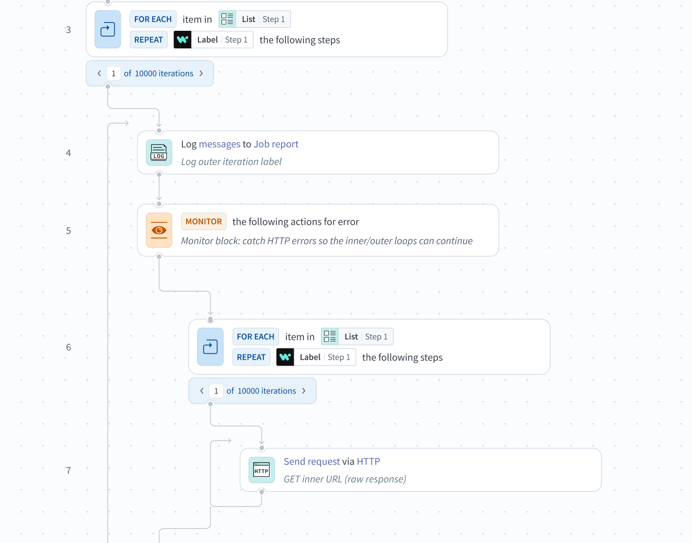

Each Repeat for each or Repeat while loop shown in a job includes an iteration navigator. Select any iteration to see that iteration's input, output, and any error for every step inside the loop.
FEATURE AVAILABILITY
Full loop visibility rolls out gradually by data center. Workspaces without full loop visibility display only the last iteration a repeat step processed. Contact your Customer Success Manager to check availability.
Repeat for each loop step with its iteration navigator reading 1 of 10000 iterations.Loop iteration navigator
The navigator shows X of N iterations, for example 5 of 5 iterations. N is the number of iterations the loop ran, which is fewer than the configured count if a condition or an error stopped the loop early.
Use the arrows to move one iteration at a time, or type a specific iteration number. A number outside the range moves the navigator to the nearest iteration.
A completed job opens on the last iteration of the most deeply nested loop, whether the loop completed or stopped on an uncaught error.
Nested loops each have individual iteration selectors. Changing an outer iteration syncs every step at that level and resets any inner loop back to its first iteration.
A job showing a nested Repeat for each loop, each level with its own iteration navigator.Nested loop iteration navigators

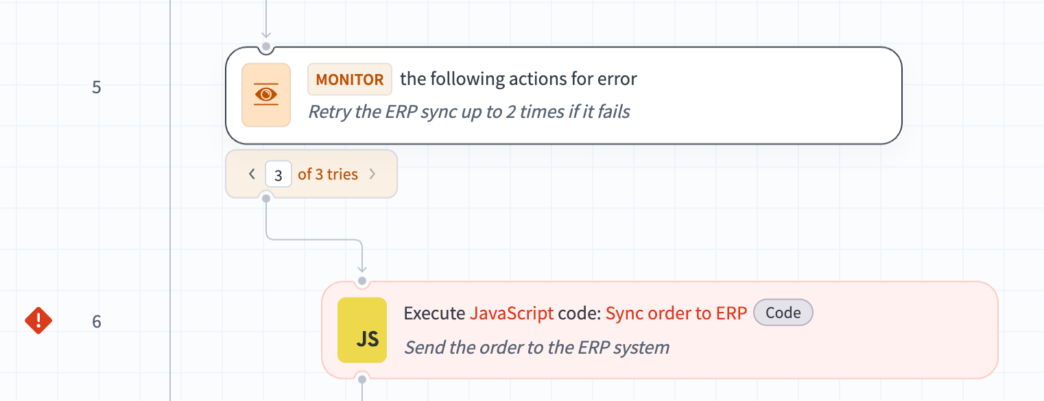

A Handle errors step that retries shows a try navigator, for example 3 of 3 tries for a step set to retry twice. The count includes the first run. Use the navigator to select a try and see the input, output, and error.
A Handle errors step with a tries navigator reading 3 of 3 tries.Handle errors tries navigator

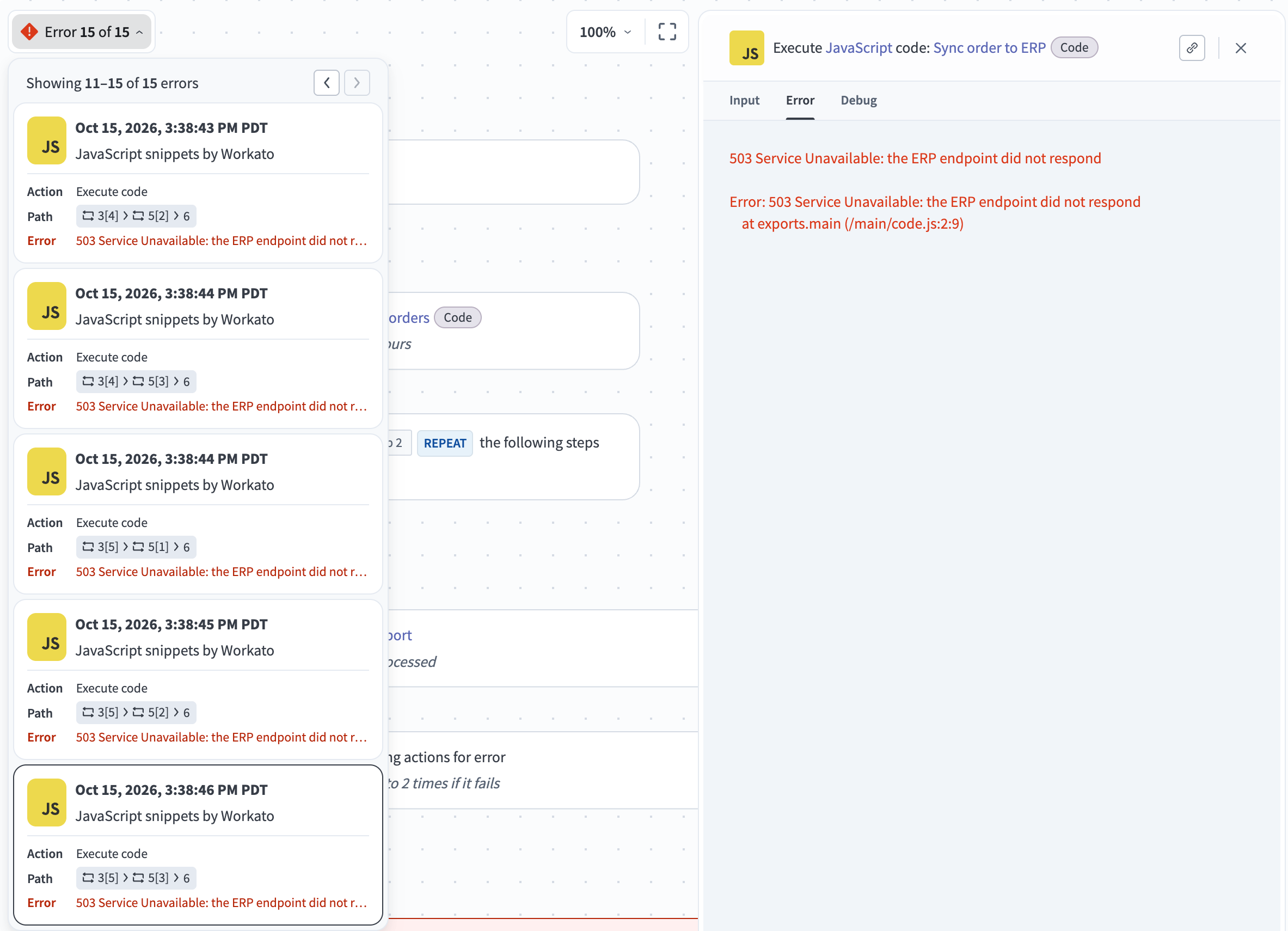

Debug errors ​

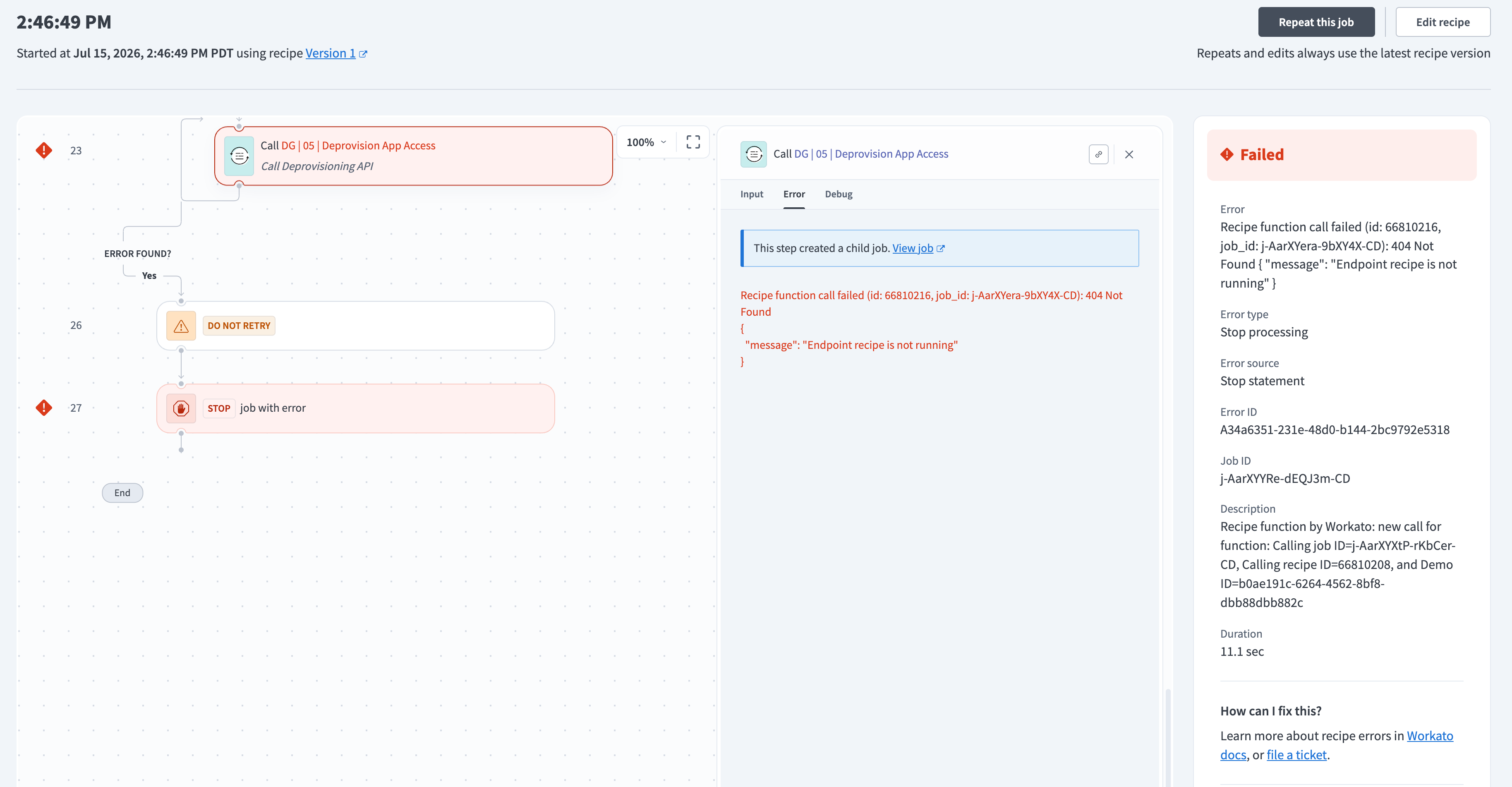

The failed step is highlighted when your job encounters an error and stops processing.
A job with a failed step highlighted in the recipe canvas.Job error
You can use the step's Debug tab to troubleshoot further.
A top-level error drop-down menu lists every error across all iterations of the job in a single location. Each entry links directly to the step and iteration that produced the error, and shows the following information:
FieldDescription
TimestampWhen the error occurred, formatted for your locale.
AdapterThe connector involved.
ActionThe action that failed.
PathThe route to the error, with the iteration or try in brackets, for example 3[4] > 5[2] > 6: iteration 4 of loop step 3, try 2 of Handle errors step 5, then step 6, where the error occurred. A recipe without loops shows only the step number.
ErrorThe first line of the underlying error.
The error drop-down menu is available for every recipe, including recipes with no loops. The error drop-down menu paginates, so a job with multiple failures stays navigable.
A completed job opens with the most recent error selected in the error drop-down menu. Selecting a different error takes you to that step and iteration.
A job with the error drop-down menu open, listing errors with timestamp, action, path, and error text.Job error drop-down menu
