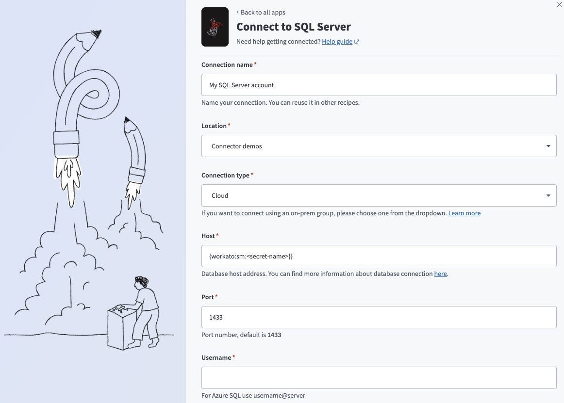

If you prefer to add the secret with a secret mask, follow this syntax for the secrets used in Workato connection credentials:
{{workato:sm:<secret-name>}}Replace <secret-name> with the secret ID as shown in Conjur.
