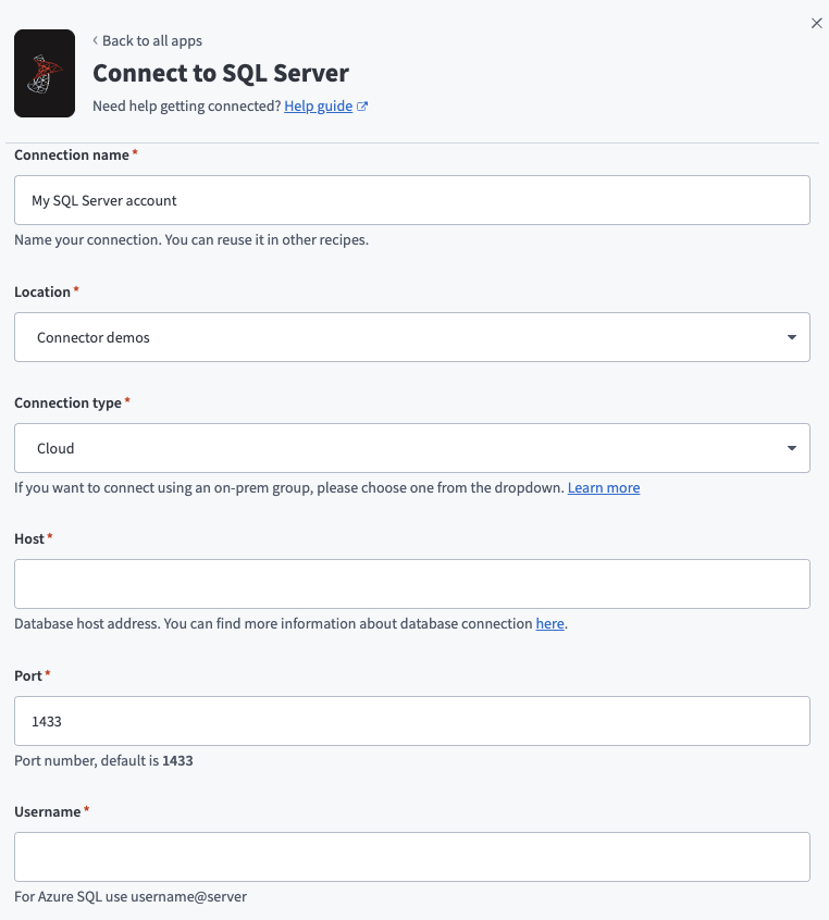

Search for and select SQL Server on the New connection page.
SQL Server connection setupSQL Server connection setup
Select Cloud in the Connection type field, unless you need to connect through an on-prem group.
Enter the URL of your hosted server in the Host field.
Enter the port number your server runs on in the Port field. The default port for SQL Server is 1433.
Enter the username to connect to SQL Server in the Username field.
Enter the password to connect to SQL Server in the Password field.
Enter the name of the SQL Server database you plan to connect to in the Database field.
Optional. Specify whether you're connecting to an Azure SQL instance in the Azure SQL field. The default is No.
