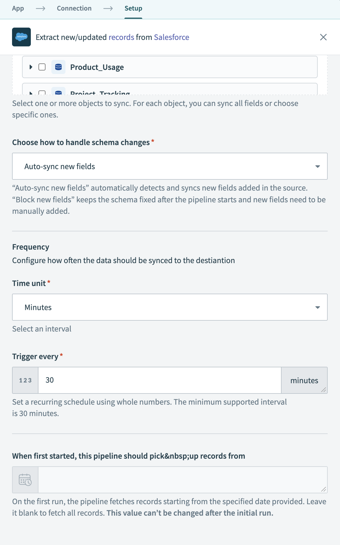

- Configure data pipeline sources: Connect a supported source application, authenticate, select objects, and define a schema.

Select Start pipeline to start the data pipeline. After you start the pipeline, it syncs selected objects and loads historical data.
