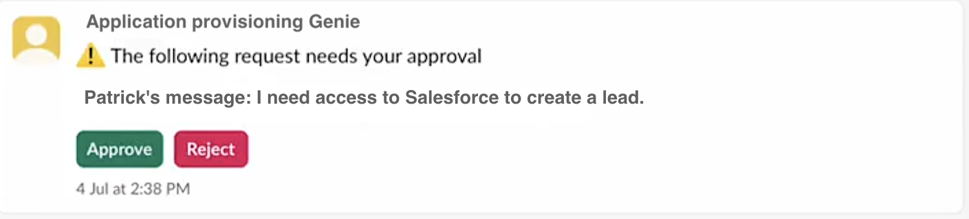

Reviewers must be signed in to the chat interface you configured for your skill to receive requests. Reviewers are prompted to approve or reject requests within the chat interface.
Business approval in the chat interfaceBusiness approval prompt in chat interface

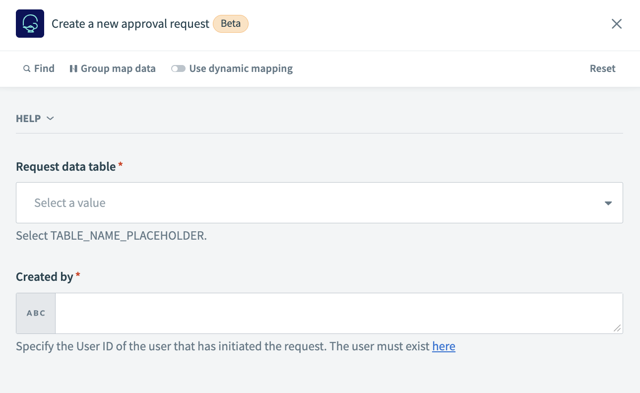

Use this action to create a new approval request in a data table you specify. The information from this request is shared with the user assigned to the approval task. Refer to the Create approval request action reference for a field-level description of inputs and outputs.
Complete the following steps to configure the Create approval request action:
Go to the skill where you plan to add an approval request.
Click the Select an app and action step in the recipe.
Search for and select Workato Genie.
Select the Create approval request action.
Create approval request actionCreate approval request action
Use the Request data table drop-down menu to select the data table you plan to use.
Provide the User ID of the request in the Created by field.

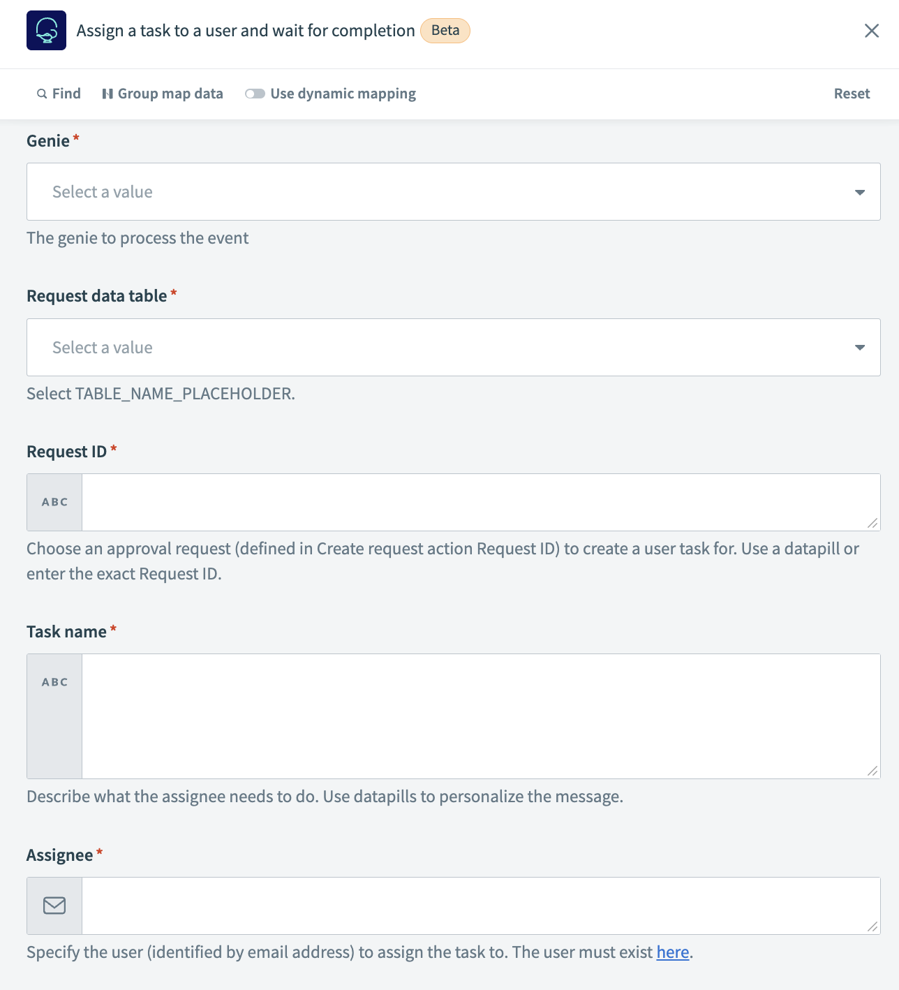

Use this action to assign a task to a user. The assignee receives a prompt within the chat interface you configured to approve or reject the request. The skill waits until the task is completed or expires. Refer to the Assign task to user action reference for a field-level description of inputs and outputs.
TASK ASSIGNMENT PREREQUISITE
Users must be added to Workato Identity before you can assign tasks to them.
Complete the following steps to configure the Assign task to user action:
Go to the skill where you plan to assign a task to a user.
Select the Assign task to user action.
Assign task to user actionAssign task to user action
Use the Genie drop-down menu to select the genie you plan to use.
Provide the request ID in the Request ID field. This is the same value as the User ID you provided in the Create approval request action Created by field.
Provide a name for the task in the Task name field.
Provide the email address of the user assigned to this task in the Assignee field.
Use the Time to complete drop-down menu to select the length of time the task is valid. Tasks expire if they aren't completed within the specified timeframe. The maximum value is 30 days.
Enter the call_id from the Start genie trigger in the Call ID field.
Enter the conversation_id from the Start genie trigger in the Requester conversation ID field.
Enter the User ID of the request in the Created by field.
