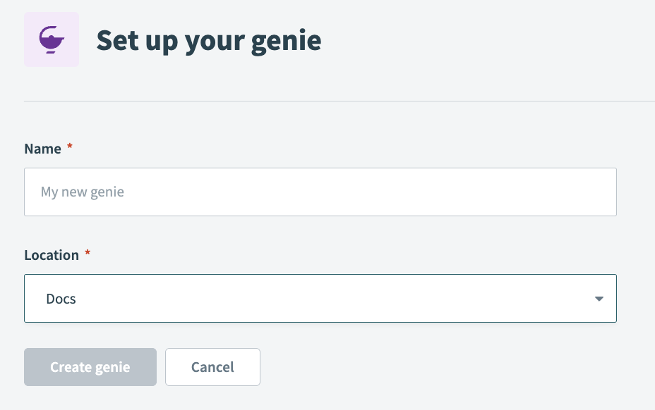

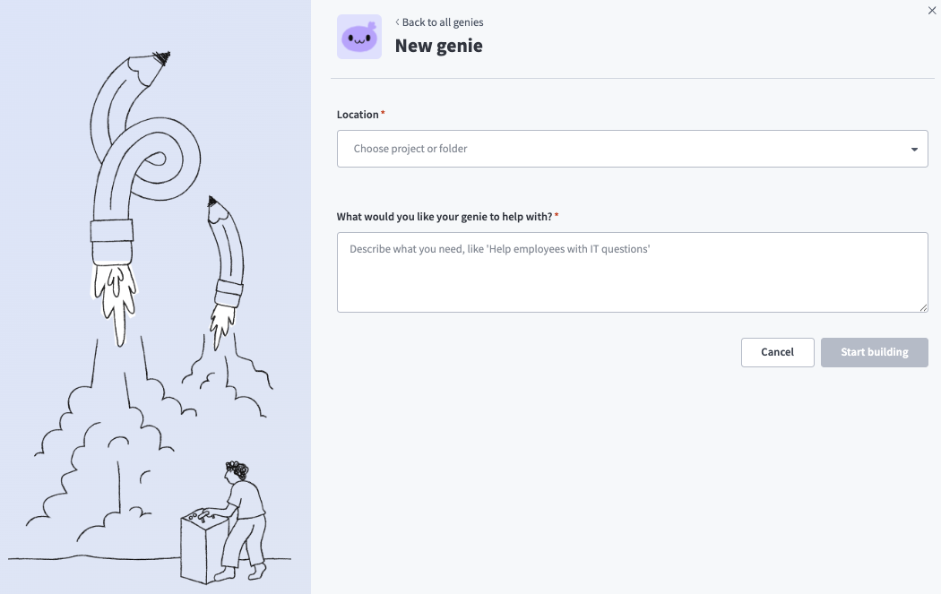

Go to AI Hub > Agent Studio and click + Create genie. Alternatively, go to the Projects page and click Create > Genie or press C+G.
Select New genie to create a blank genie.
Use the Location drop-down menu to select a location for your genie.
Enter a request or goal for your genie in the What would you like your genie to help with? field.
Create a genieCreate a genie
Click Start building. The genie Build page displays.

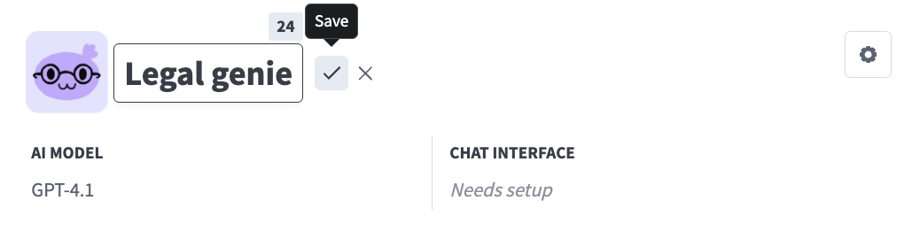

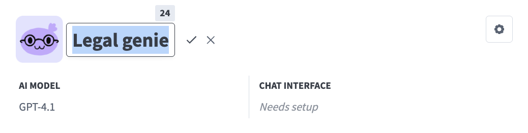

Change your genie's name ​
Your genie is assigned a name automatically. You can change the name to better represent the purpose of the genie. For example, you can change your genie's name from Onxy_8 to Sales Team.
Complete the following steps to change the name of a genie:
Sign in to Workato.
Go to AI Hub > Agent Studio. A list of your existing genies displays.
Select the genie you plan to rename.
Click the genie name.
Click the genie nameClick the genie name
Enter a new name for your genie.
Click ✓ (Save) to save your changes.
Click SaveClick Save

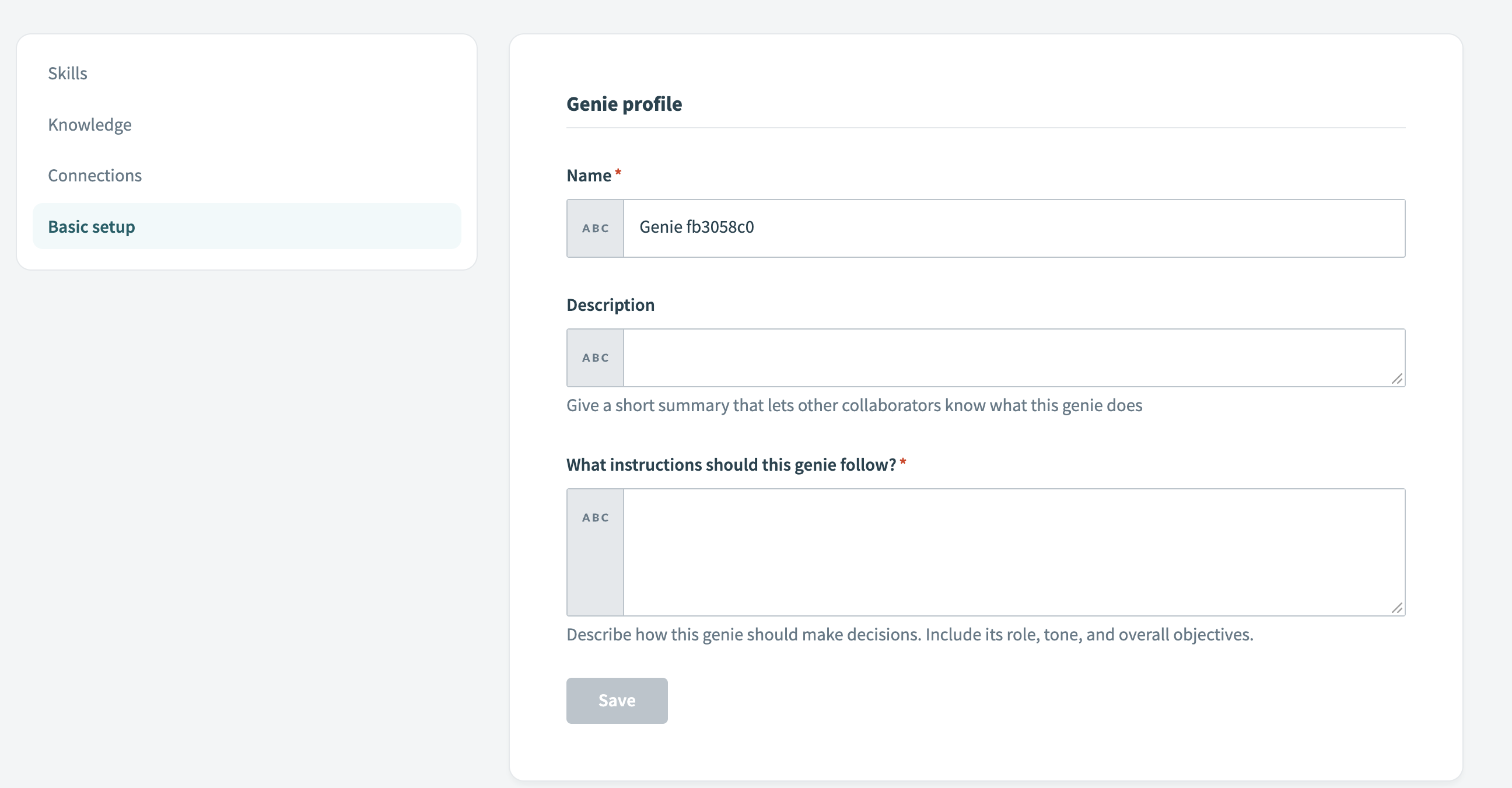

Create a job description ​
The Job description section is where you provide detailed prompts to enable your genie to understand its role, personality, and goals. The Job description is automatically generated based on the input you provide to the What would you like your genie to help with? field during genie setup and can be edited to suit your requirements. Refer to Add a detailed job description for more information.
Complete the following steps to configure a job description for your genie:
Go to the Job description section.
Go to the Job description sectionGo to the Job description section
Review the detailed instructions generated for your genie in Job description. For example:

Optional. Click Edit to update the job description and then click Save.

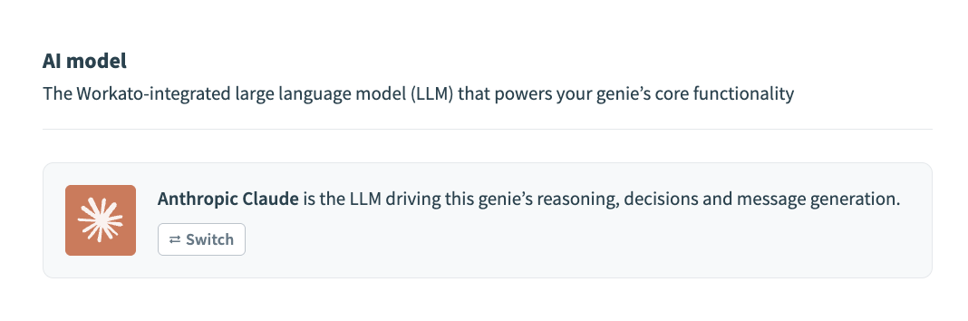

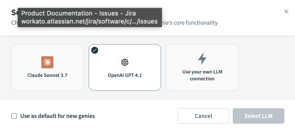

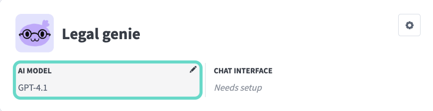

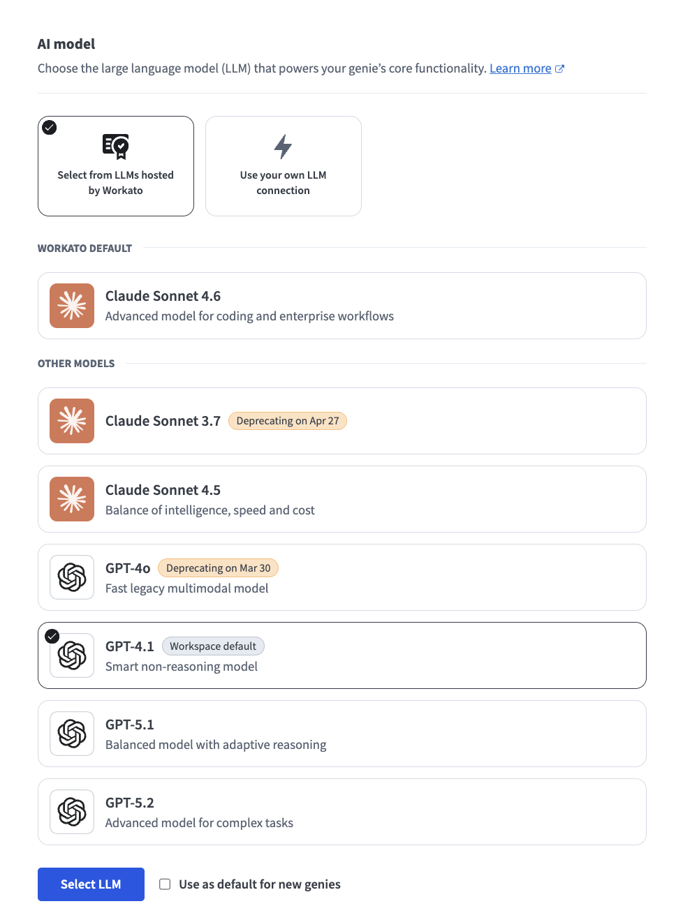

Add an AI model ​
The AI large language model (LLM) that powers your genie’s core functionality is set to Anthropic Claude by default. You can switch your LLM to OpenAI GPT or to your own LLM.
Complete the following steps to add or update the AI model for your genie:
Go to the genie where you plan to add your AI model.
Click Edit.
Click AI model.
Click AI modelClick AI model

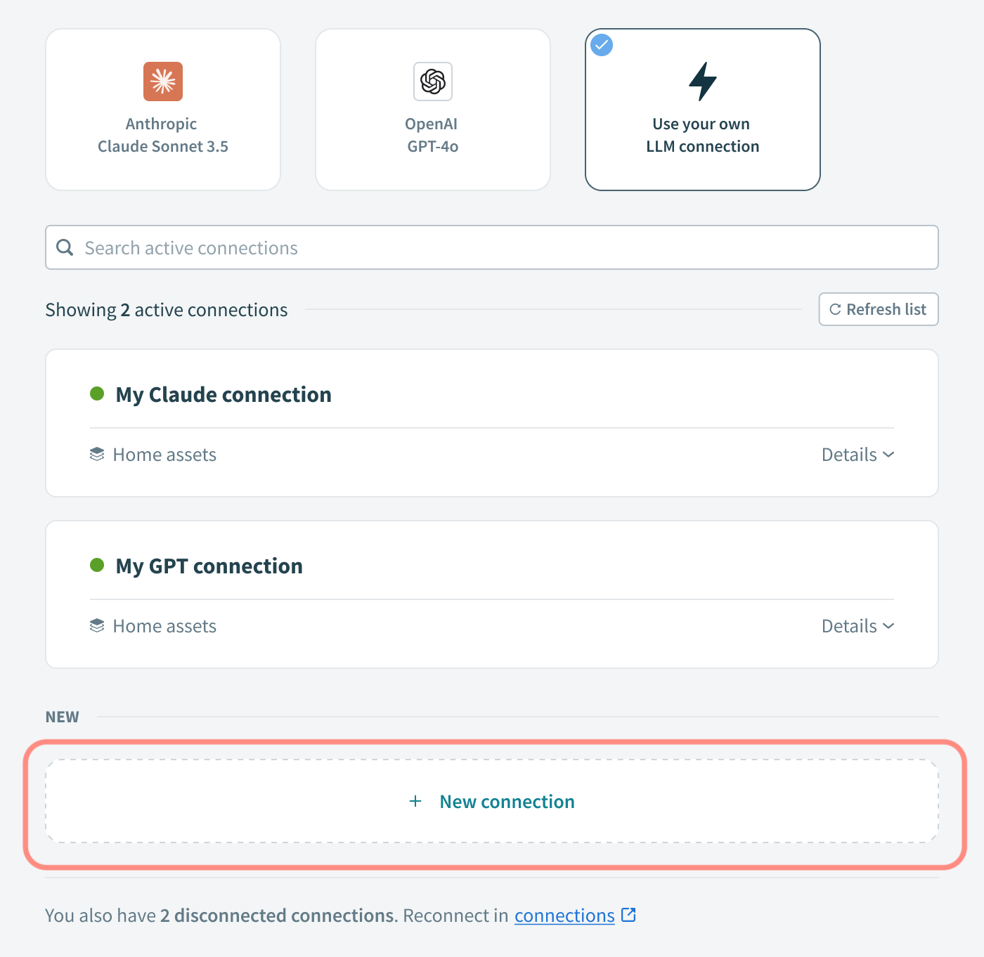

Select whether to use your own LLM or an LLM hosted by Workato:
Optional. Click Use as default for new genies to use this model as the workspace default.
Click Select LLM.
Optional. Click Test to test the accuracy of the LLM for your scenarios.

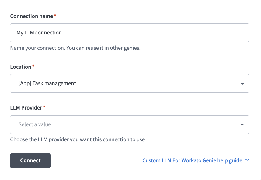

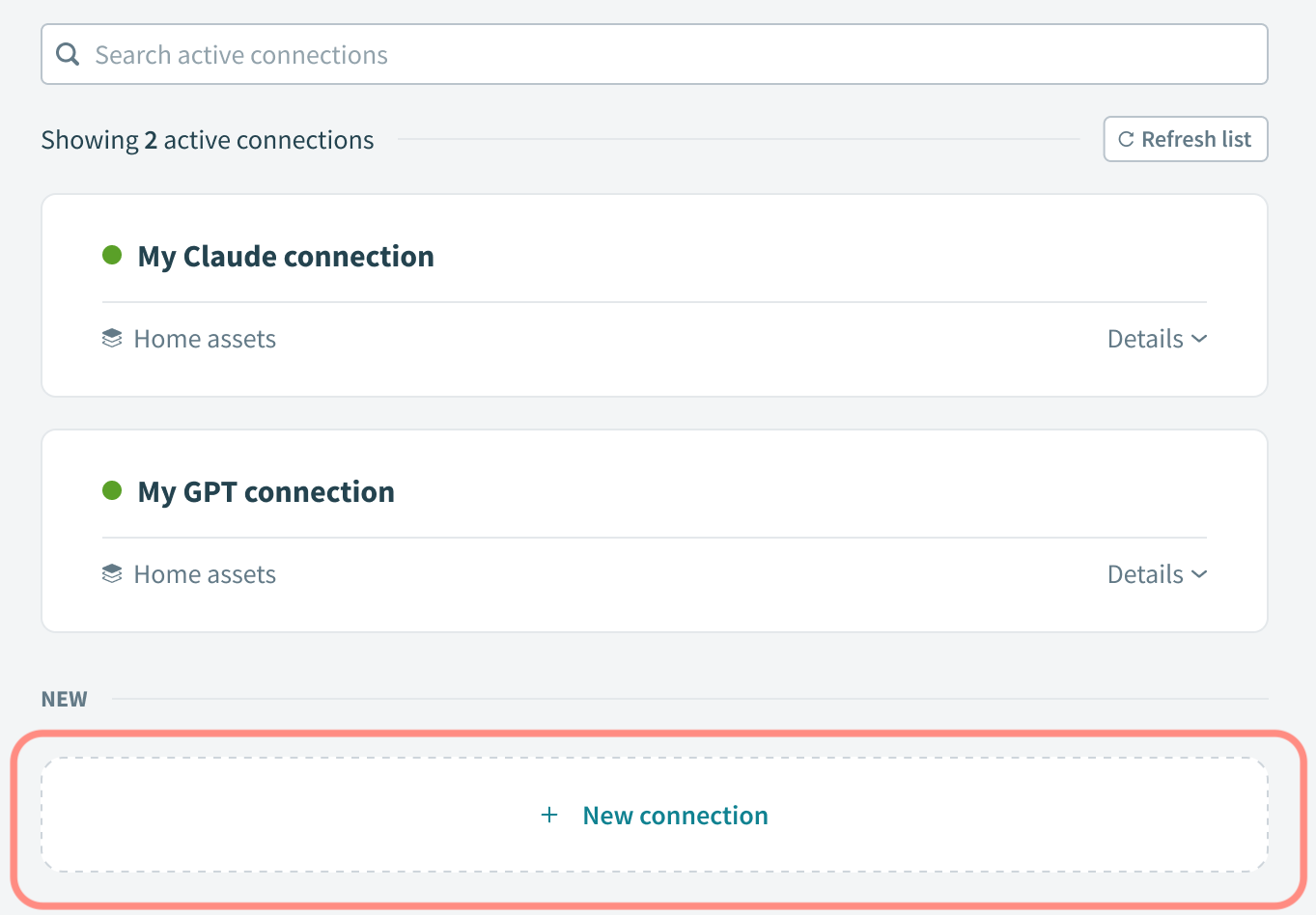

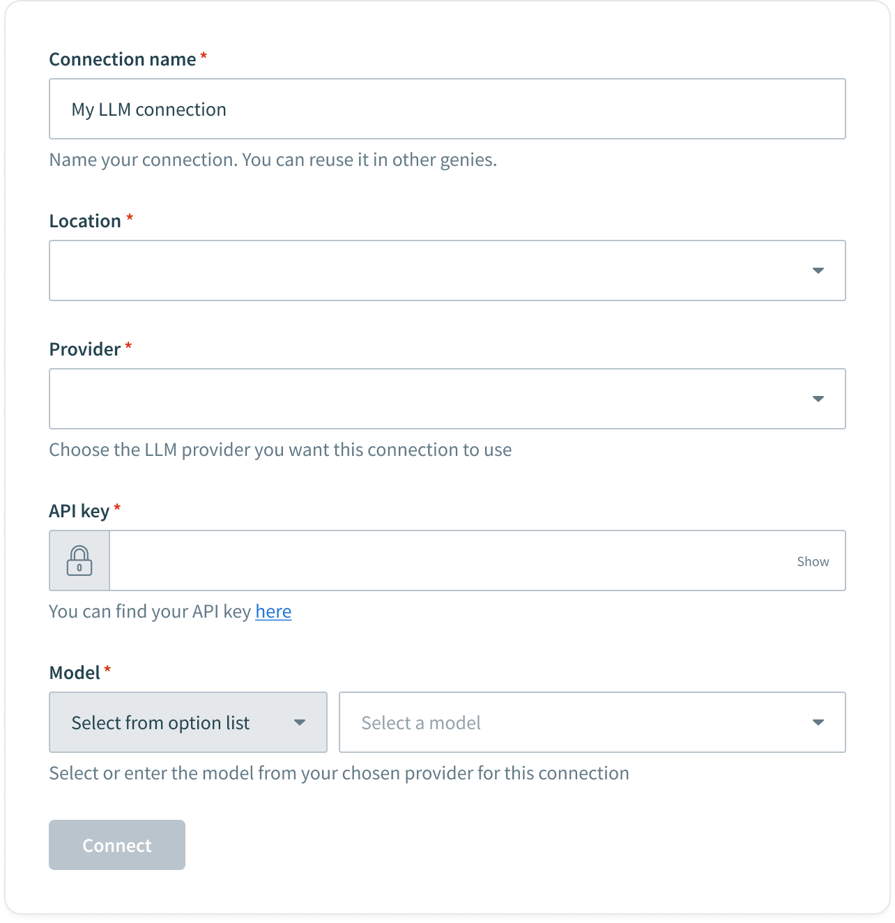

Connect to your own LLM ​
Complete the following steps to configure a connection to your LLM:

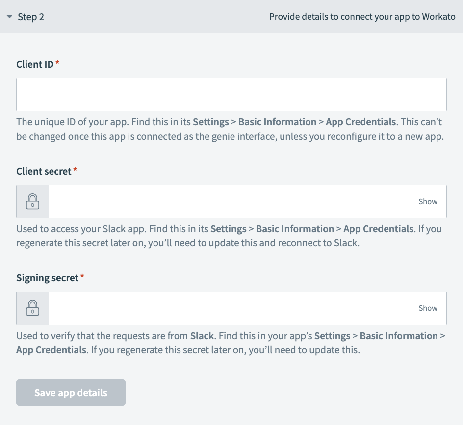

Go to Step 1 and click Create new app. Workato opens the selected app and prompts you to create a new app. Follow the instructions in Workato to create the Slack app for your genie.
Go to Step 2 and enter your Client ID. Locate this value in the Basic Information or App Credentials section of your app.
Chat interface step 2Chat interface Step 2 configuration
Enter your Client Secret. You can find this in the Basic Information or App Credentials section of your app.
Provide your Signing Secret. This is used to verify that interactive messages and events requests originate from your app. You can find this in the Basic Information or App Credentials section of your app.
Click Save app details.
Go to your app's App Manifest and use the Click here to verify link to verify your app's URL for Step 3.

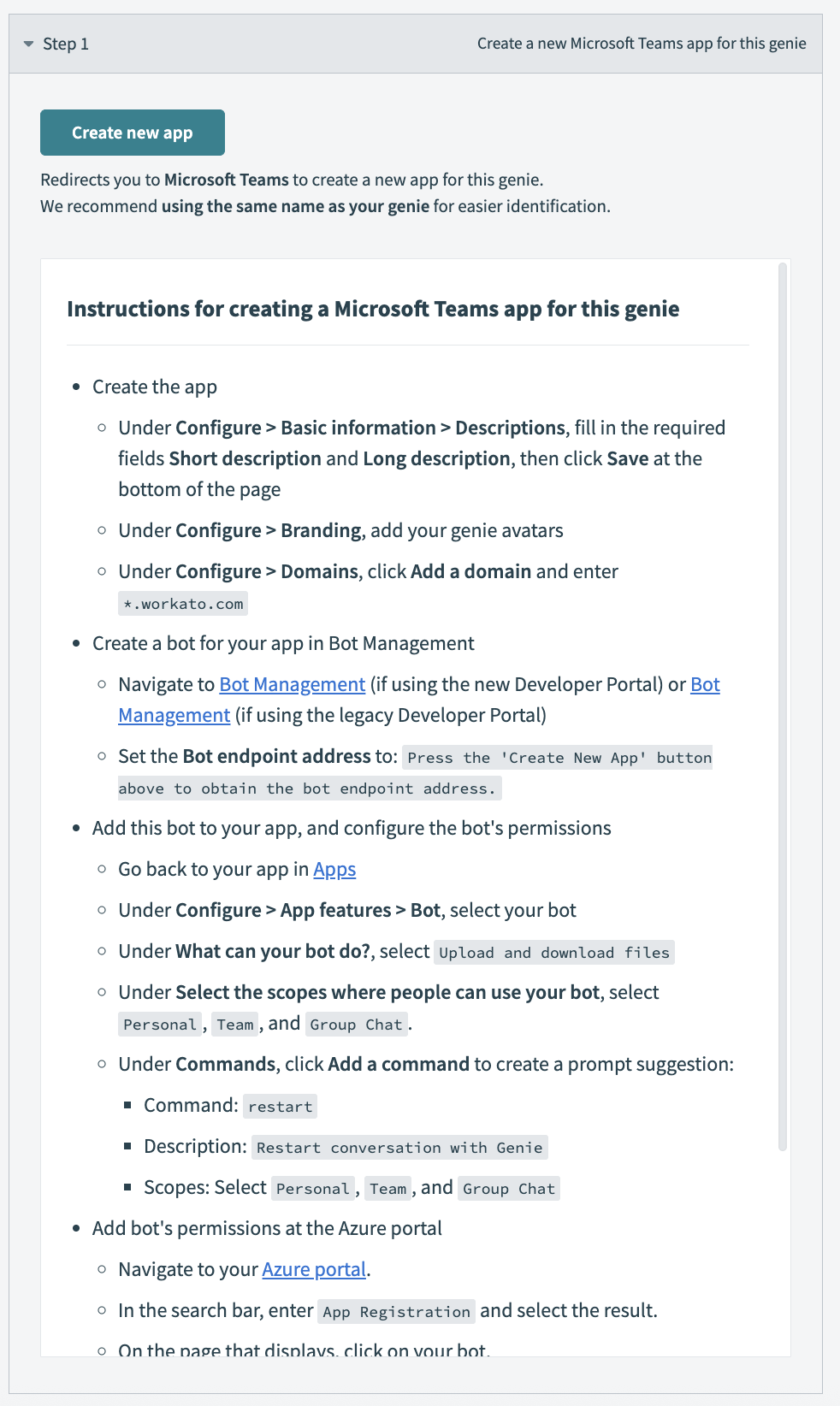

Microsoft Teams
Configure Microsoft Teams as your chat interface ​
Complete the following steps to configure Microsoft Teams as your chat interface:
Select Microsoft Teams as your chat interface.
Go to Step 1 and click Create new app. Follow the instructions in Workato to create the Microsoft Teams app for your genie.
Go to Step 1 and click Create new appGo to Step 1 and click Create new app
Go to Step 2 and enter your app ID in the App ID field.
Go to Step 2 and enter your app ID in the App ID fieldGo to Step 2 and enter your app ID in the App ID field
Enter your bot ID in the Bot ID field. You can find your app's bot ID by going to Tools > Management in Microsoft Teams.
Enter your client secret in the Client secret field.
Enter your tenant ID in the Tenant ID field. This is your unique Microsoft Entra ID tenant ID. You can find your tenant ID in the Microsoft Azure Portal.
Go back to Apps and select your app.
Click Publish > Publish to your org. Your Microsoft Teams admin may need to approve the publish request.
Return to trigger configuration and click Connect Microsoft Teams trigger.

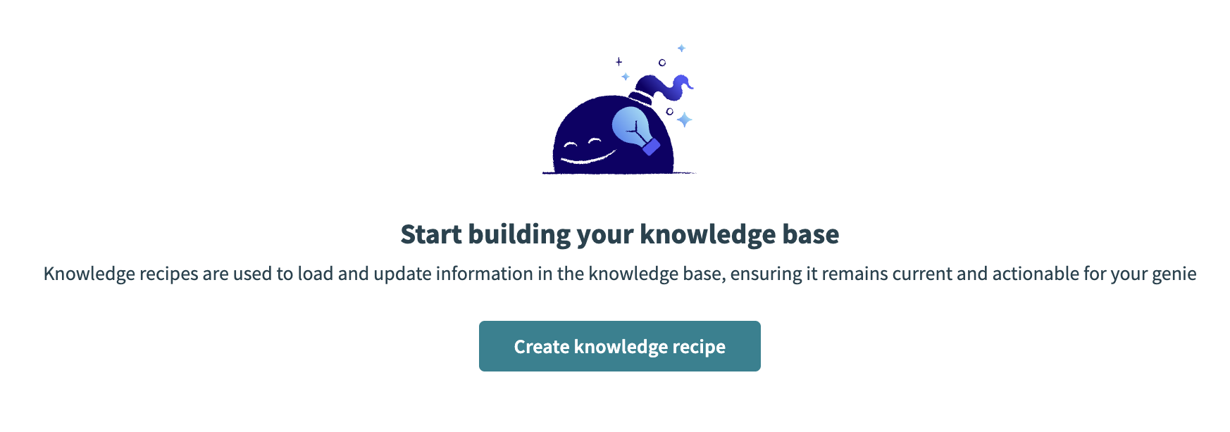

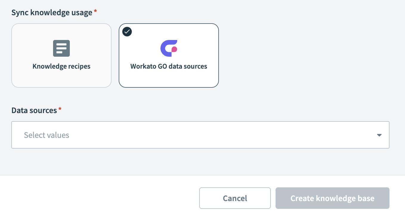

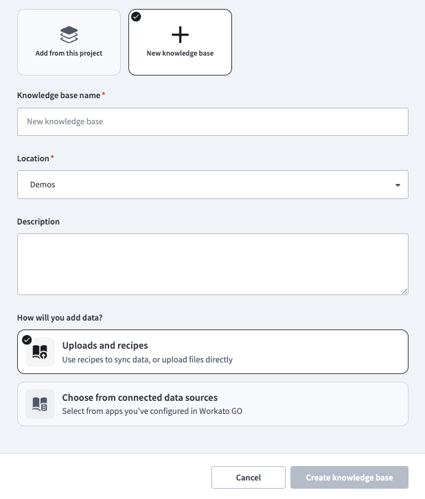

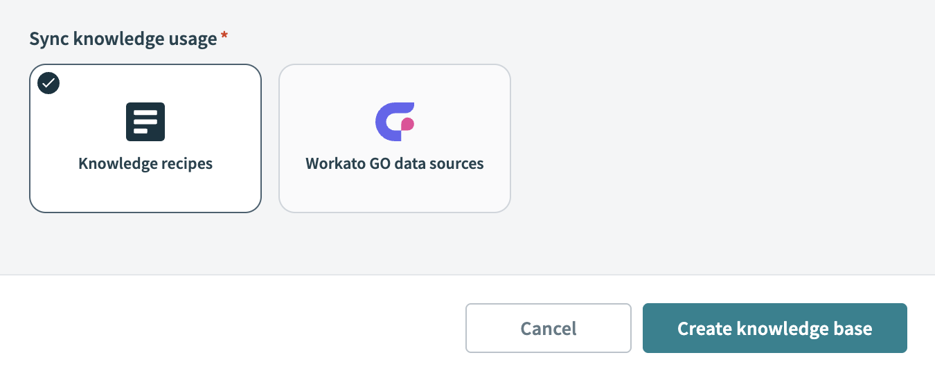

Create a knowledge base ​
Knowledge bases store and organize company-specific information and domain knowledge, enabling your genie to provide more contextualized and accurate responses. Your knowledge base can only be assigned to one genie. Knowledge bases can contain multiple knowledge recipes.
Knowledge base configuration and document preparation ensure that your knowledge base retrieves information efficiently. Refer to Knowledge base best practices and Knowledge bases versus databases for more information.
Complete the following steps to create a knowledge base:
Sign in to Workato.
Select the genie where you plan to create a knowledge base.

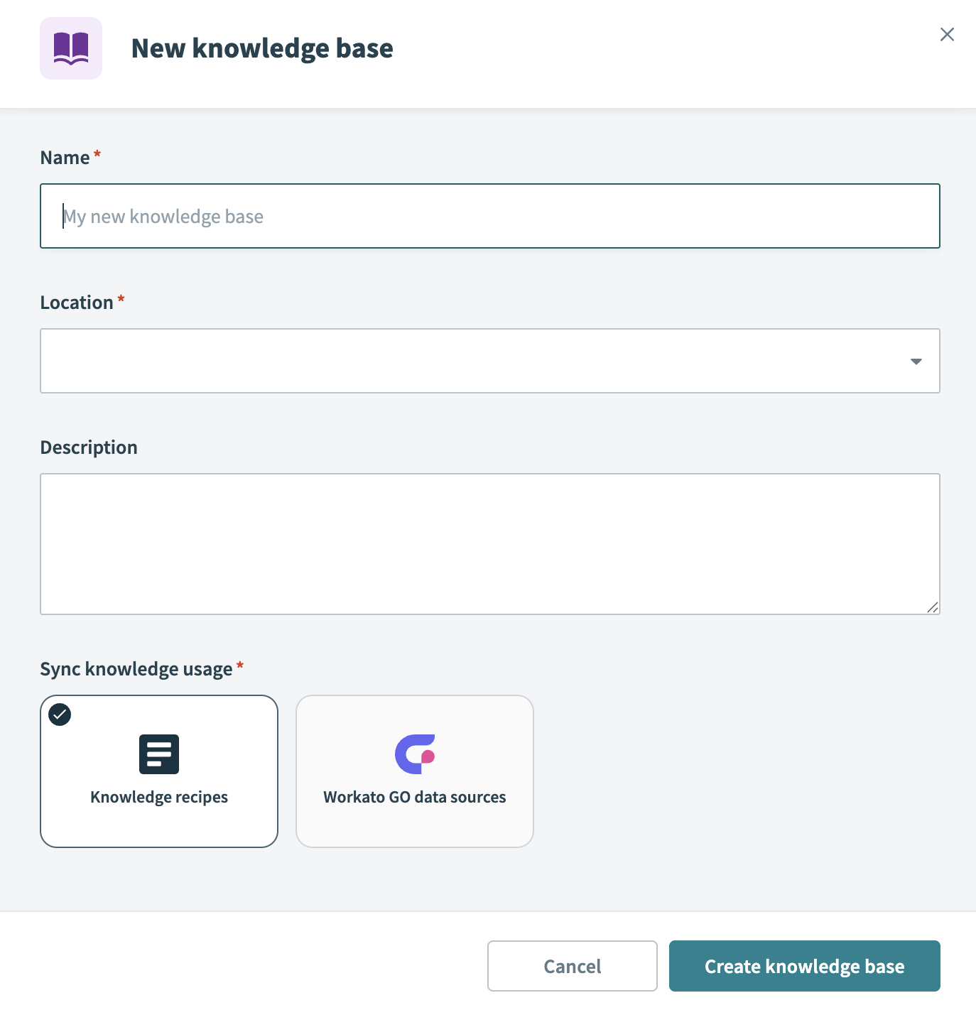

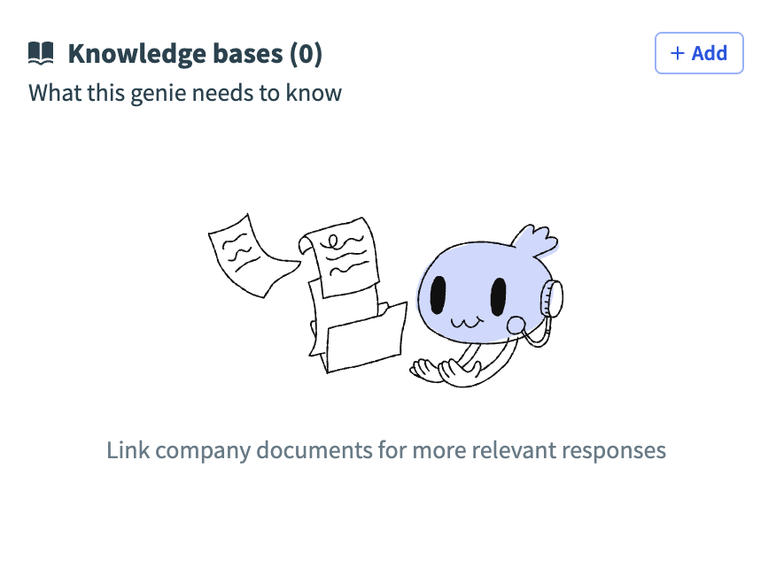

Go to the Knowledge base section and click + Add.
Select + New knowledge base.
Enter a name for your knowledge base in the Knowledge base name field.
Create a knowledge baseCreate a knowledge base
Use the Location drop-down menu to select a location for your knowledge base.
Enter a description for your knowledge base in the Description field. Genies use descriptions to understand the context and purpose of the knowledge base to determine when to use it.
Go to the How will you add data section and select the data source you plan to use to sync the information in your knowledge base.
Click Create knowledge base.

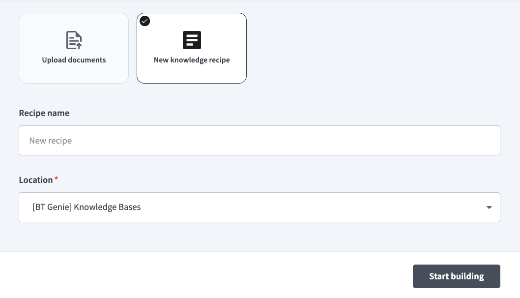

Go to the Knowledge bases section and select the knowledge base where you plan to add your knowledge recipe.
Click + Add knowledge.

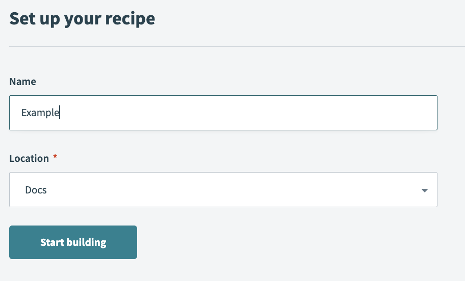

Select New knowledge recipe.
Enter a name for your knowledge recipe in the Recipe name field.
Use the Location drop-down menu to select a location for your knowledge recipe.
Set up your knowledge recipeSet up your knowledge recipe

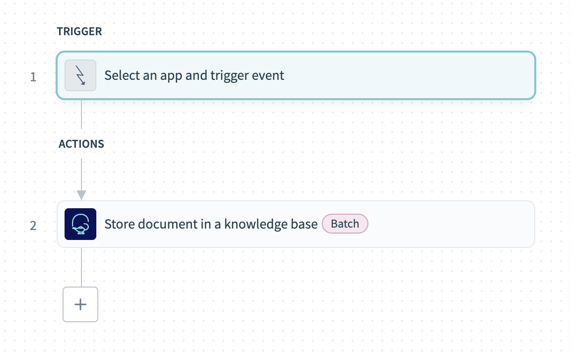

Click Start building. The recipe editor opens with the Store knowledge action automatically selected.
Configure your trigger.
Knowledge recipe with Store knowledge in a knowledge base action automatically selectedKnowledge recipe with Store knowledge in a knowledge base action automatically selected
Test your recipe to ensure workflow compatibility with your genie.

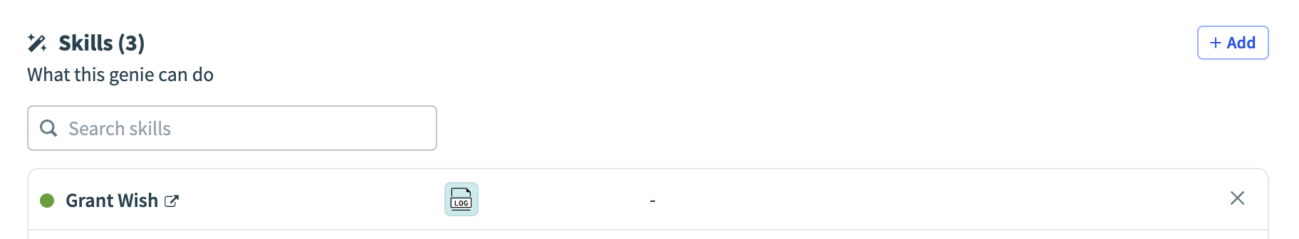

Go to the Enterprise skills section and click + Add.
Select Skill.
Select New skill and click Create new skill.

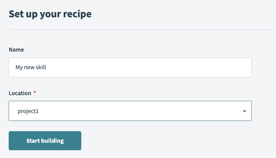

Provide a name for your skill in the Skill name field.
Use the Location drop-down menu to select a location for your skill.
Click Start building. The recipe editor opens with the Start workflow trigger and Return response action automatically selected.

18
Provide a name for your connection in the Name field.
19
20
Provide information for all required app connection fields. Connection configuration fields vary based on the app you select.

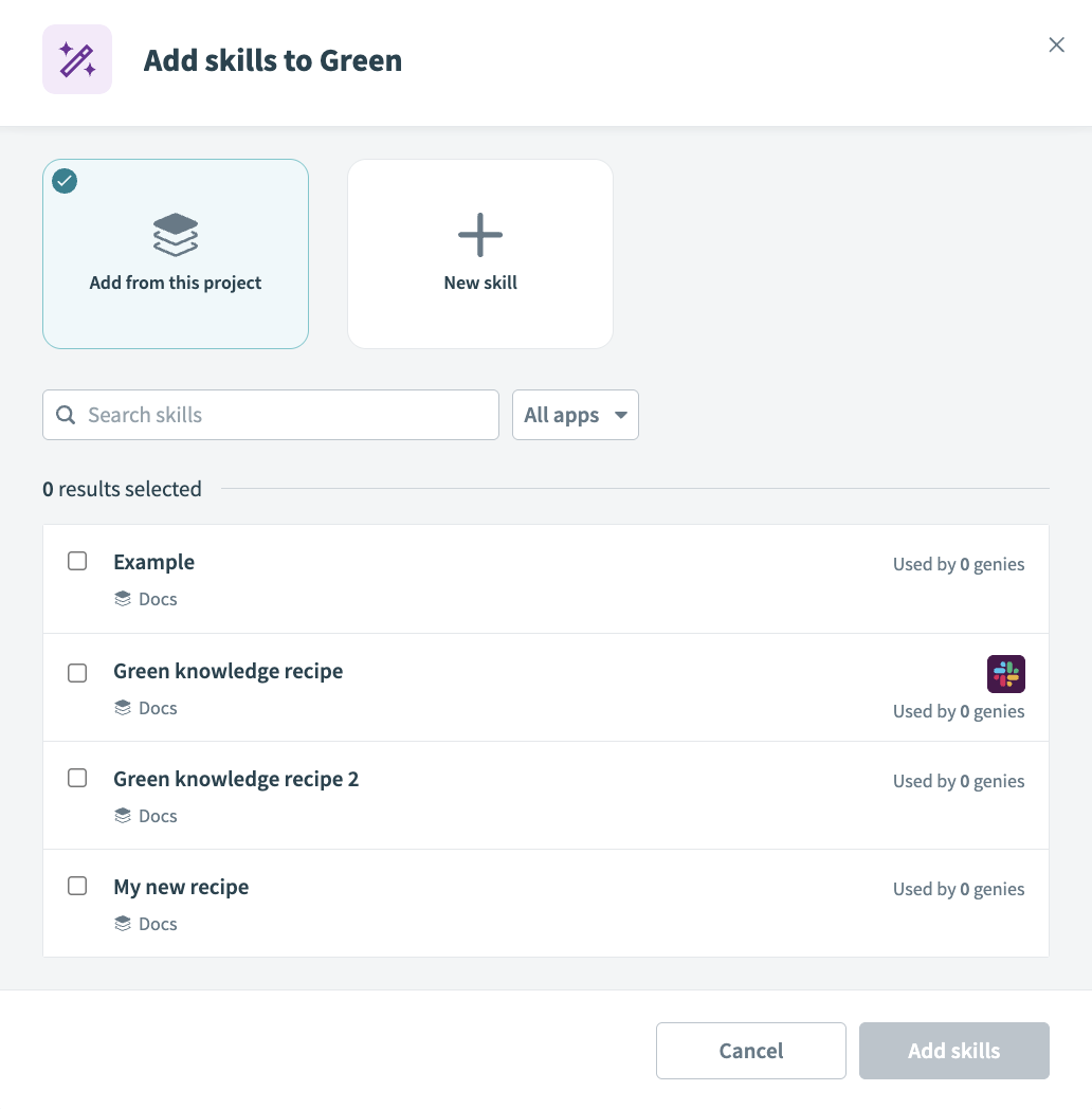

Click +Add > Skill.
Select Add existing skills.
Select Add existing skillsSelect Add existing skills
Search for and select the skill you plan to add to your genie.
Select skillsSelect skills
Click Add skills.
