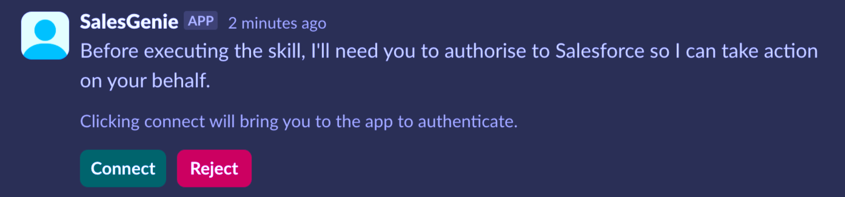

User connections link to the parent connection, environment, and user ID in Workato Identity when you use verified user access to create connections at runtime. The genie calls a skill that uses the parent connection when an end-user talks to a genie and triggers a recipe. The genie responds in one of the following ways:
  • Connection prompt: The chat interface prompts the user to click Connect if they've already created a runtime user connection. The skill executes using this child connection.
  • Create a runtime connection prompt: The chat interface prompts the user to create a runtime user connection if they haven't already created a runtime user connection. The skill executes using this child connection.
Connect prompt in the chat interfaceConnect prompt in the chat interface
For example, when you run a skill with a Salesforce connection that requires verified user access, it creates a child connection for the user. This new connection links to the skill's default Salesforce connection as its parent.
