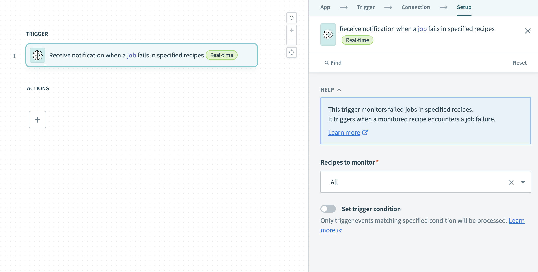

Add the Job failed trigger from the RecipeOps connector.
Use the Recipes to monitor drop-down menu to select how you plan to monitor recipes:
  • Choose All to monitor all recipes in the workspace.
  • Choose Selected and enter specific recipe IDs.
  • Choose Tags and enter one or more tags.
Configure the Job failed triggerConfigure the Job failed trigger

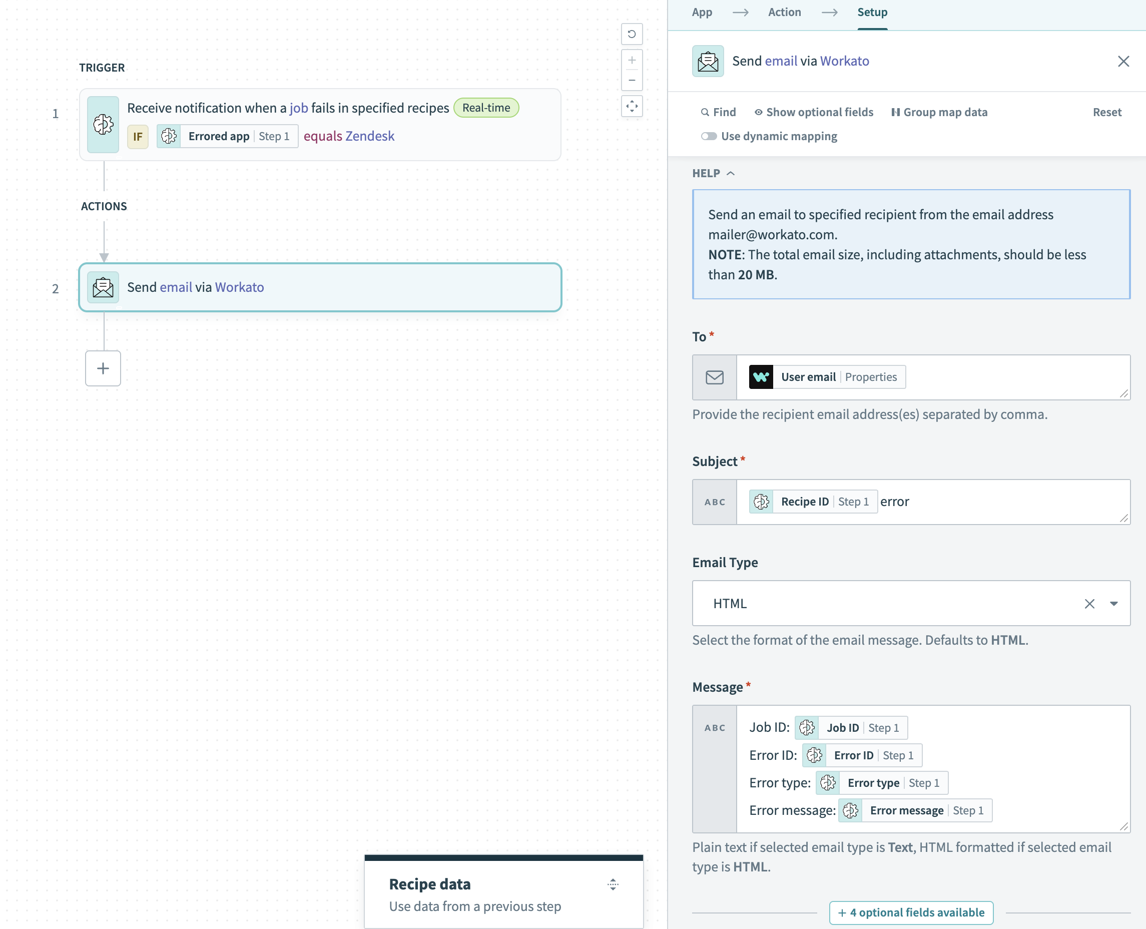

Enable the Set trigger condition toggle to filter job failures at the trigger level. For example, filter by error type, errored app, or recipe ID to capture only specific failure scenarios.
Add actionClick Add step > Action in app
Add the Send email action.
Map datapills from the trigger output into the email fields. You can include details such as Recipe ID , Job ID , Error type , and Error message to provide recipients full context.
Map datapills to email fieldsMap datapills to email fields

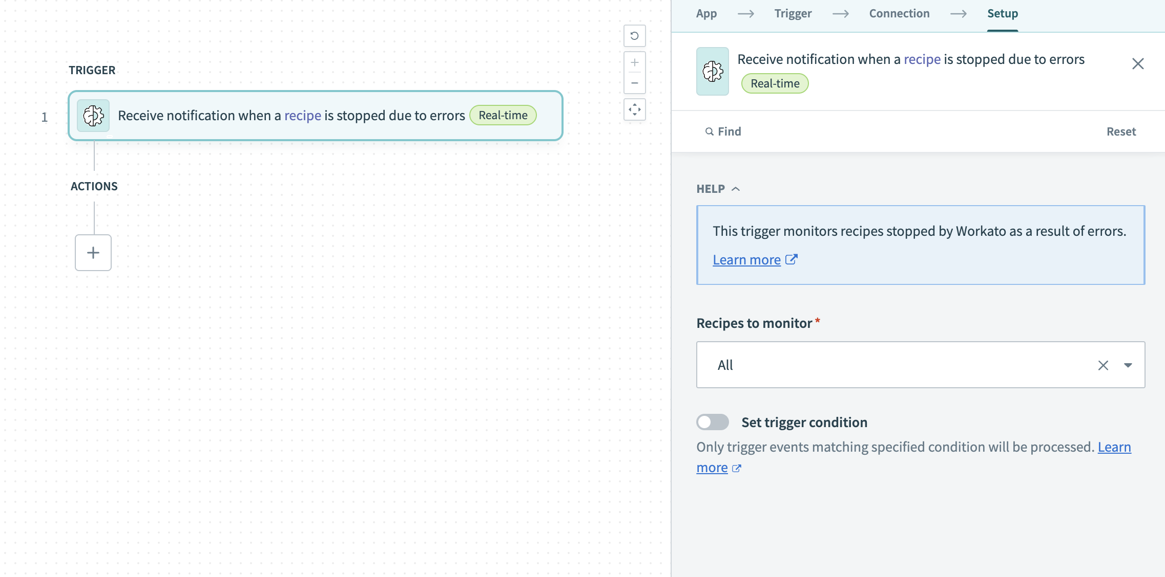

Add the Recipe stopped by Workato trigger from the RecipeOps connector.

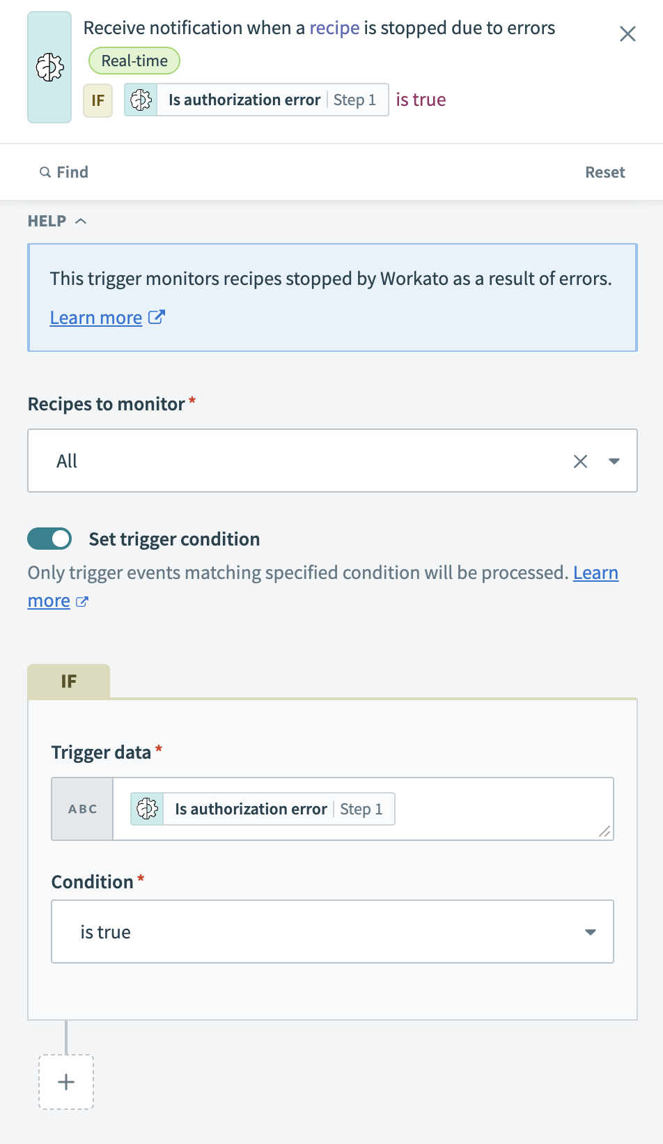

Configure the Recipe stopped by Workato triggerConfigure the Recipe stopped by Workato trigger
Enable the Set trigger condition toggle to filter for authorization-related stops. Use the Is authorization error datapill and set it to is true.
Set trigger conditionSet trigger condition

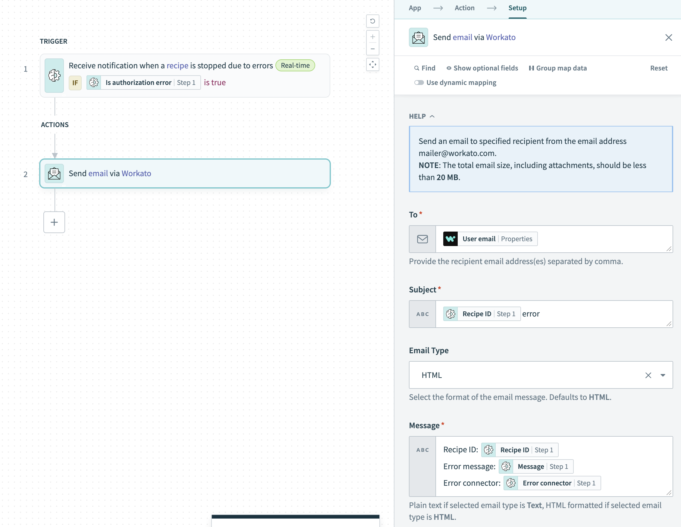

Map datapills from the trigger output to the message, such as the Recipe ID , Error message , and Error connector .
