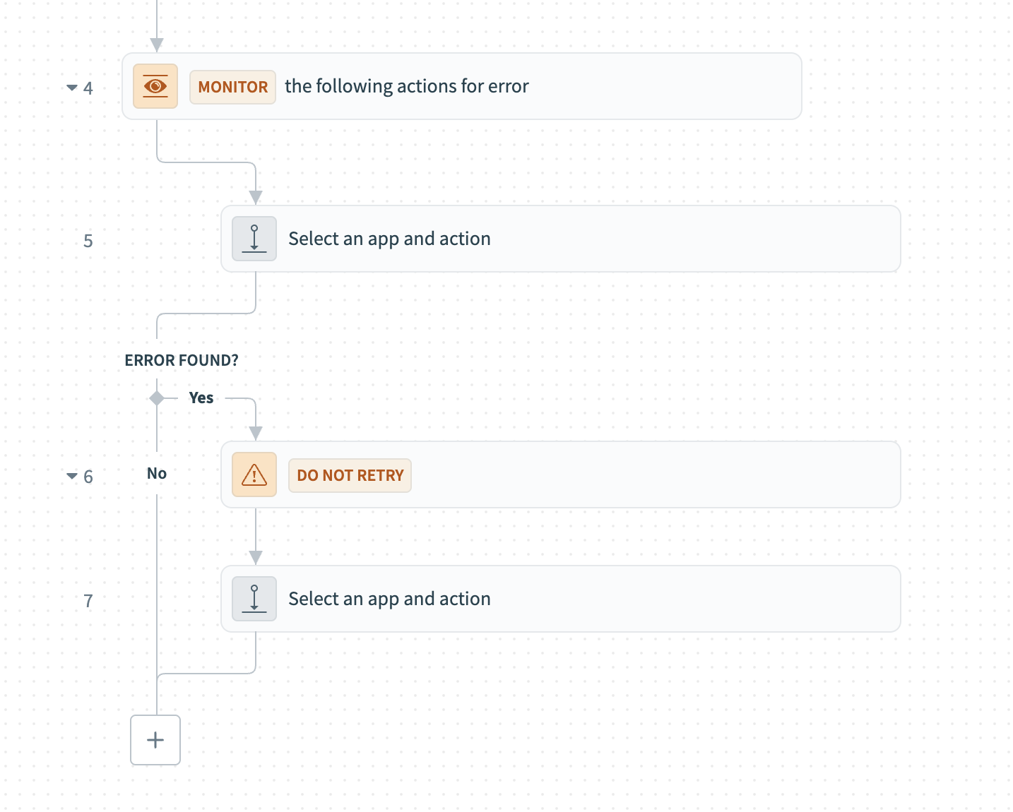

The Handle errors step includes two blocks:
  • Monitor actions for error: Add the steps you plan to monitor for failures. If these steps succeed, Workato skips the error-handling block.
  • On error: Add the steps to run when a failure occurs. You can also configure retry behavior by setting the number of retry attempts and the wait time between them. If retries fail, Workato runs the remaining steps in this block.
flowchart TD A([Monitor the following <br/> actions for an error]) --> B(Error found?) B -->|If <b>Yes</b>| C(<strong>DO NOT RETRY</strong>) C --> D(STOP job) B ---->|If <b>No</b>| E(Process the action normally) classDef default fill:#67eadd,stroke:#b3e0e1,stroke-width:2px,color:#000; classDef WorkatoPink fill:#f3c1c2,stroke:#f3c1c2,stroke-width:1px; class C,D WorkatoPink

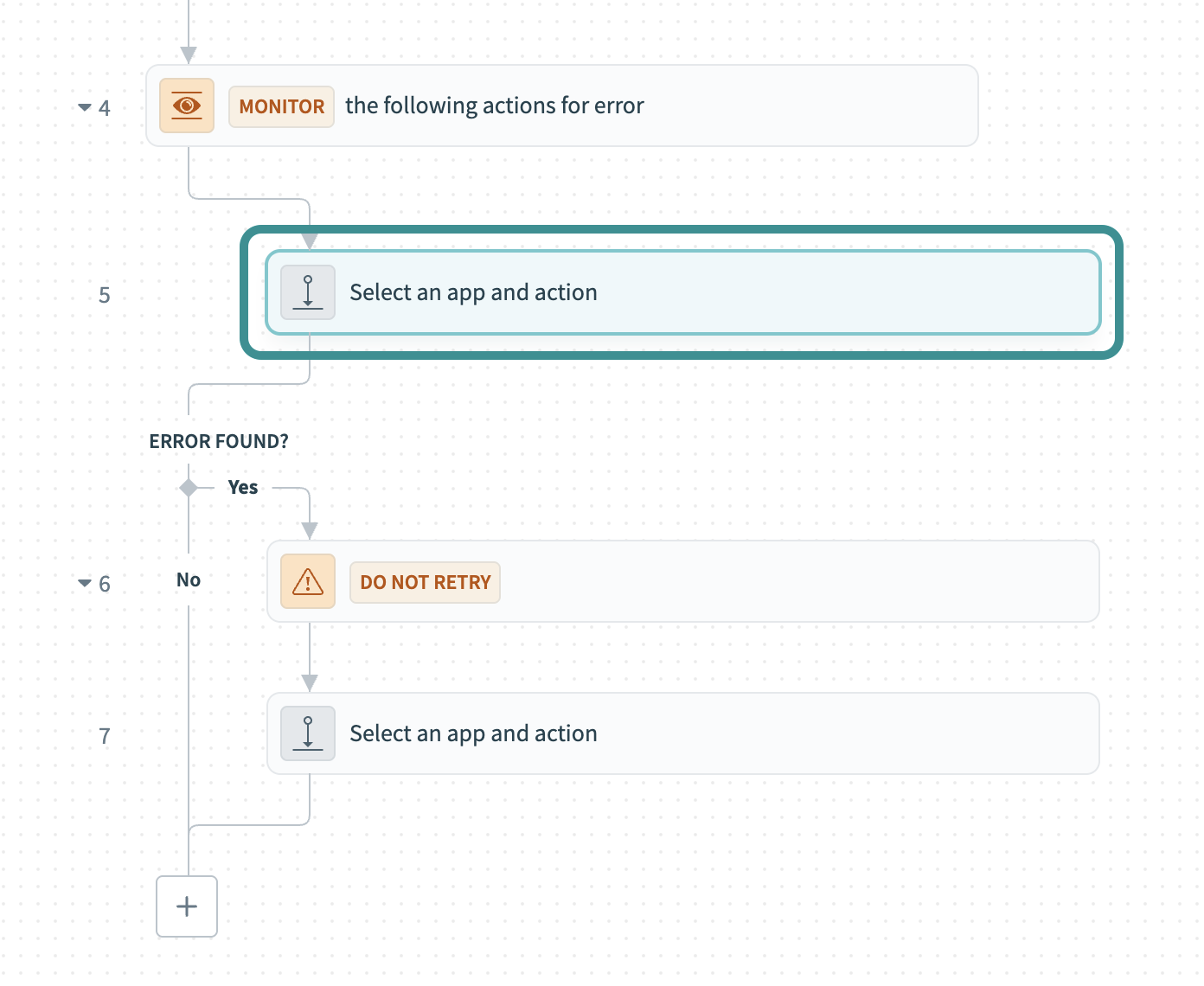

Add the actions you plan to monitor inside the Monitor actions for error block.
Add actions to monitor for errorsAdd actions to monitor for errors

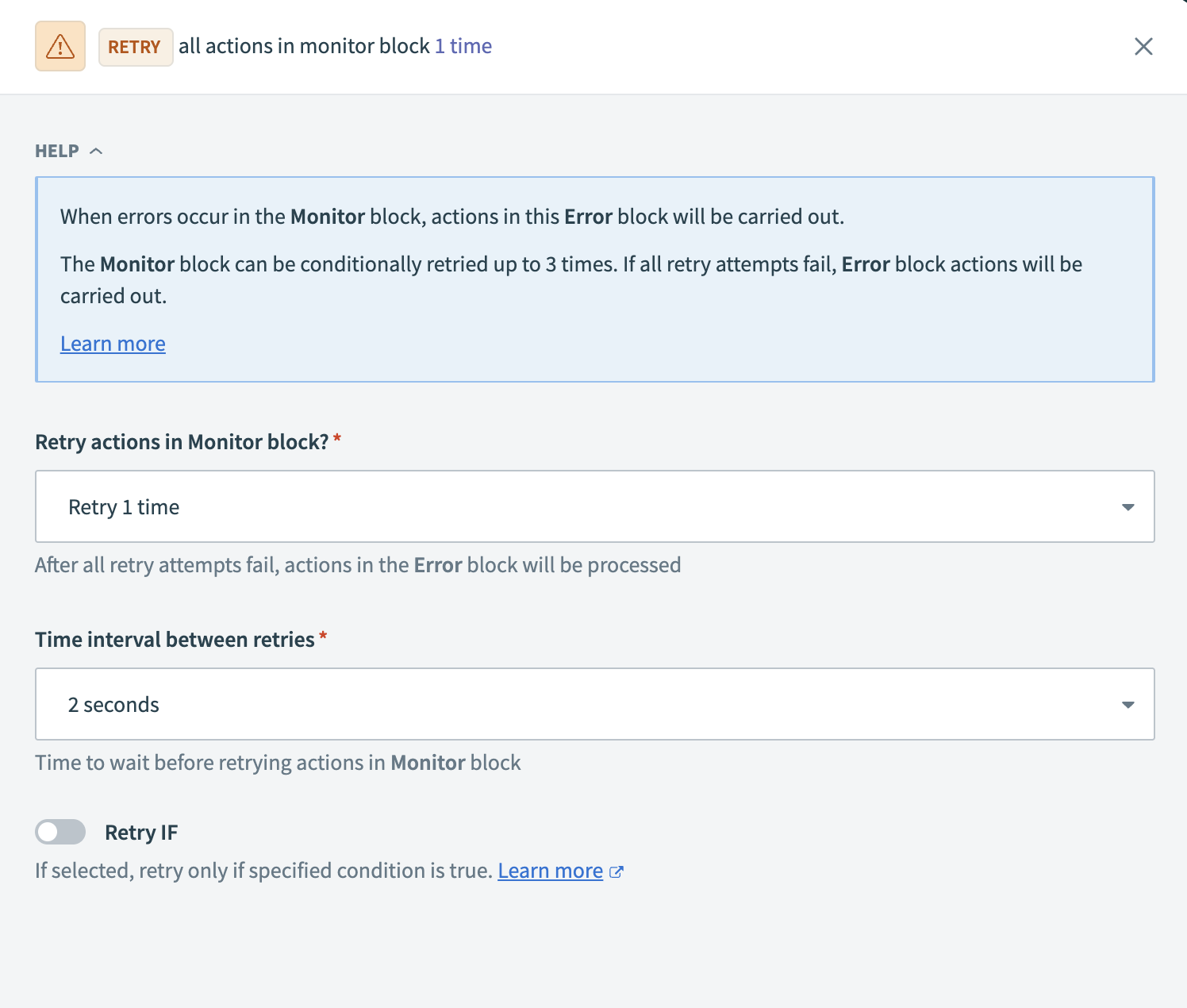

Configure how Workato handles errors. By default, Workato doesn't retry failed actions and immediately runs the On error steps when it encounters an error. Use the following settings to enable retries and define their behavior:
Specify how many times to retry failed actions in the Retry actions in Monitor block? field. Workato allows up to three retries.
Configure how to handle errorsConfigure how to handle errors
Set the delay in the Time interval between retries field. You can choose a value between one and ten seconds.
Optional. Enable the Retry IF toggle to retry only when a specific condition is true.
Retry only if specified condition is trueRetry only if specified condition is true

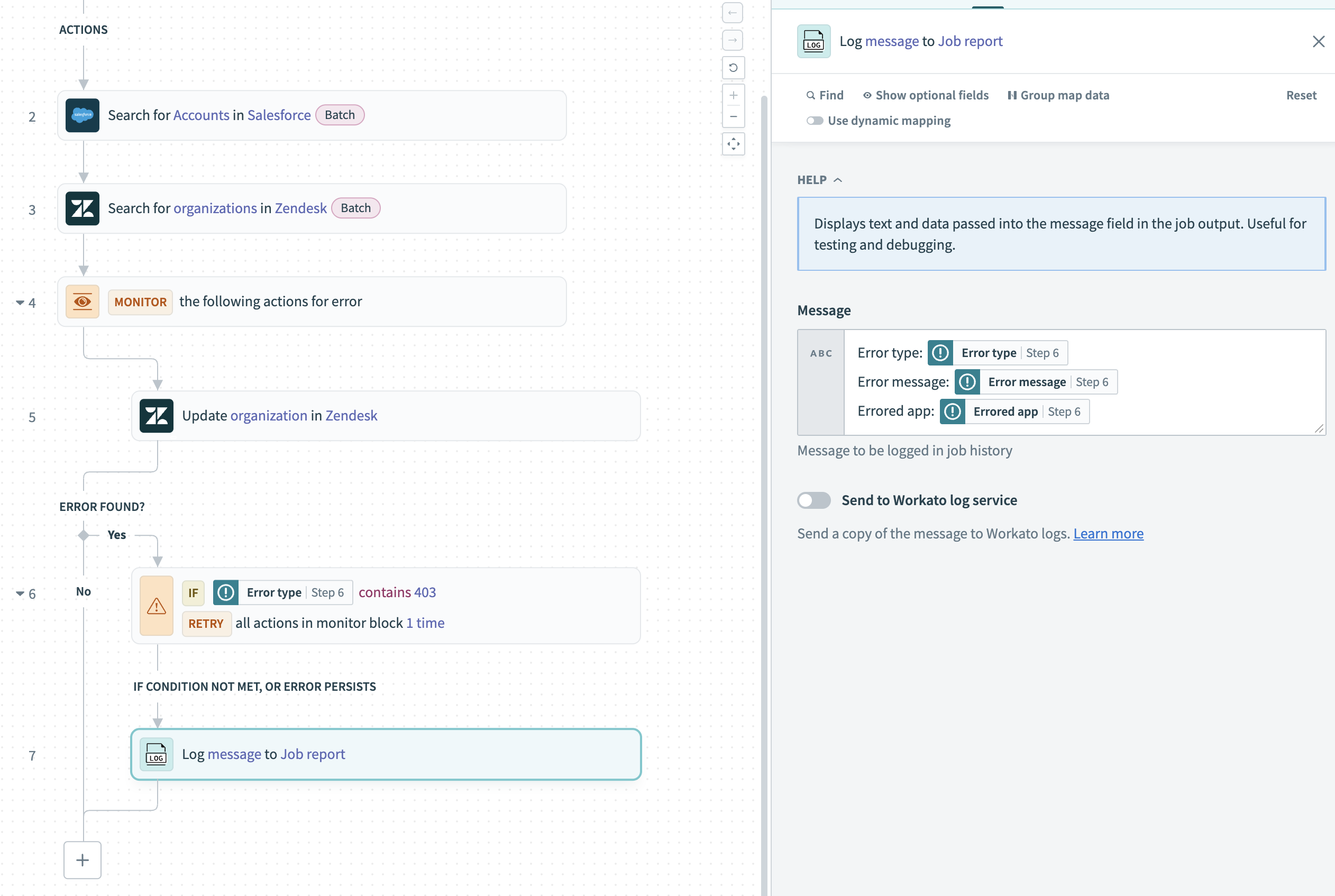

For example, you can use the Log message action to output datapills like Error type Step 6 , Error message Step 6 , or Errored app Step 6 in your job logs. This provides clear context to support error tracking and testing.
Log job error context using on error datapillsLog job error context using on error datapills

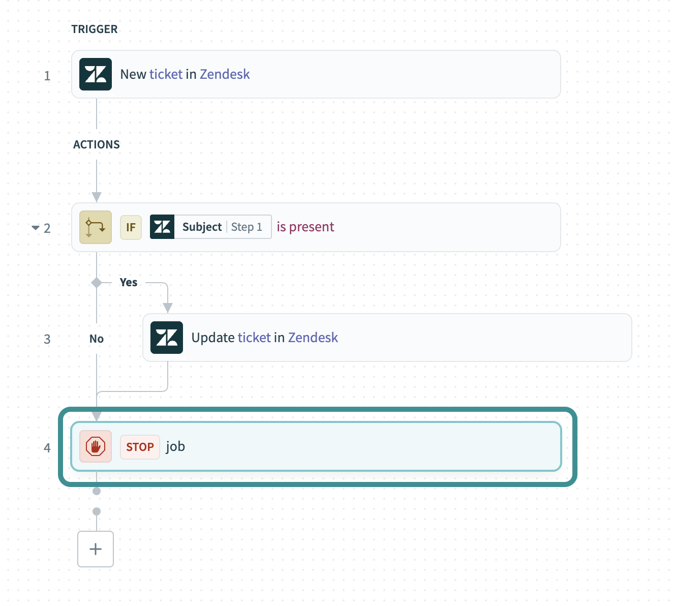

You can use an IF condition to validate inputs before you run further actions. This helps prevent failures caused by missing or invalid data.
The following example demonstrates how to check if a Zendesk ticket includes a subject before you update the ticket or add a comment:
Click + Add step, then select IF condition.
IF conditionIF condition
Map a datapill to Data field, such as the ticket Subject Step 1 datapill.
Set up IF conditionSet up IF condition
Choose the is present condition in the Condition field to ensure the field contains a value.
Add the Update ticket step to the Yes path. This ensures the update only runs when the subject exists.
Add a Stop job step to the No path to stop the recipe when the input is missing. This prevents unnecessary steps and surfaces the issue early. Refer to the Stop job section for details.
Add a stop job stepAdd a stop job step

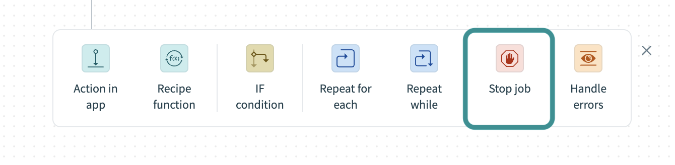

# Stop jobs
Use the Stop job step to end a recipe early when a condition for invalid data or a critical error is met. This action ends the job before it performs additional steps and displays the failure in the job report.
You can add the Stop job step inside a conditional branch to end the job when specific criteria are met, such as if a required field is empty or all retries fail.
