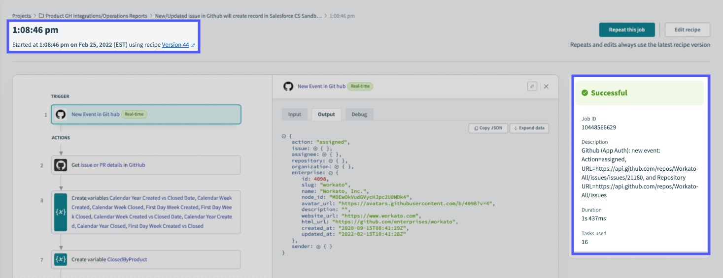

Job history summary
Job history summary data provides job metadata on the Job details page. This includes information about the job such as:
- The job ID
- Status
- Description
- Starting time
- Duration
Job history summary with successful job completion

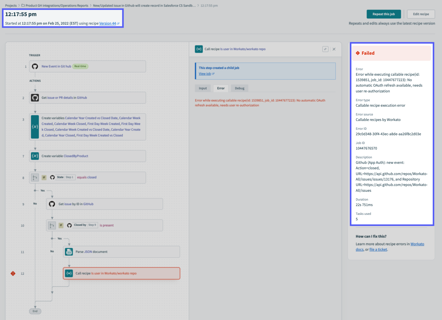

If the job resulted in an error, the summary would also contain details about the error:
Job history summary with error details

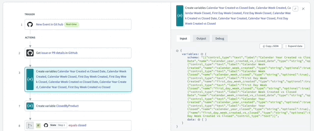

Job history details
Job history detail data provides information about inputs and outputs for each action in the recipe:
Action input and output on the Job history details page
After the data retention period has passed, only job history summary data is retained. Action input and output data will be deleted.

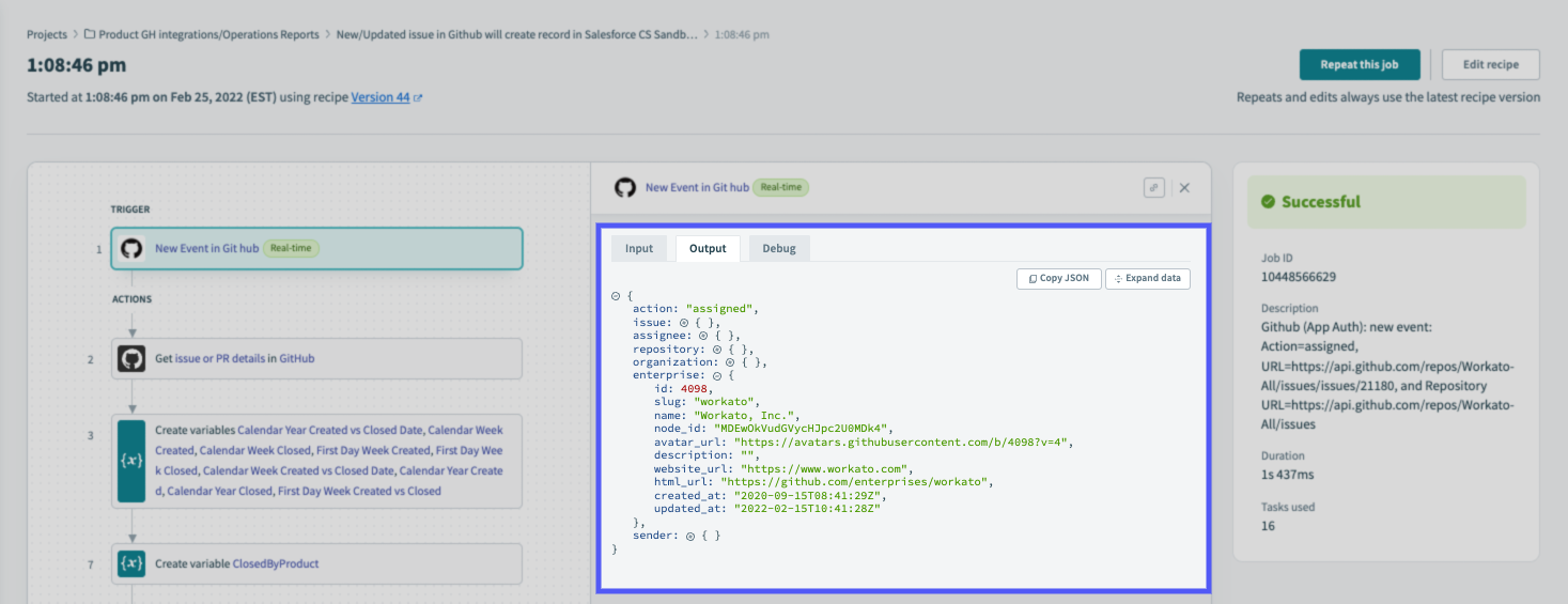

Trigger events
Trigger event data is found on the Job details page in the Output tab of the trigger step:
Trigger event data for a new issue in GitHub
Trigger event data can be used to repeat a job without creating a new trigger event. After the retention period has passed and the trigger event data is deleted, this page's Repeat this job option is deactivated.

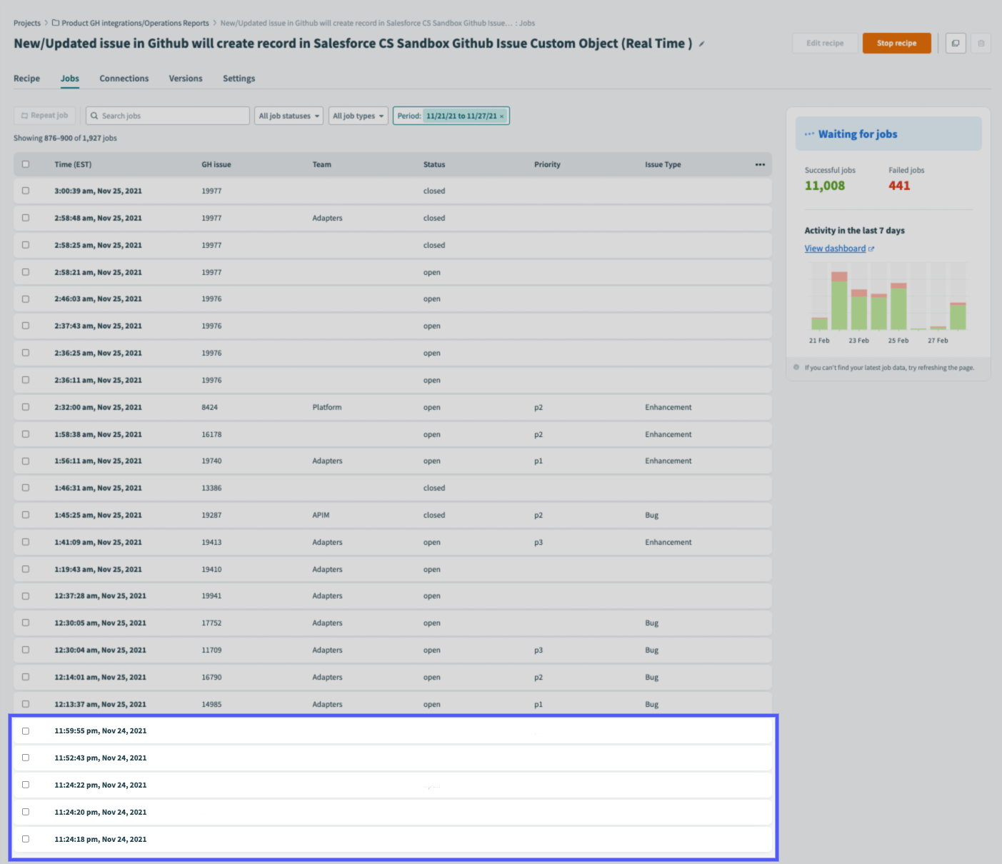

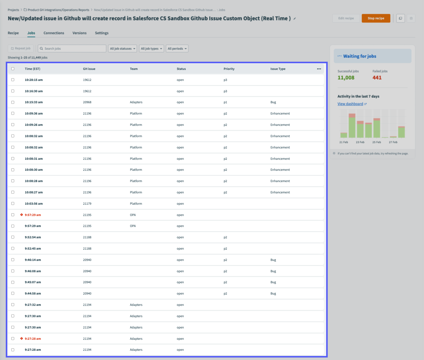

Customized job reports
Customized job reports are located in the Jobs tab of the recipe. If a job report isn't customized, only the job's ID, status, and timestamp will display in the table.
A customized report is a quick, easy way to see data from a job without opening the Job details page. In the image below, for example, the job report has been customized to include the GH issue, Team, Status, Priority, and Issue Type columns:
Custom job report showing data from the job execution
After the retention period, only the job's ID, status, and timestamp will display in the job report. Data in customized columns will be deleted.
Custom job report after the retention period has passed

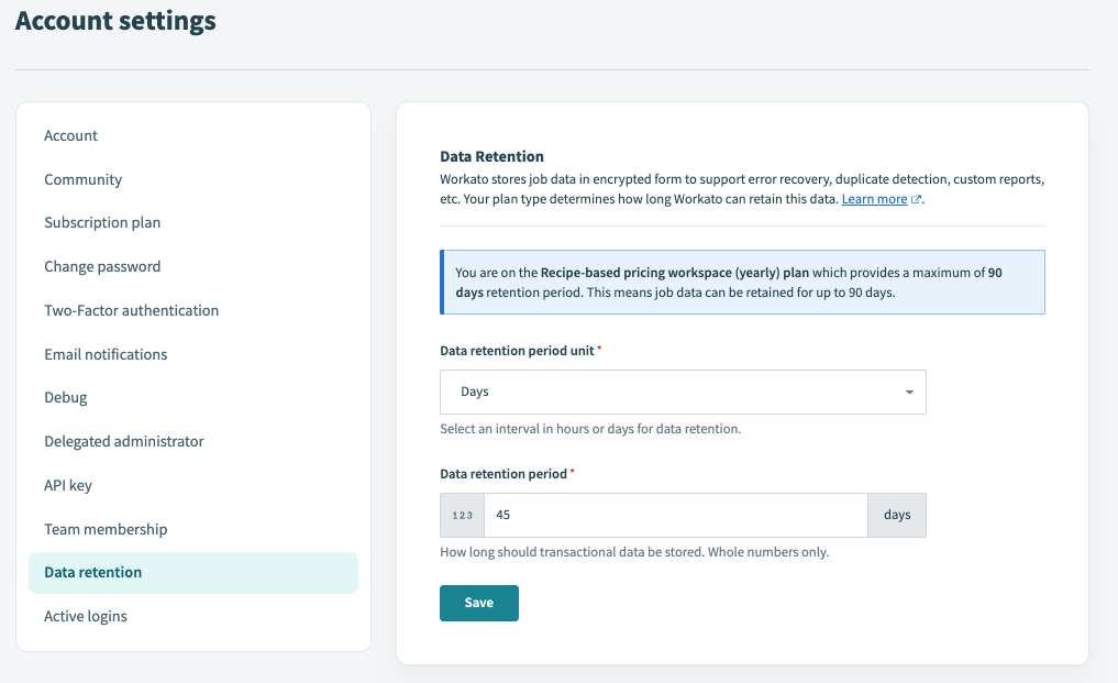

Customization at the workspace level
Sign in to your Workato account and go to Workspace admin > Settings > Data retention.
Go to the Data retention period unit field and select Hours or Days.
Go to the Data retention period field and enter an integer to specify the duration of the retention period based on the selected period unit.
For example, if the period unit is Days and you enter 45, the retention period will be 45 days from the job's completion date.
Customized data retention policy of 45 days from the job's completion date
RETENTION PERIOD
The retention period must be between one (1) hour and 90 days. If set to a value outside this range, Workato will reset it to the maximum for your workspace's plan type.
