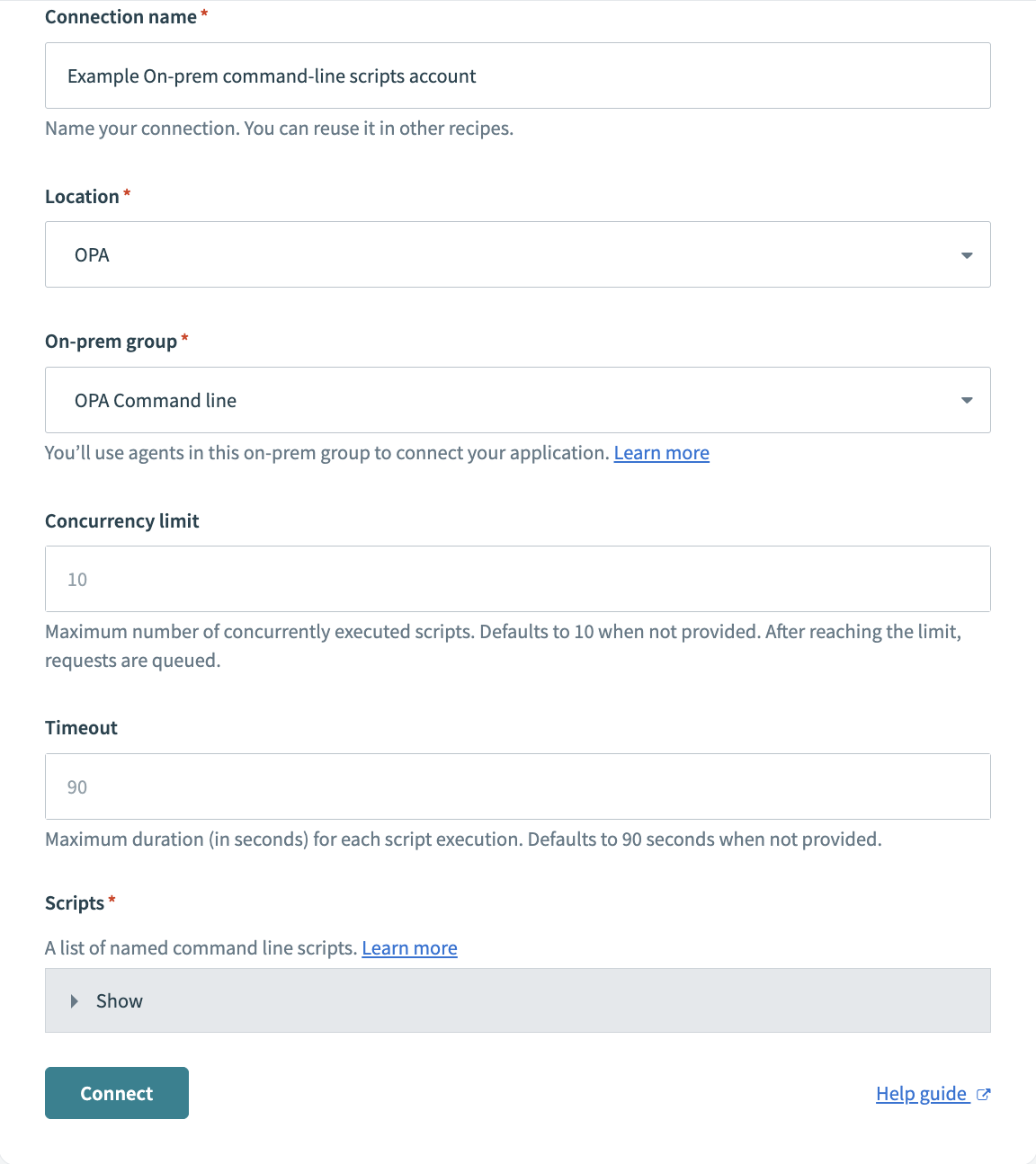

Search for and select On-prem command-line scripts on the New connection page.
On-prem files connection setup
Use the On-prem group drop-down menu to select the on-prem group you plan to use.
Enter a concurrency quota in the Concurrency limit field. Requests that exceed this quota are queued. Defaults to 10 if not specified.
Enter the number of seconds to allow each script to run before timing out in the Timeout field. Defaults to 90 if not specified. For agents versions 2.14.0 and later, you can also set the timeout in the Execute command-line script action.
Define the command-line scripts in the Scripts field. You can run these scripts through the on-prem agent using the Execute command-line script action.
Click Connect to complete the setup.

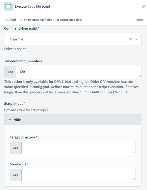

Input ​
Input fieldDescription
Command-line scriptSelect the script to run through the connected on-prem agent.
Timeout limit (minutes)Enter the number of minutes to allow the script to run before timing out. The maximum value is 1440 minutes (24 hours). Defaults to 2 minutes if not specified.
Only agent versions 2.14.0 and later are supported. Earlier versions use the timeout value specified in config.yml.
Run script in background?Optional. Select whether to proceed with the recipe without waiting for the script to complete.
In agents versions 2.14.0 and later, scripts that exceed 24 hours will timeout.
Define additional inputs

Workato displays these parameters as required values in the Script input section.
Parameters on Workato recipeInput parameters in the recipe
