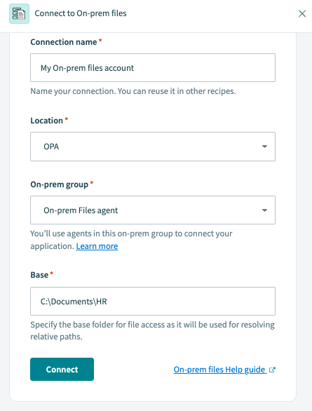

Click Create > Connection.
Search for and select On-prem files on the New connection page.
Provide a name for your connection in the Connection name field. On-prem files connectionOn-prem files connection using on-prem agent
Use the On-prem group drop-down menu to select the on-prem group you plan to use.
Specify the folder to use as the starting location for relative paths in the Base field.
Click Connect to complete the setup.
