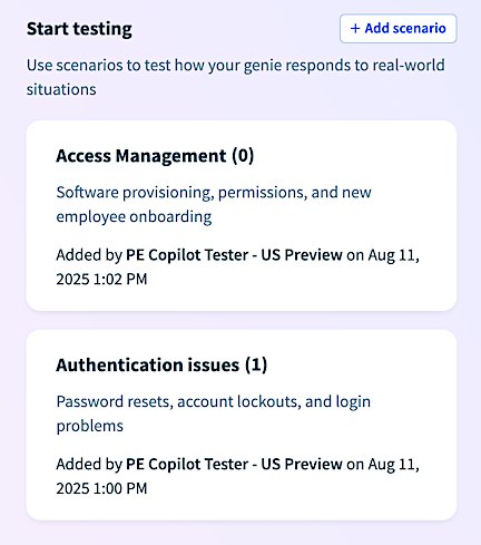

Go to the Start testing section and click + Add scenario.
Start testingStart testing section

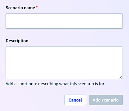

Provide a name and description for your scenario.
Add scenarioAdd scenario
Click Add scenario. The new scenario displays in the sidebar.

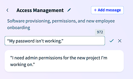

Click +Add message.
Enter a message you plan to add to the scenario.
Add messageEnter a message
Click the ✓ (checkmark) icon to save the message.
Select a message from the sample scenario message options. Your message is automatically logged and saved to the conversation history panel.
