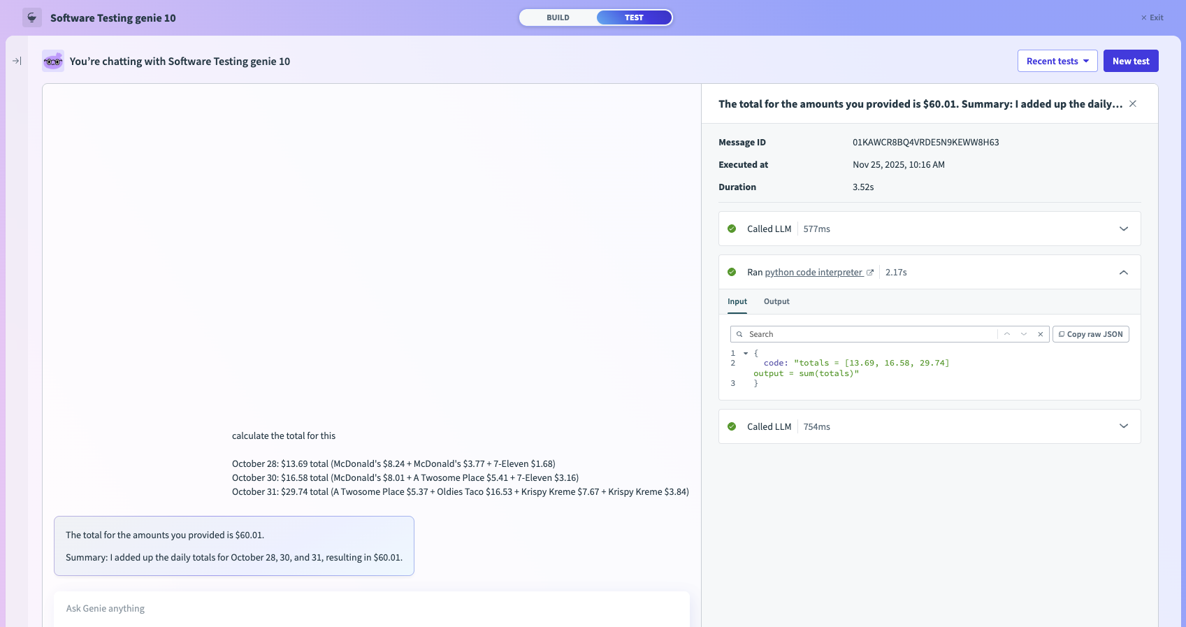

Provide your genie with a Python code execution skill to handle mathematical operations reliably. This solution uses the following workflow:
  • Genie identifies when mathematical calculations are needed
  • Genie calls the Python execution skill
  • Python performs the calculation with precision
  • Genie receives and uses the accurate result
Complete the following steps to use a Python code execution skill:
Import and enable the prebuilt Python execution skill (opens new window) for your genie.
Test the skill to ensure it performs as expected with your workflow.
Python code interpreterPython code interpreter
Adjust the prompt for your genie and skill as needed.
