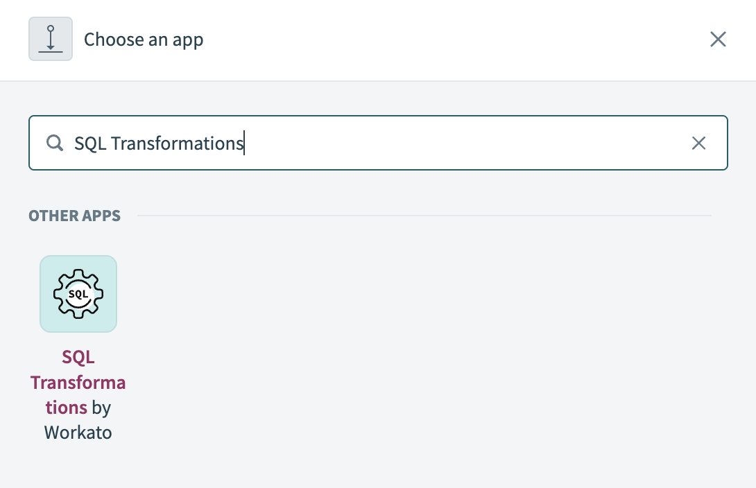

SQL Transformations utility connector SQL Transformations utility connector
