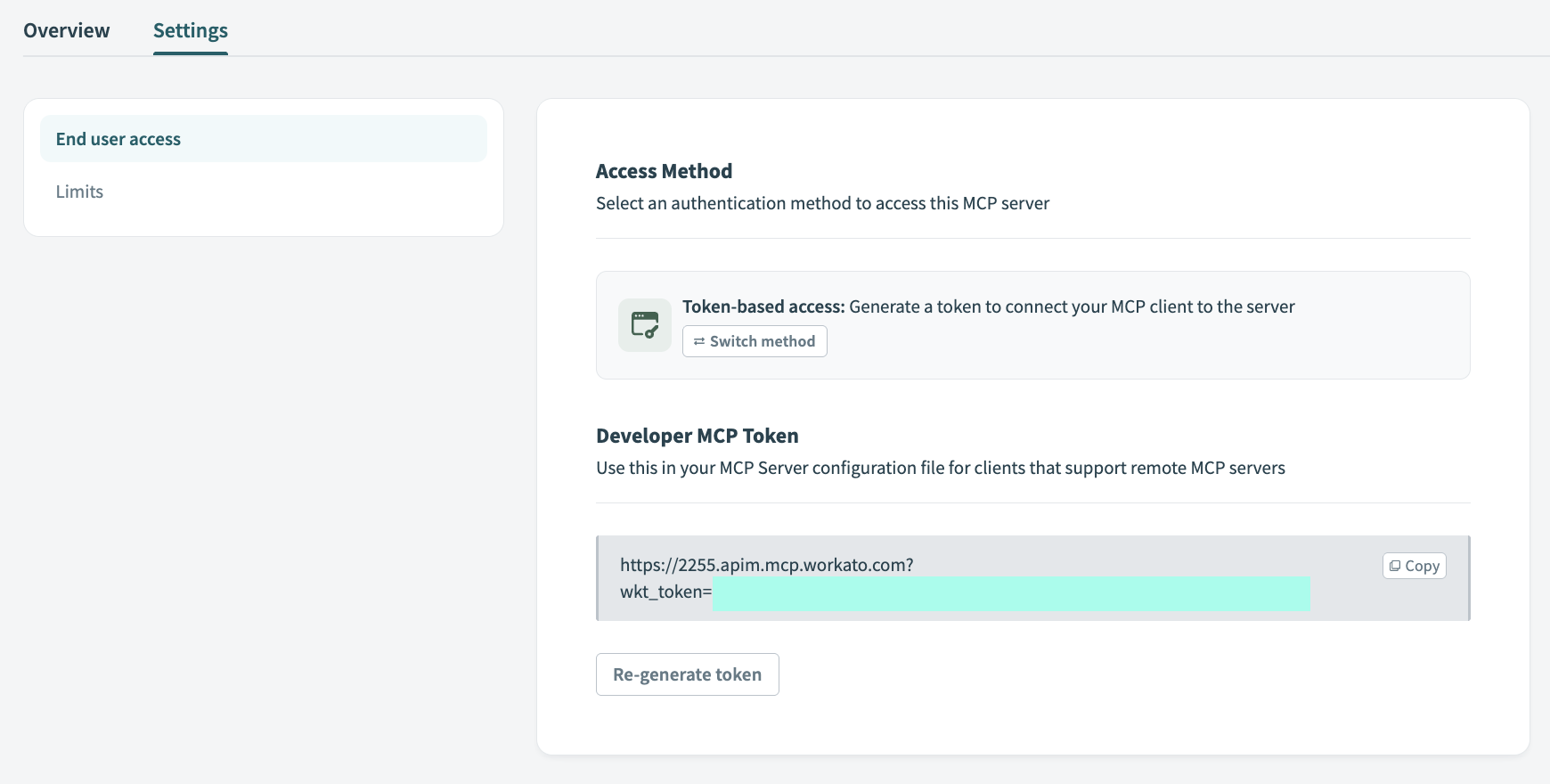

# Retrieve your remote MCP URL
You can access and manage your MCP servers and retrieve your MCP URL in the AI Hub.
Complete the following steps to retrieve your MCP URL:
Go to AI Hub and click the MCP Servers tab. A list of your existing MCP servers displays.
Click the MCP server card you plan to view. The MCP server displays the following information:
  • Description
  • Installation link
  • Tools available on the MCP server, such as Tasks Create and CRM Get Company Properties
  • The MCP remote URL
Click Settings > End user access.
Go to the Developer MCP Token section and click Copy.
Copy the MCP URLCopy the MCP URL
