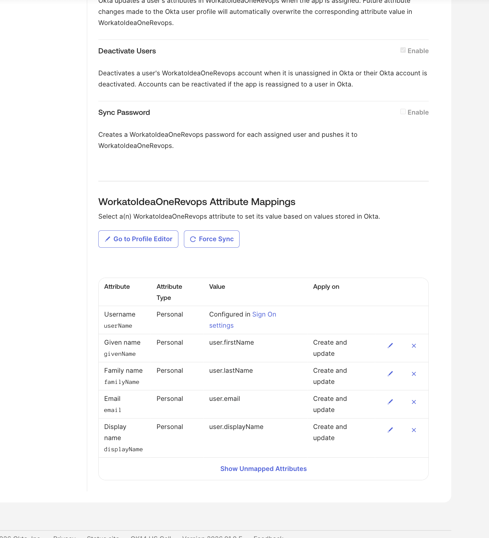

Go to Provisioning > To App > Attribute Mappings. SCIM provisioning setup in OktaSCIM provisioning setup in Okta
Use the following configuration:
Workato attribute Okta value Applies on
userName Configured in Sign On settings N/A
givenName user.firstName Create and update
familyName user.lastName Create and update
email user.email Create and update
displayName user.displayName Create and update
You don't need to create custom SCIM attributes for this step. These mappings define how Okta passes user profile values to Workato during provisioning.

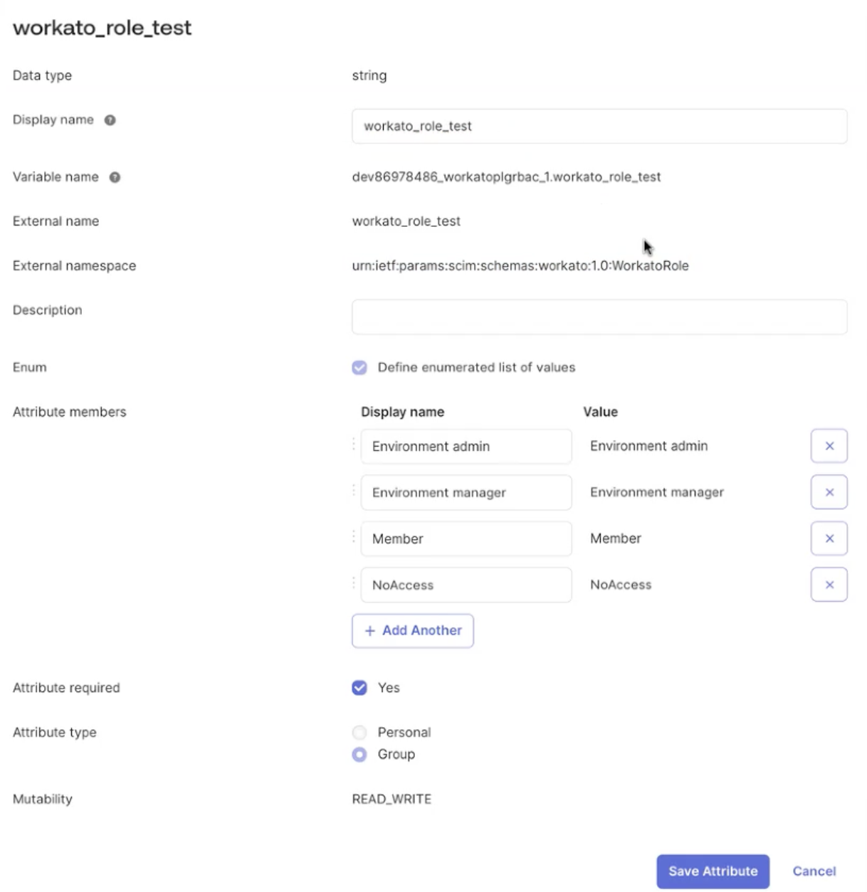

Go to Directory > Profile Editor > Workato App User Profile > + Add Attribute.
If your organization already has existing workato_role, workato_role_test, or workato_role_prod attributes from a previous configuration, edit them instead of creating new ones. Ensure that each includes the required External Namespace setting so Okta can continue to update these attributes through SCIM.
Set the following values for each environment role attribute you plan to provision through SCIM:
Field Value
Data type String
Display name workato_role (or environment-specific equivalent, for example workato_role_test, workato_role_prod)
Variable name Same as the display name
External name Same as the display name
External namespace urn:ietf:params:scim:schemas:workato:1.0:WorkatoRole
This ensures that Okta correctly passes these environment role attributes through SCIM.
Select the Define enumerated list of values checkbox and add your environment role values under Attribute members:
Display name Value
Environment admin Environment admin
Environment manager Environment manager
Member Member
NoAccess NoAccess
Values are case sensitive.
Click Save. Your configuration should resemble the following example:
