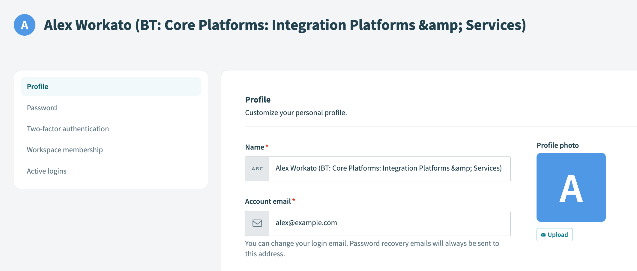

# Why is my profile name unexpectedly long?
When a user is provisioned in Workato through SCIM or Just-in-Time (JIT) provisioning, their account is created using the userName value provided by your identity provider. Workato then assigns a profile name using additional identity attributes.
If certain attributes are missing during provisioning, Workato may use displayName or userName as a fallback. These fields can include additional context such as job title or department, which may lead to unusually long profile names:
SCIM long profile names
# Why this matters
- A long profile name can cause issues when accessing features like Workato Academy, which enforce limits on name length.
 - Profile names aren't updated automatically after initial provisioning, even if SCIM mappings change.
# How to resolve this
- Update your profile name manually in Profile settings in Workato.
 - Check how your identity provider is sending name attributes during SCIM provisioning. Using broad fields like
displayNamecan result in long names that may cause issues in the future. - If needed, adjust your attribute mappings to send more concise values when users are provisioned.
