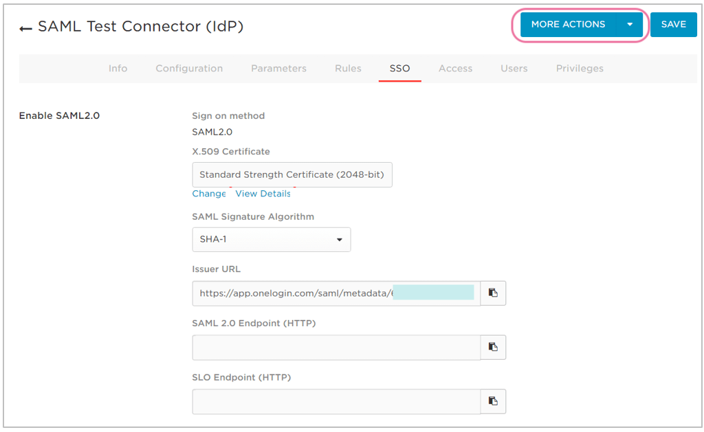

Click More Actions.
Click More Actions
Right-click SAML Metadata and select Copy link address.
Paste the SAML Metadata link address into the Do you have your identity provider metadata URL? section of the Set up a new provider modal in Workato Identity.
