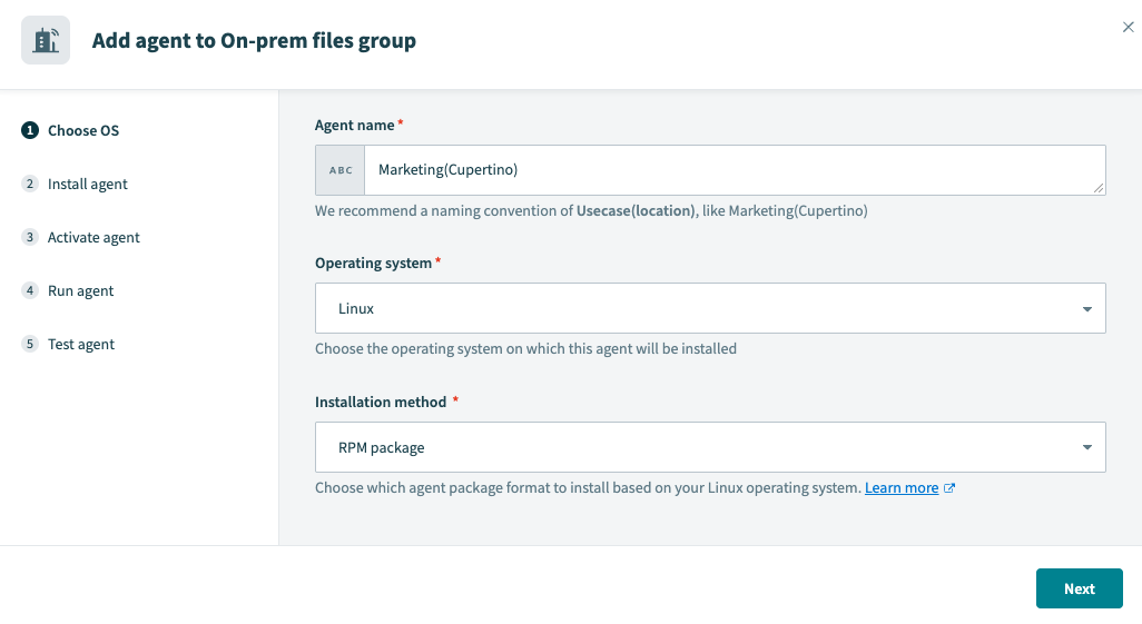

Go to the On-prem groups page and click Add new agent. Provide a meaningful agent name, and select the operating system (OS) for the agent installation.
Choose OS Choose OS

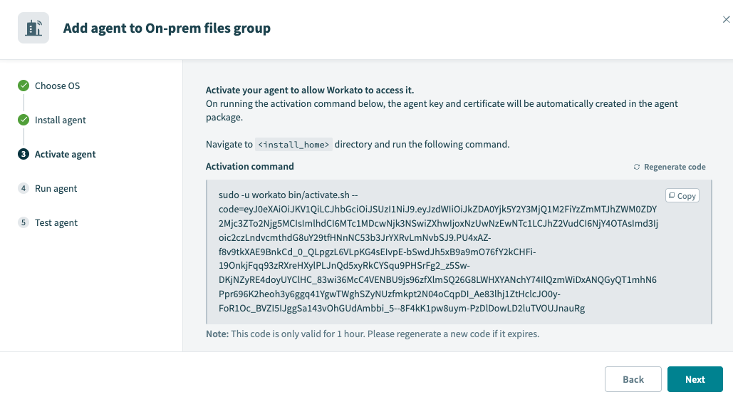

On running the activation command below, the agent key and certificate will be automatically created in the agent package. The activation code is valid for one hour.
ALLOW TRAFFIC TO WORKATO FROM YOUR SERVER
Ensure traffic to Workato is allowed from your server to use OPA. Refer to security allowlists to add Workato to your allowlist.
Navigate to <install_home> directory, copy and run the following command from the wizard.
AGENT ACTIVATION USING A PROXY
You must add the --proxy-host=<host-ip-address> and --proxy-port=<port number> parameters to the Activation command if you're using a proxy. Refer to the Set up proxy access for your on-prem agent guide for more information.
Run the activate script with the --help parameter to display the list of accepted input properties.
Activate Activate

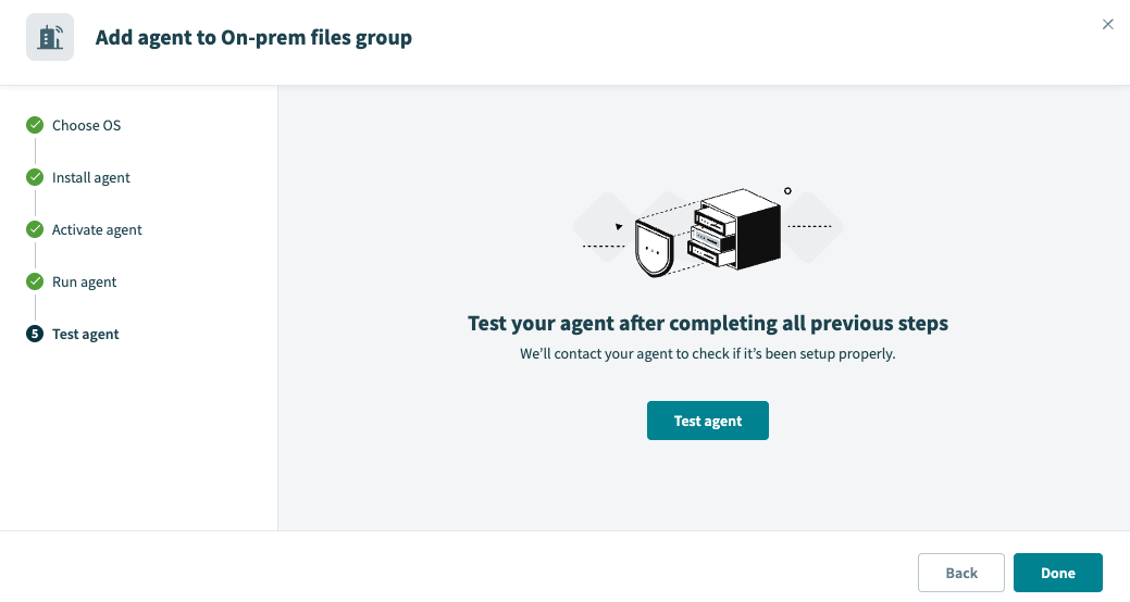

Open the agent wizard in Workato by clicking Setup Now, and advance to the Test agent step to check if agent can connect to Workato:
test
