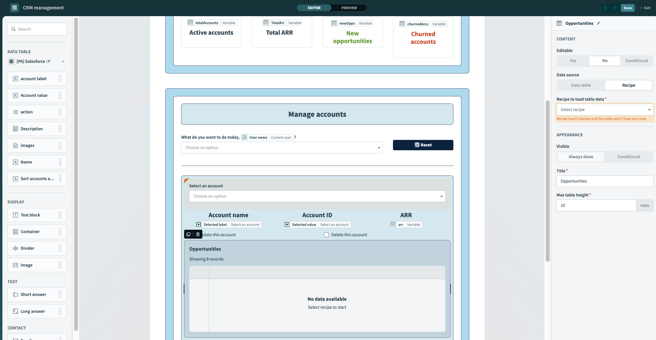

Add a Table component to your page and select Recipe as the data source.
Select recipe as the data sourceSelect recipe as the data source
If existing recipes in your Workflow apps project contain the New component event (Drop-down) trigger, Workato displays them here. Otherwise, click Create recipe.

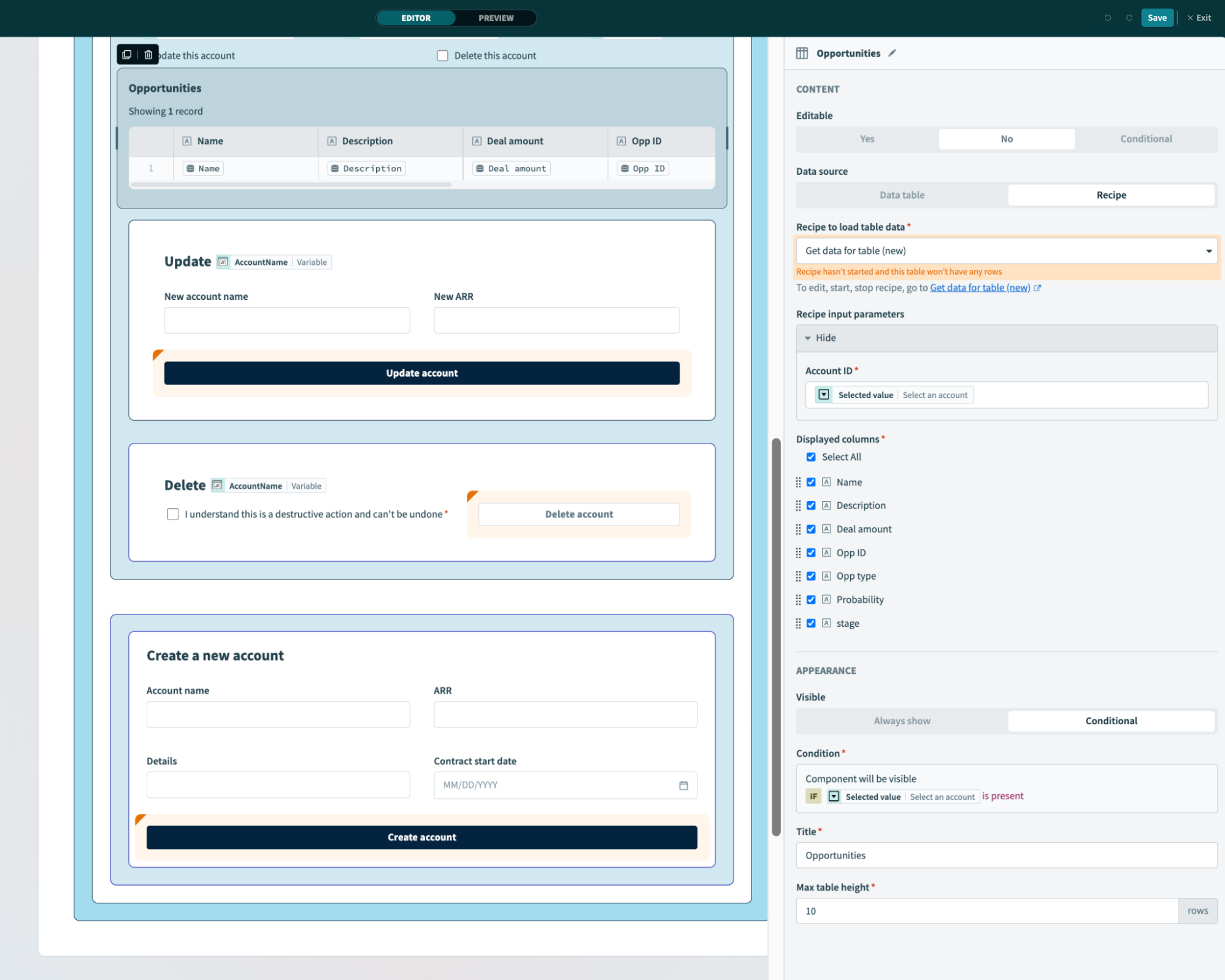

Complete the following steps to configure your recipe as a data source for table components in the page editor:
Click the Data table component to select it.
Go to the Properties panel.
Use the Recipe input parameters section to set up an input parameter for use in the Get data for table recipe created in the previous step:
  • Map the Selected value | Select an account page component datapill into the Account ID field.
Use the Displayed columns menu to select the columns you plan to display on your page.
Configure component visibility
Complete the following steps to configure this component to be visible only after a user selects an account:
Go to the Appearance section.
Click Conditional.
Map in the Selected label | Select an account datapill to the Data field.
Use the Condition drop-down menu to select Is present.
Type Opportunities into the Title field.
Enter 10 into the  Max table height field.
Click Save.
Your configuration should look as follows:
Component configurationComponent configuration
