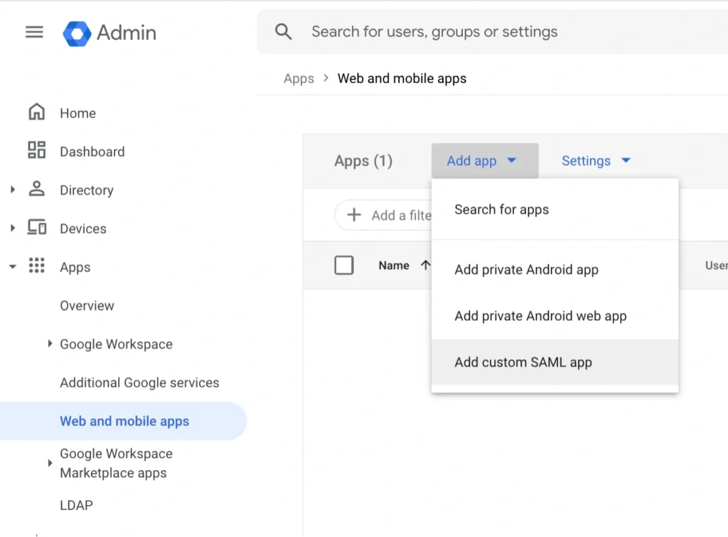

Sign in to your Google Admin console (opens new window). You must be signed in as a super administrator.
Go to Apps > Web and mobile apps.
Click Add App > Add custom SAML app.
Click Add App > Add custom SAML appClick Add App > Add custom SAML app.
