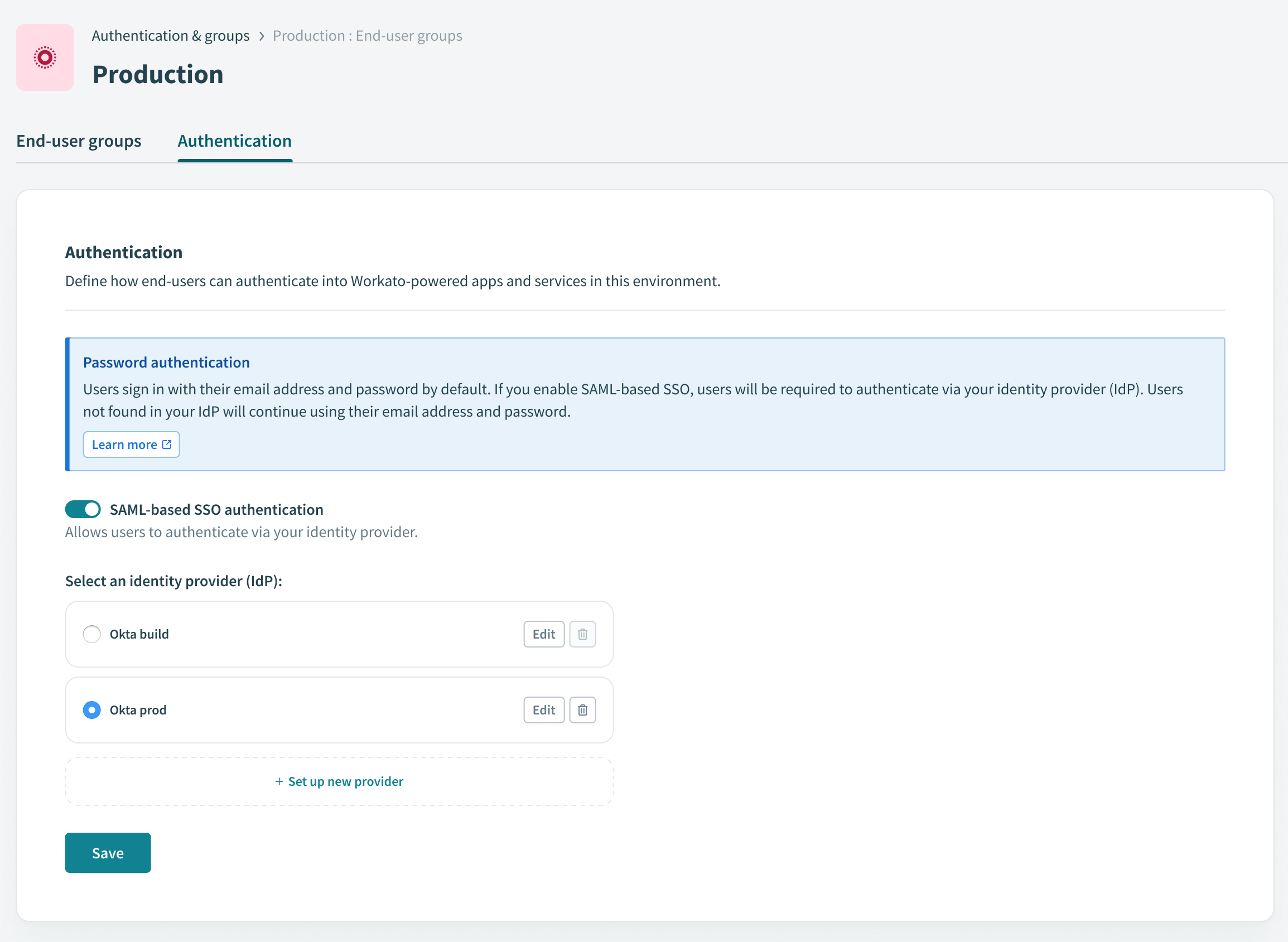

Select the Authentication tab.
Ensure that the SAML-based SSO authentication toggle is enabled.
SAML toggleEnsure the SAML-based SSO authentication toggle is enabled

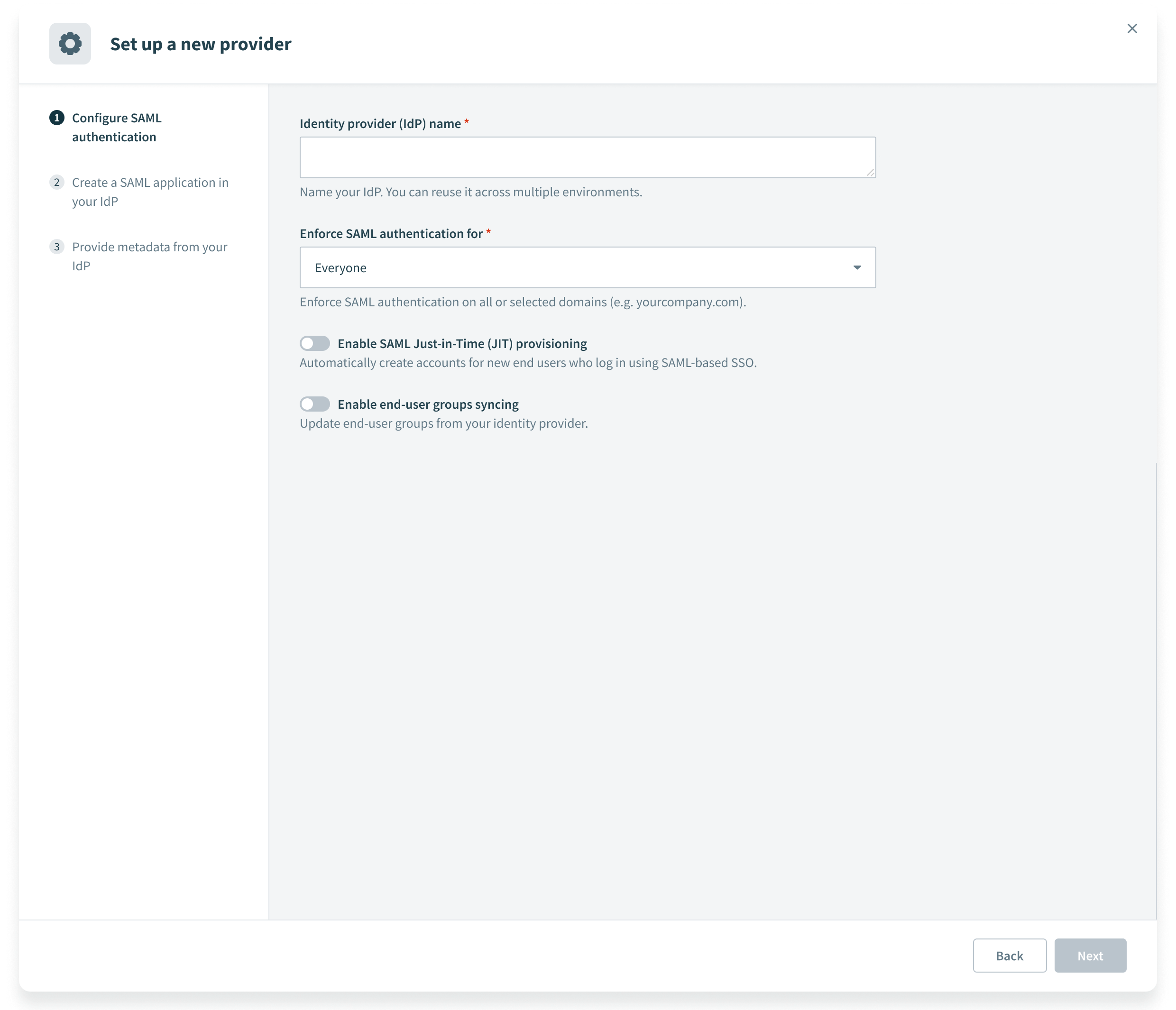

Go to the Select an identity provider (IdP) section and click + Set up new provider.
Provide a name for your IdP in the Identity provider (IdP) name field. For example: Okta Prod.
Configure SAML authenticatioConfigure SAML authentication
Use the Enforce SAML authentication for drop-down menu to select who is required to use SAML-based authentication.
Click the Enable SAML Just-in-Time (JIT) provisioning toggle if you plan to automatically create accounts for new users who sign in using SAML-based SSO.
AUTOMATED ACCOUNT ENVIRONMENT ACCESS
User accounts are created with access to the environments you selected in the preceding steps by default.
Click the Enable user groups syncing toggle if you plan to update user groups from your identity provider. Refer to Enforce SAML-based SSO authentication for Okta for more information.
USER GROUP SYNCING ONLY SUPPORTED BY WORKATO GO
User group syncing is only available in Workato GO. The sync process triggers when users log in. Slack and Microsoft Teams users remain authenticated through their platform sessions without re-login prompts, preventing the user group sync from triggering.

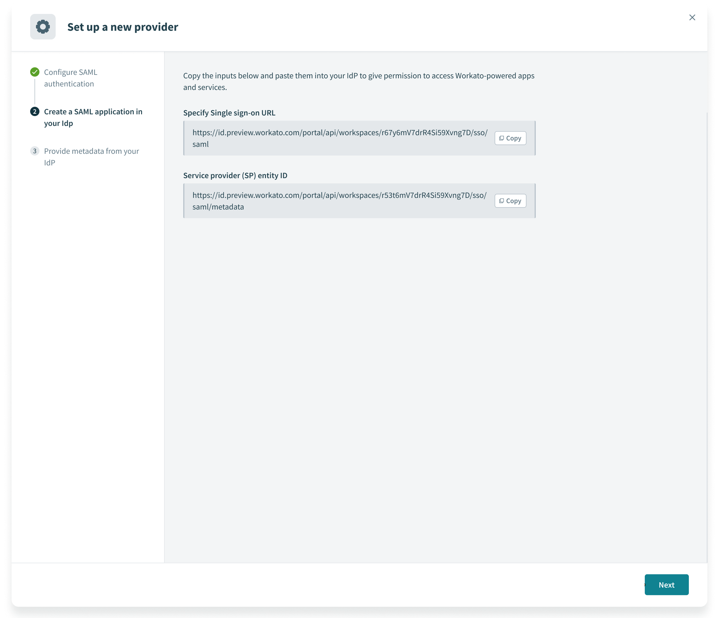

Copy the Specify Single sign-on URL and Service provider (SP) entity ID values and paste each value into your IdP to enable access to Workato-powered apps and services.
Copy the Specify Single sign-on URL and Service provider (SP) entity ID valuesCopy the Specify Single sign-on URL and Service provider (SP) entity ID values
