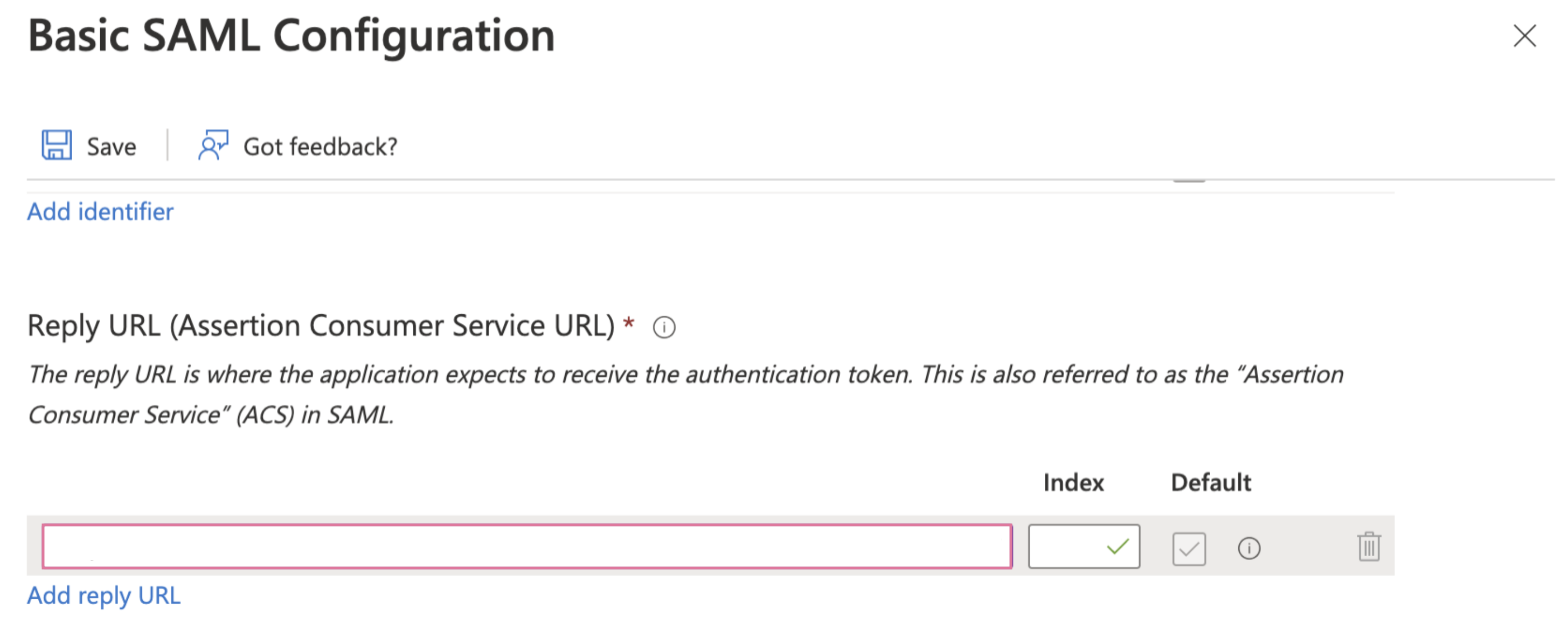

Go to the Basic SAML Configuration section and click Edit.
Paste the Service provider (SP) entity ID from Workato into the Identifier (Entity ID) field.
Paste the Single sign-on URL from Workato into the Reply URL (Assertion Consumer Service URL) field.
Click Save.

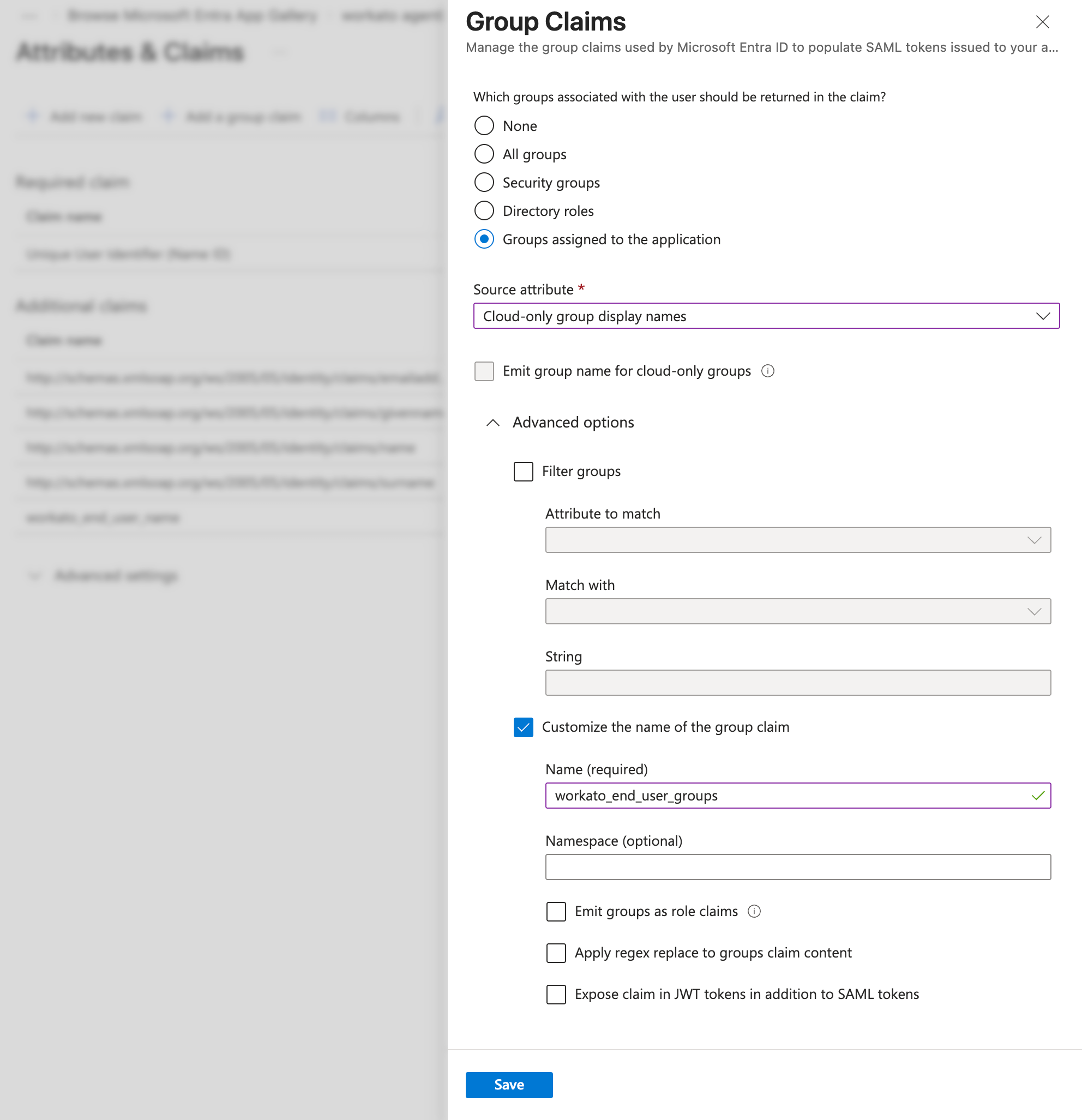

Click + Add a group claim and configure the following settings:
| Setting | Value |
| Which groups should be returned in the claim? | Groups assigned to the application |
| Source attribute | Cloud-only group display names |
| Customize the name of the group claim | Enabled |
| Name | workato_end_user_groups |
| Namespace | Leave empty |
Configure the group claims settings in Microsoft Entra ID
Click Save.
